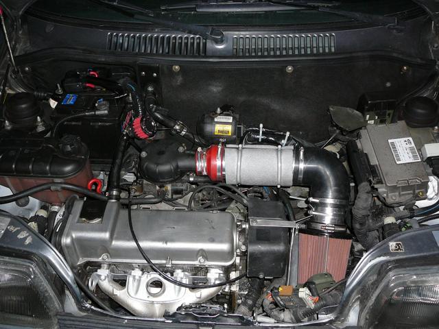

Polish alu+rubber intake kit (http://www.pk-tuning.pl/) with 899's TB(winter setup on this picture), simota breather filter(http://www.simota.com/) and italian sprintfilter 75.4 Supercompetition(polyester)(http://www.sprintfilter.com)
More mods will come mostly mechanical, also better pictures(waiting for sunny weekend).

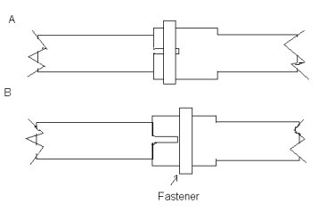

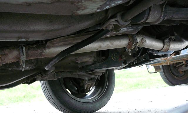

mod is fine, but noticed some leaking from where the exhaust pipes are connected together-not too much but you can feel some "wind" when you get closely with your hand and also hear it when you seal tailpipe-have new pipe fasteners, and dont know how to make it perfect
whats better place for fastener??or clamp if u want
A
Make sure to use some exhaust sealing paste too, before you tighten the clamp up

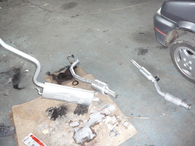

a silencer thats round and straight-thru, with minimal sound-deadening
this is not "cherry bomb" but its sporting backbox with all fibre out-extra levemir "improvement" :D
maybe it could be better just to remove cat without "improving" of backbox-now its really loud-iam thinking of puting cat back :(
