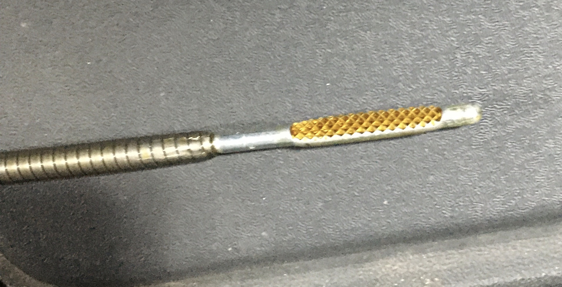

I been changing the oil/oil filter of my Fiat 500 for years now
But it just occured to me
(with photo enclosed) is the oil filled to the maximum when the dipstick shows what it shows in photo
For some reason I am questioning myself in my old age?
Strange but true!

Yes, it's full, about 2.7 litres when the flat area is showing oil....best way I could say that.....
A check at least monthly is a good idea, let it settle after a drive for accurate result.
So about 3 qts to be more precise 2.85 qts
