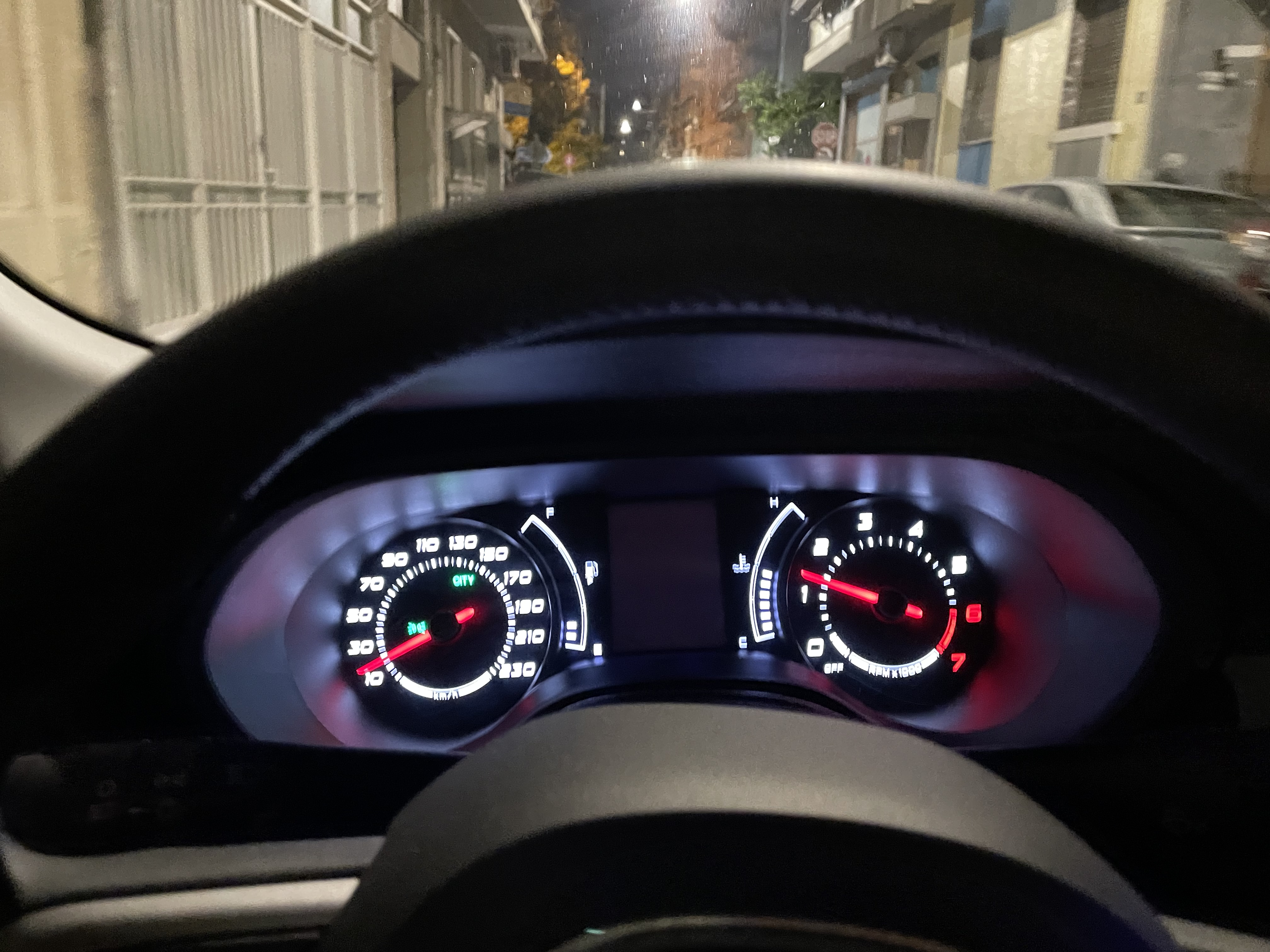

I am having the same problem right now. On Thursday I’m going to take my tipo to the service point to check what is going on.
  • IMG_1648.MOV
    56.3 MB

Today I had my tipo display checked for the referred problem and got informed that it may be a factory problem and ordered a new km display. I won’t pay anything because of the warranty. 😁
It seems that the km display is defected so the Fiat dealer had to order one brand new under warranty from Fiat Turin factory. 45 days for delivery 😬🤦🏻‍♂️
