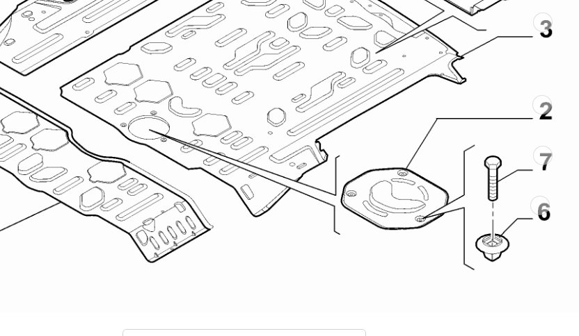

Hello I am going to install a Chinese diesel heater in the van I'm in two minds to get a separate fuel tank or use the main one. Does the 2019 version have a hatch inside the van to get to the sender unit., and what are the pros and cons of tapping into the sense unit any advice will be appreciated thanks

I'm almost certain mine does when I lifted the wood floor, I'm sure I seen it. like the pic below
