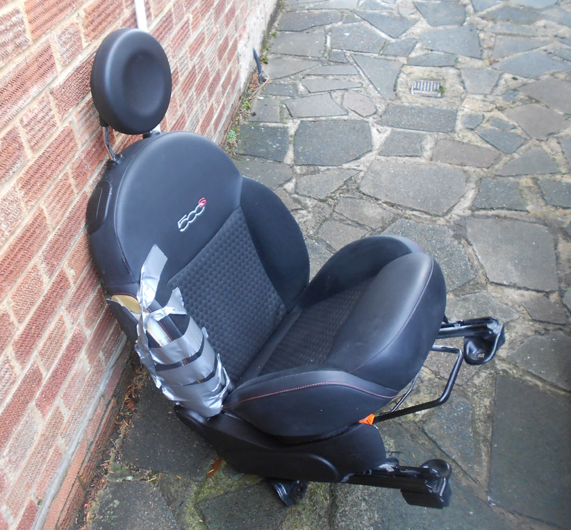

Bought a full set of front seats and seat backs for the back (not that I need those), exactly the same as what's in the car, so I've just valeted them and they have come up like new. They are now drying in my conservatory.
Changed the drivers seat today for the newly cleaned ones that I got yesterday. Two electrical connectors underneath at the front and 4 Allen bolts to undo. It's so nice and to see a complete seat.
