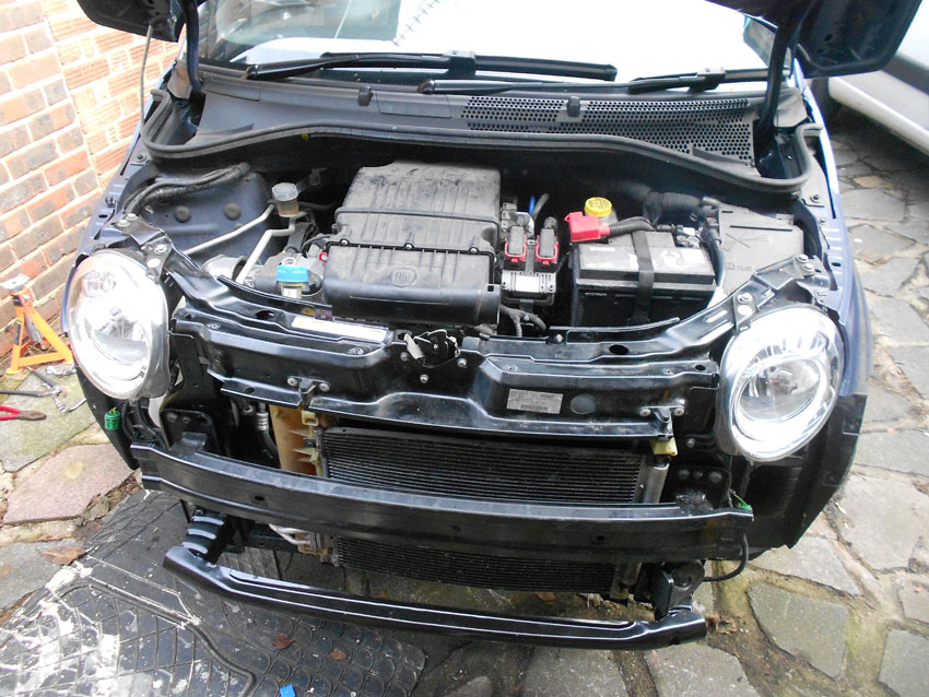

Horrible weather yesterday but I got a fair bit done which was no mean feat on my own. A slam panel/radiator/fan etc are difficult to manipulate on your own.

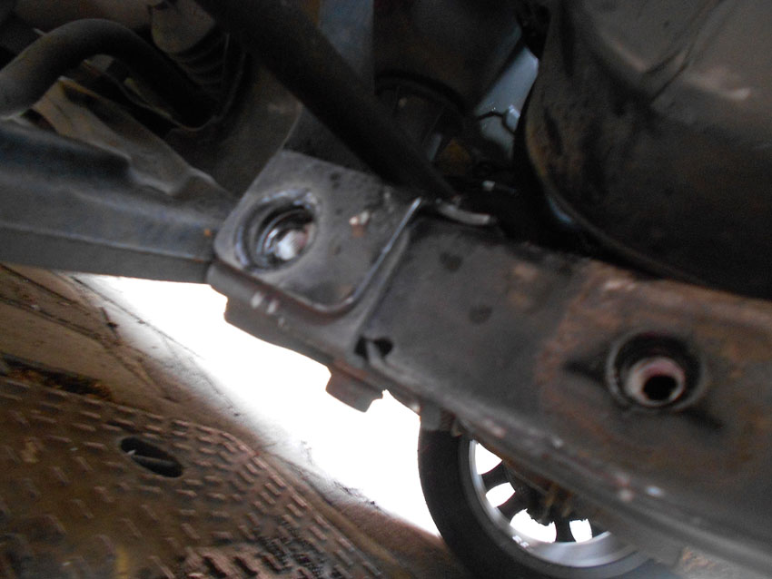

Fitted the new slam panel along with the new chassis extension leg and both top and bottom reinforcement bars. Twas a tricky job, but it's all done now.

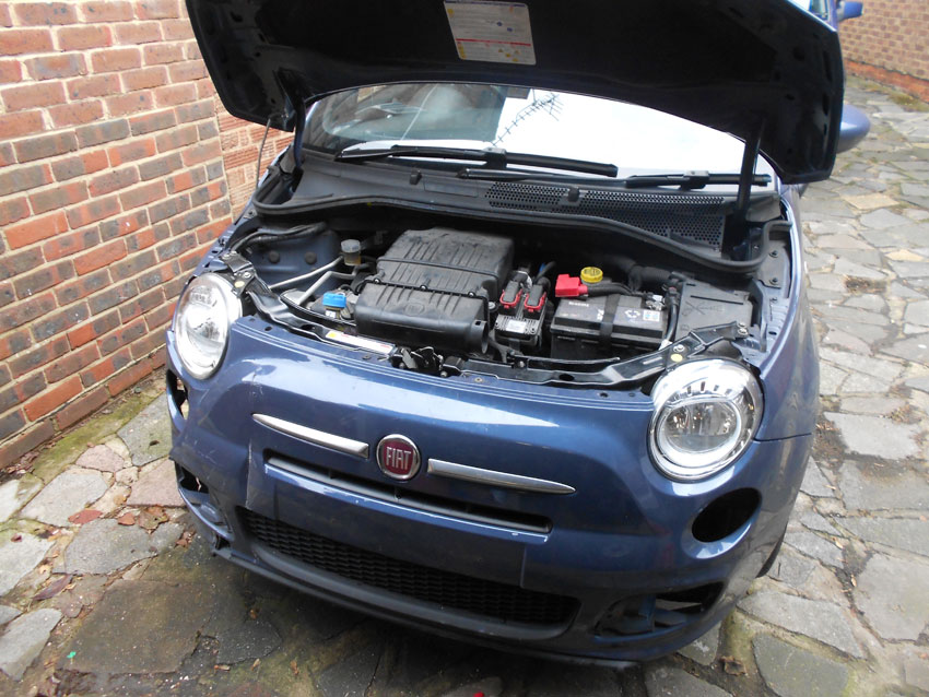

I've put the old bumper back on for now, as I am having trouble sourcing a new one. There doesn't seem to be any pattern parts available and the second hand ones are few and far between, but I shall perservere.

Below 3 photos. One of the chassis extension arm unbolted ready to pull out and 2 of the new bits fitted and the old bumper back on.

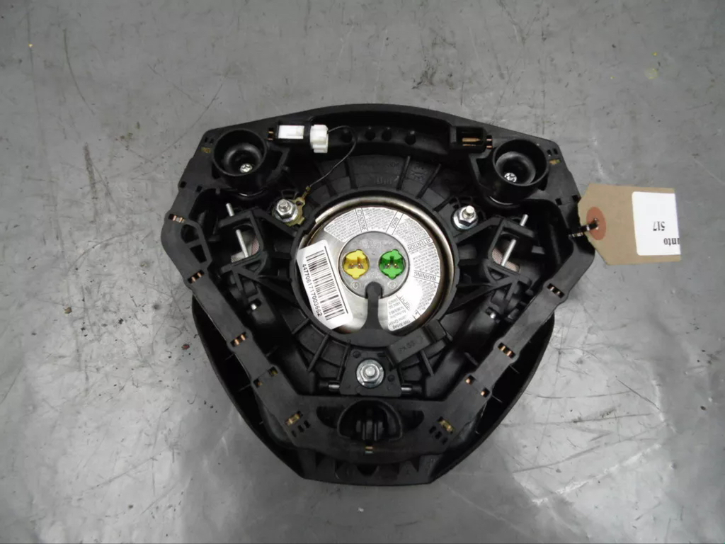

I think you're right to question it, I was thinking about it after I posted that above and seem to think I looked into it when changing the steering wheel on my grande.
Basically I think the answer is some are dual stage, I found this one on eBay and note the two connections
Not overly sure what the point is on a punto, more useful on a more intelligent car which monitors things like seat and driver positions like the ford IPS system. I think on the grande, how hard you hit something depends on how much the airbag explodes in your face

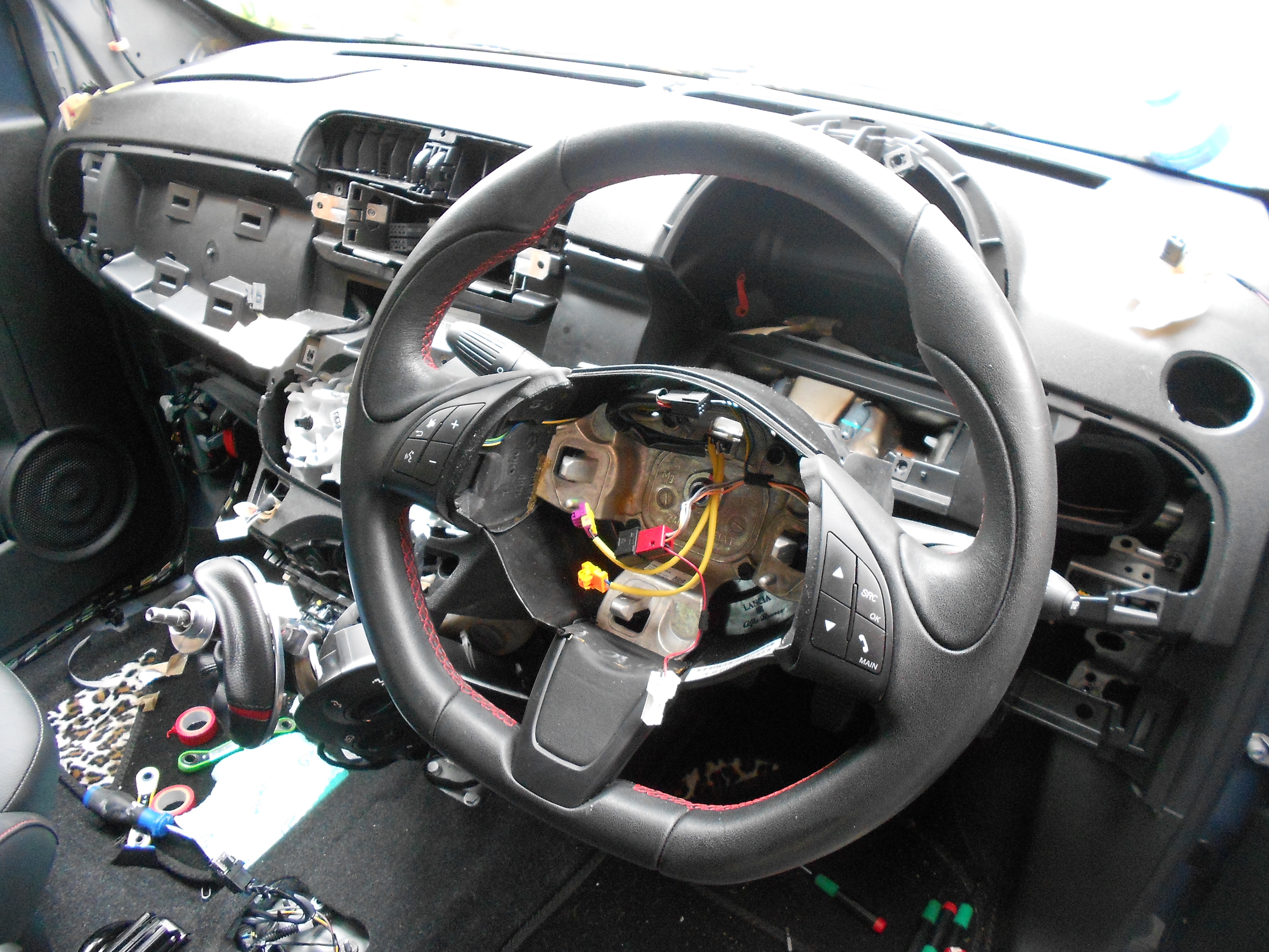

Attacked the dash today. I had a bit of a nightmare getting the old drivers airbag out. I eventually did it from around the outside of the old airbag itself rather than from the cowling. I just couldn't figure out how the hell I was supposed to do that.
The Haynes manual and videos on youtube were different, so I guess the USA version (the youtube video) and the older cars are easier to work on the airbag. This car is 2013 S, so it's obviously different. Wasted a good couple of hours with this.
See the picture for how the car is at the moment. I didn't have a long enough reach socket for the final bolt or a 24mm socket for the steering wheel, so I had to give up.
Everything else is removed and unbolted. Labels have been put onto the cables. Screws have either be put into envelopes marked with what they are or taped to the back of trim, so hopefully it will all go back together OK.
Need to get a new socket set tomorrow, then try and get it finished on Sunday.
