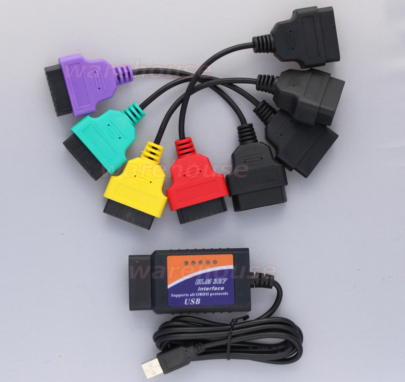

Thank you guys for the replies, unfortunately i live near Penzance so quite a way from most people. I will take on board your suggestions, i downloaded and had a look at multiecuscan software which looks quite good. I have a 2011 Fiorino 1.3D multijet, is this the sort of adapter i should be looking for? s-l1600.jpg

hi, that's ONE of the kits - YES, (y)
do check the supported vehicle list.. ;)
it'll advise which cables are needed to "speak" to which systems of the vehicle,
Charlie

Yes that is a typical set of leads For your 1.3D you need a ELM327 to USB interface and the Yellow (No.3) adaptor. An ebay seller I'e used has these as items 301231120324 and
281563281937.
The free version of Multiecuscan supports very little on your car, just CAN info, but you can test it works before paying the registation fee.
Robert G8RPI.
