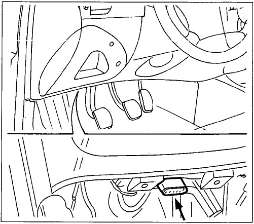

J jk3824 New member Joined Mar 14, 2009 Messages 2 Points 1 Mar 14, 2009 #1 O.K. I give up. Can anyone tell me where to find the diagnostic socket on a x (2000) reg mearea 1600. I have been behind and under dash but cannot discover it? Last edited by a moderator: Mar 16, 2009

Davren Moderator Staff member Uploaded 10+ resources/downloads Joined Jul 6, 2008 Messages 16,433 Points 3,937 Location London, UK. Mar 14, 2009 #2 This is from the 2000 range 1596cc Marea workshop manual. Dave. Attachments Marea ALDL.jpg 69.2 KB · Views: 264
OP OP J jk3824 New member Joined Mar 14, 2009 Messages 2 Points 1 Mar 14, 2009 #3 Cheers Dave. Have the manual and the picture seems to bear no resemblance to position, unless it's heavily disguised as a fuse board.
Davren Moderator Staff member Uploaded 10+ resources/downloads Joined Jul 6, 2008 Messages 16,433 Points 3,937 Location London, UK. Mar 14, 2009 #4 Manual shows left hand drive version, perhaps it's on the opposite side. Dave.
johnson550 Fiats since 1973 Parked in the garage Joined May 15, 2006 Messages 1,362 Points 336 Location North East Mar 14, 2009 #5 it is where the diagram says apart from being the other side it has a cover over it to keep it from getting stuff in.
