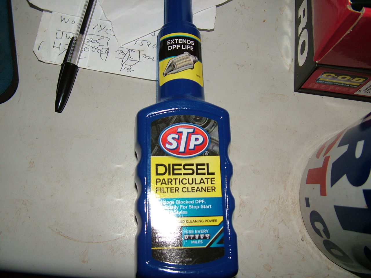

My suggestion would be put a bottle of DPF additive in at next fuel tank refill,then with engine fully warmed up do a 30 mile trip on dual carriageway at around 50 -60 mph without stops if possible and in a gear that keeps the engine revs at between 2000 and 3000rpm.
After that, see how it behaves and if DPF particle count still high then it may be a more expensive fix, but try this first, as it has worked for many modern small diesels that are generally only used at slow speeds around town which is no good for them.
Note if your engine coolant temp doesn't reach normal(90degrees) quickly then this will aggravate the issue.
Also, if it does sort the problem you will have to repeat every few months or change your driving habits, as in faster longer journeys.
Let us know how you get on.:)

Spanish Doblo 1.3mj on Forum driven by older guy I suggested it to with success as he reported back, also apart from others, my own daughters 2010 VW Golf 1.6 diesel ( I also had to fit a new thermostat and keep advising her to use the additive on fill ups of fuel) So far no further problem.:)
Small diesels with DPF really hate town use and clog up quickly.

Great. 1 bottle per deposit?
Instructions on the bottle, but for your problem use whole bottle in before filling the fuel tank, if successful then a reduced amount when filling tank.
Note if you try and do the cleaning operation with a low fuel in tank it will not work as computer will stop the cleaning process!
It is well worth trying as per my instructions and a lot cheaper if it works than a new DPF etc.:(
What you are trying to do is get the exhaust hot enough to clean it's self, something pottering around town will not do!
