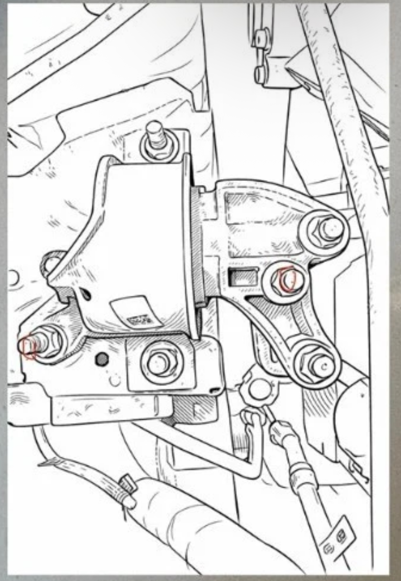

Also, just to add - I changed the earth strap using an eBay part but did not mess with the strap under the battery tray.

It is the bit under the battery tray between the chassis and the gearbox that corrodes
So that is an area you need to check / replace while your in there
It is not a big job but one worth doing to rule it out
