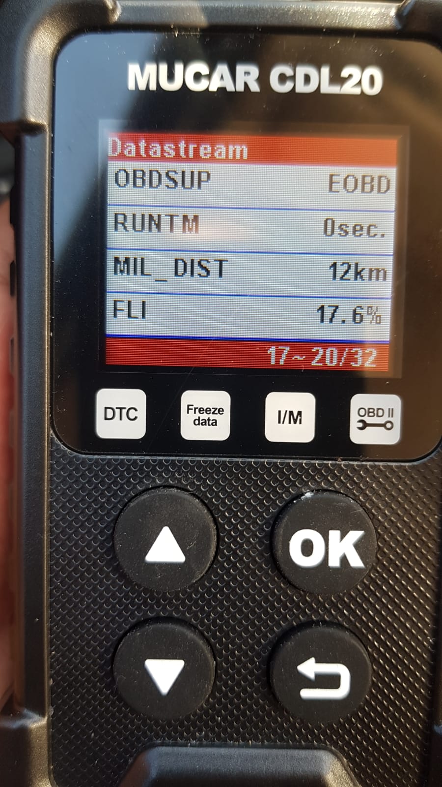

Hi everyone. New here. 2014 Fiat 500 1.2 Liter.
Engine won't start. (it did start twice but choked very quickly)
Connected a car computer (which my nice neighbor had).

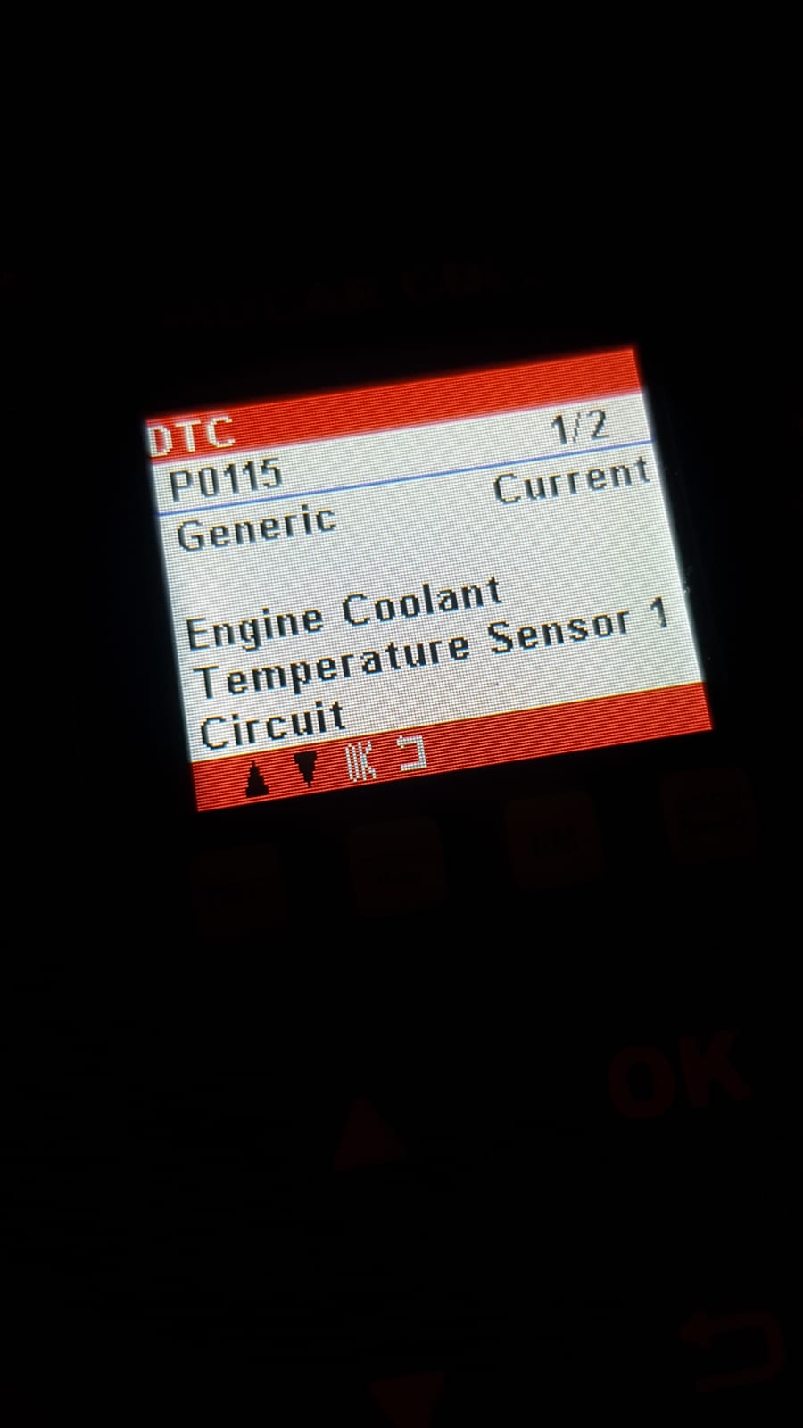

Showing this code:
P0115
engine coolant temperature sensor 1 circuit

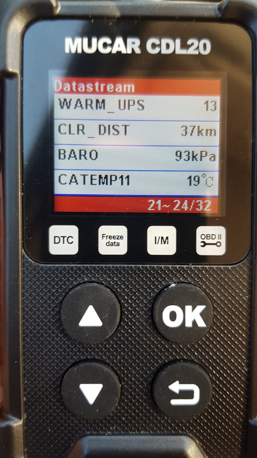

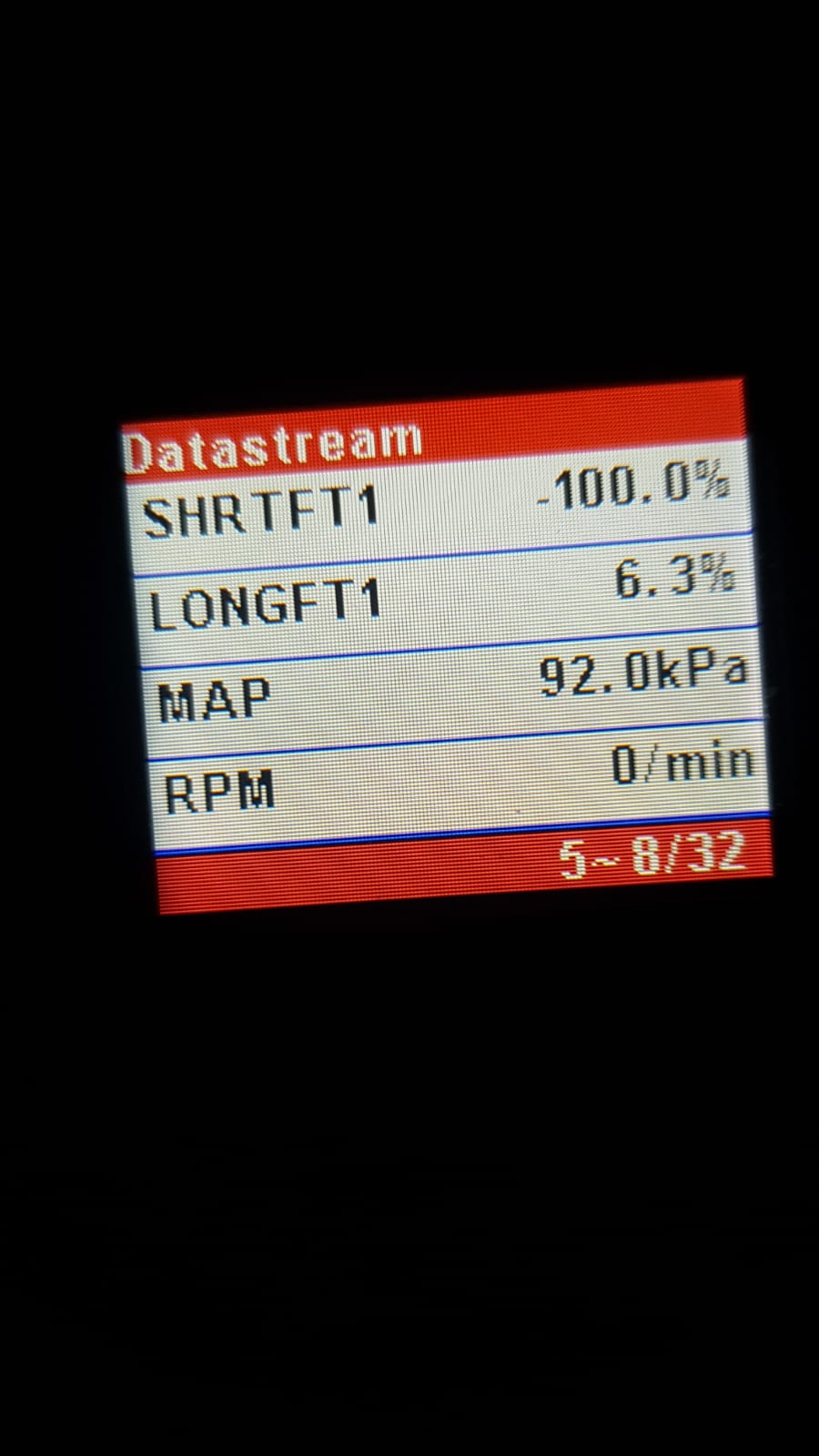

I also checked DATA STREAM on computer:

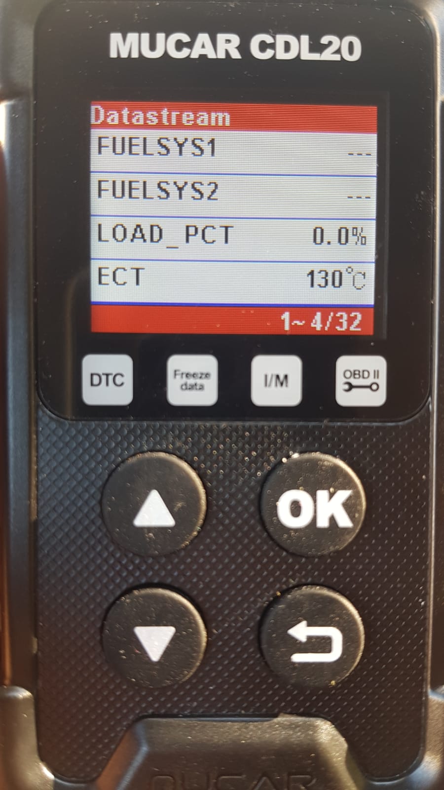

Noticed ECT (engine coolant temp, right?) shows (engine is off, obviously, since I can't start it) 130 Degrees Celsius.

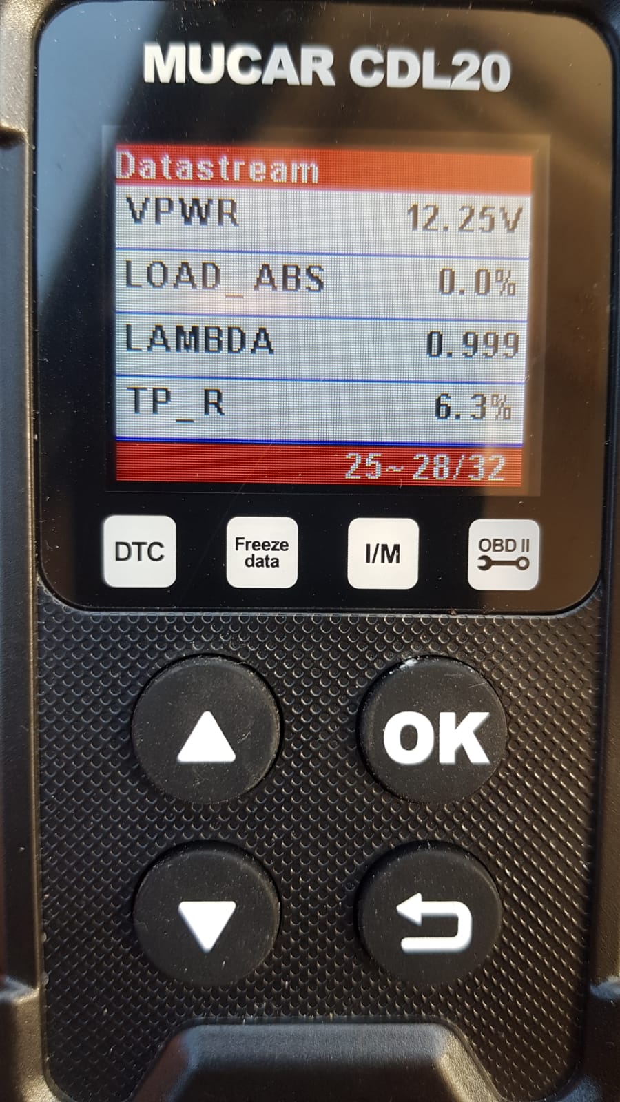

Also looked at MAP 92kPa.
Help would me much appreciated!
Please note I am not very technical - trying to figure this out because I am on a budget and I know if i'll call a tow truck to sent the car to official Fiat here - I am looking at a serious bill.
Thanks so much!

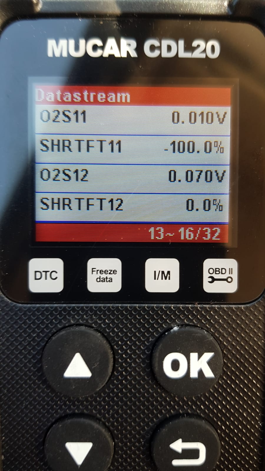

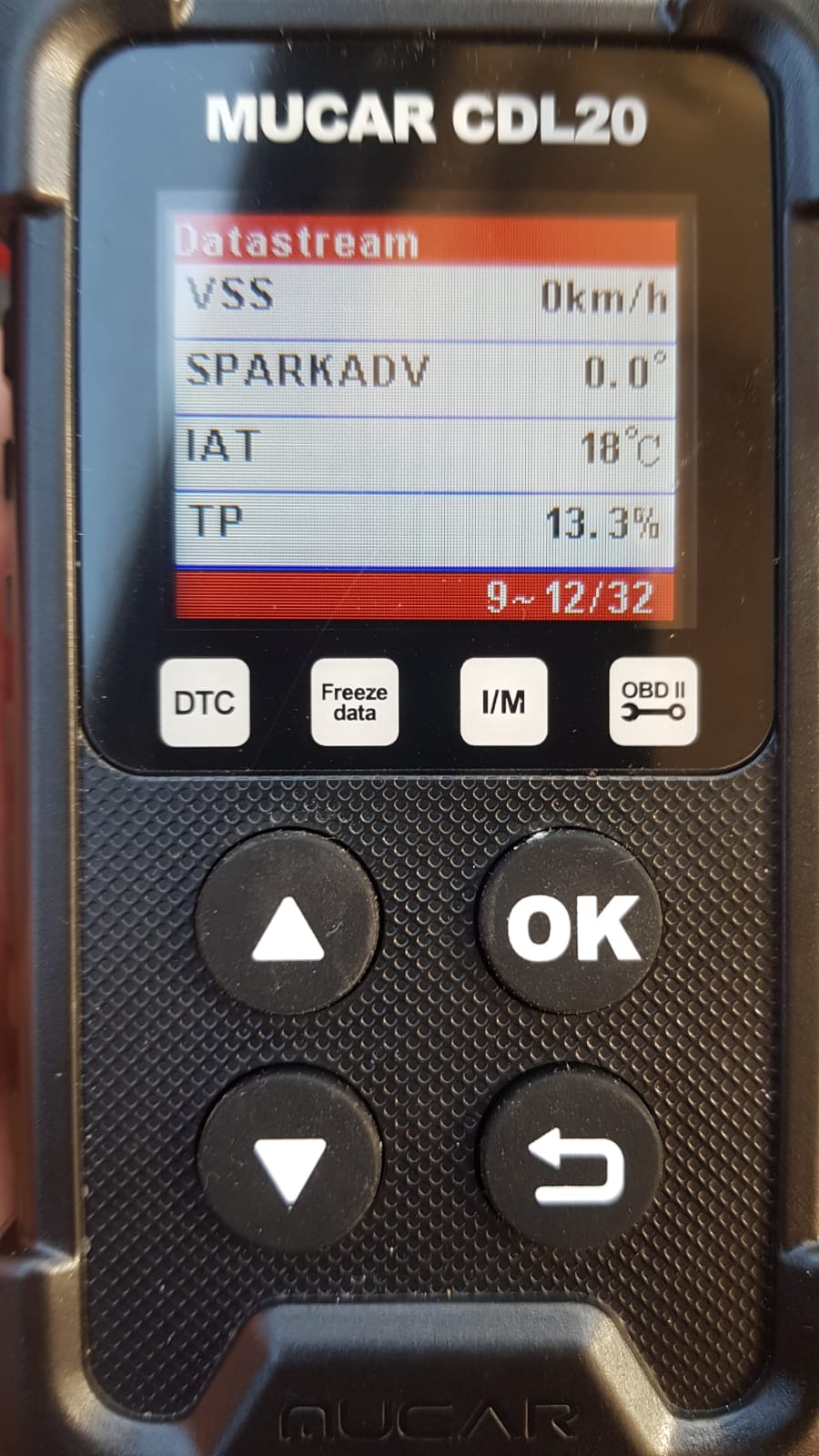

Update:
I am now figuring out that pic 4 shows IAT (which means "Intake Air Temp") at 18C which is correct.
But pic 3 shows ECT (engine coolant temp) shows 130C - which sure is faulty cause the engine is OFF and was off all night.
Right?
So what does that mean?
Thanks so much

Like you say if ECT does mean Engine Coolant Temp then 130 is not right.
Have you tried finding the engine temp sensor and re-seating the connector? Also you should be able to find online what the approx resistance of these should be when cold and hot. If you or your neighbor has a multimeter you could then maybe check the resistance when cold. It may have gone short or open circuit.

It seems the sensor reads a high resistance when cold and goes low resistance when hot. So disconnected is like a very high resistance. If the code reader thinks it's at 130 degrees when cold then it could be that the sensor has gone short circuit or there could be a short in the signal wire.
