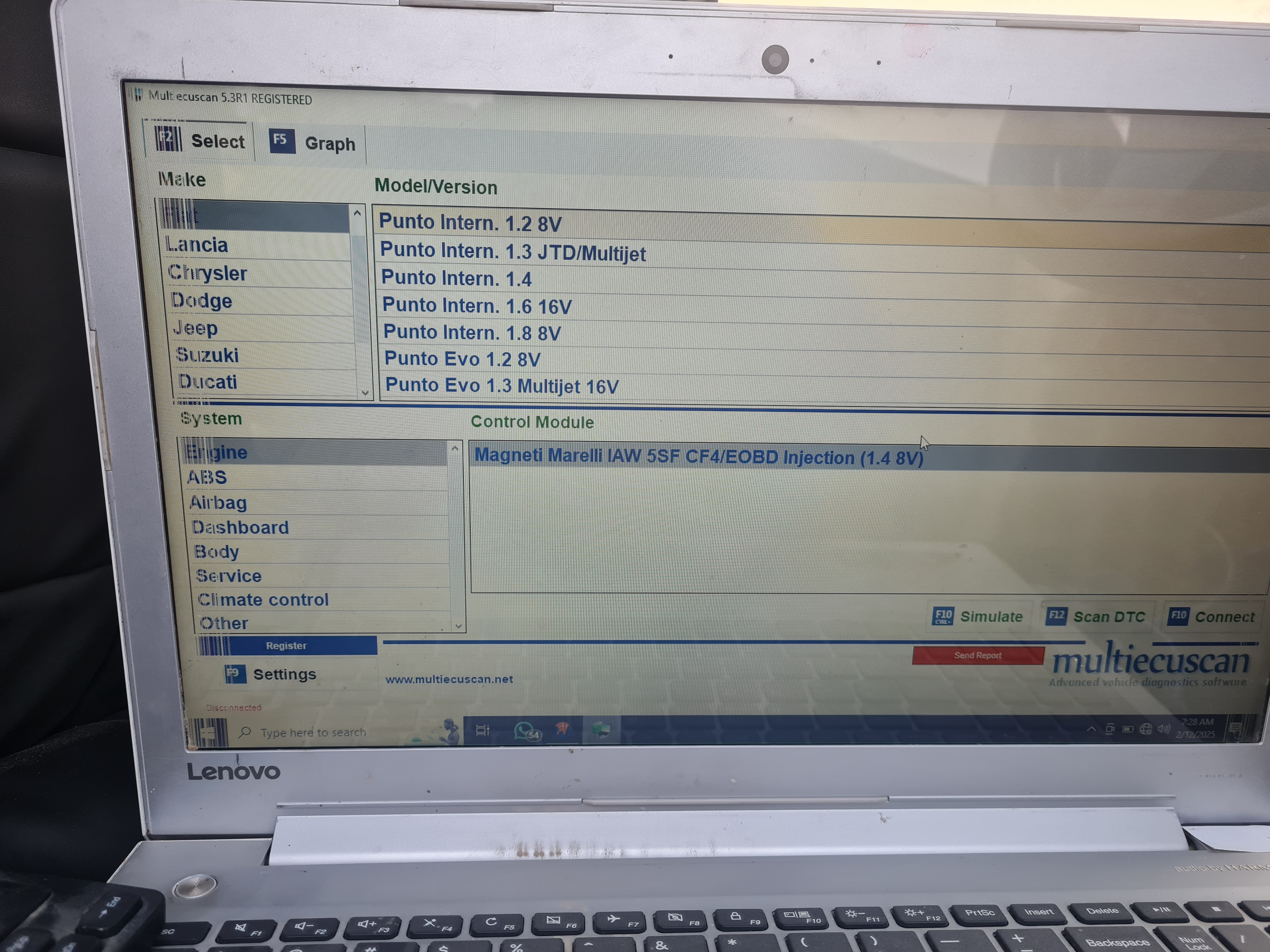

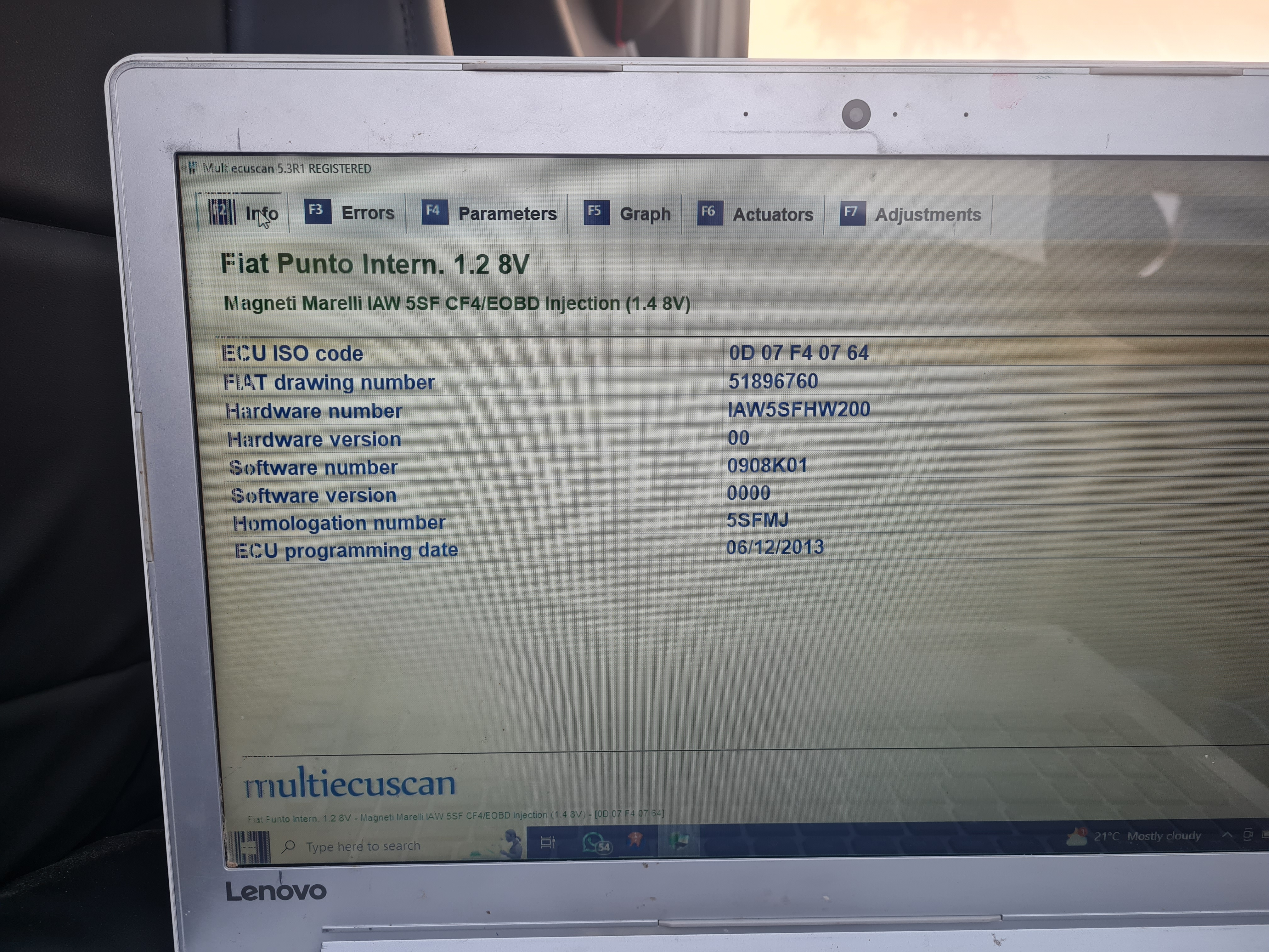

Which version of the car you own? I mean, what market, continent? European or "India" or something else (Russia, China, South Africa/America)?
Year 2016 should be "CF5" (Euro5 emissions, not 4) in civilized countries. Select right ECU (and engine: 1,2 or 1,4) in the MES program.
Is this a stock car of modified/repaired using random parts? So "2012" model/lift got ECU from Grande era? What's going on here(?).

Sorry sir.i purchased second hand car.iam from nepal here all fiat cars are made in india.i am also confused why my 1.2 shows 1.4 8v🙄.problem with my car is in morning its never starts in one key.no matter how many times i prime motor.in first start it stall in 2-4 second.but goes perfectly in second round.sometimes car don't sart without bleep acc pedal.i changed throttle body map sensor and fuel pump but problem still the same😭😭

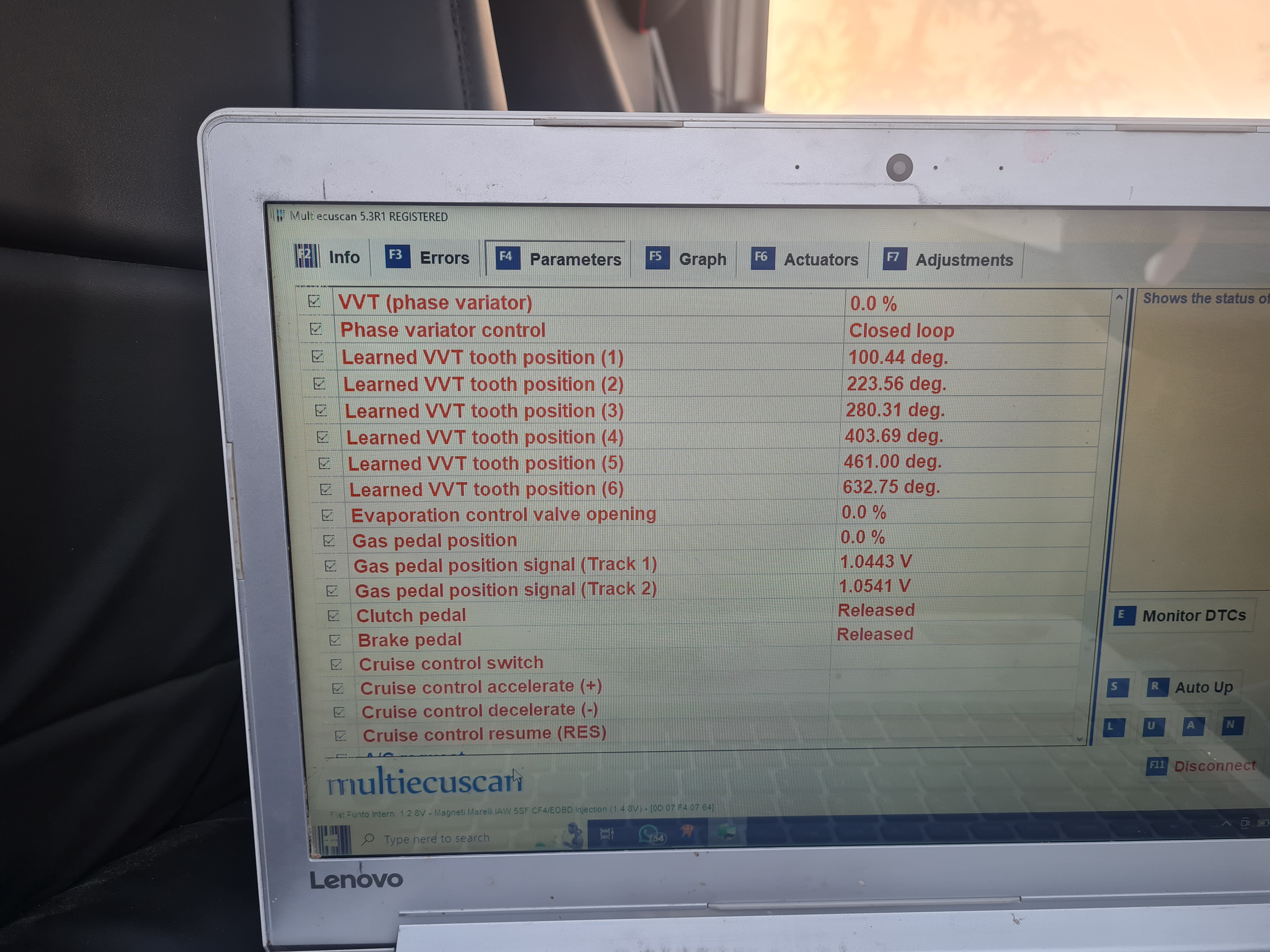

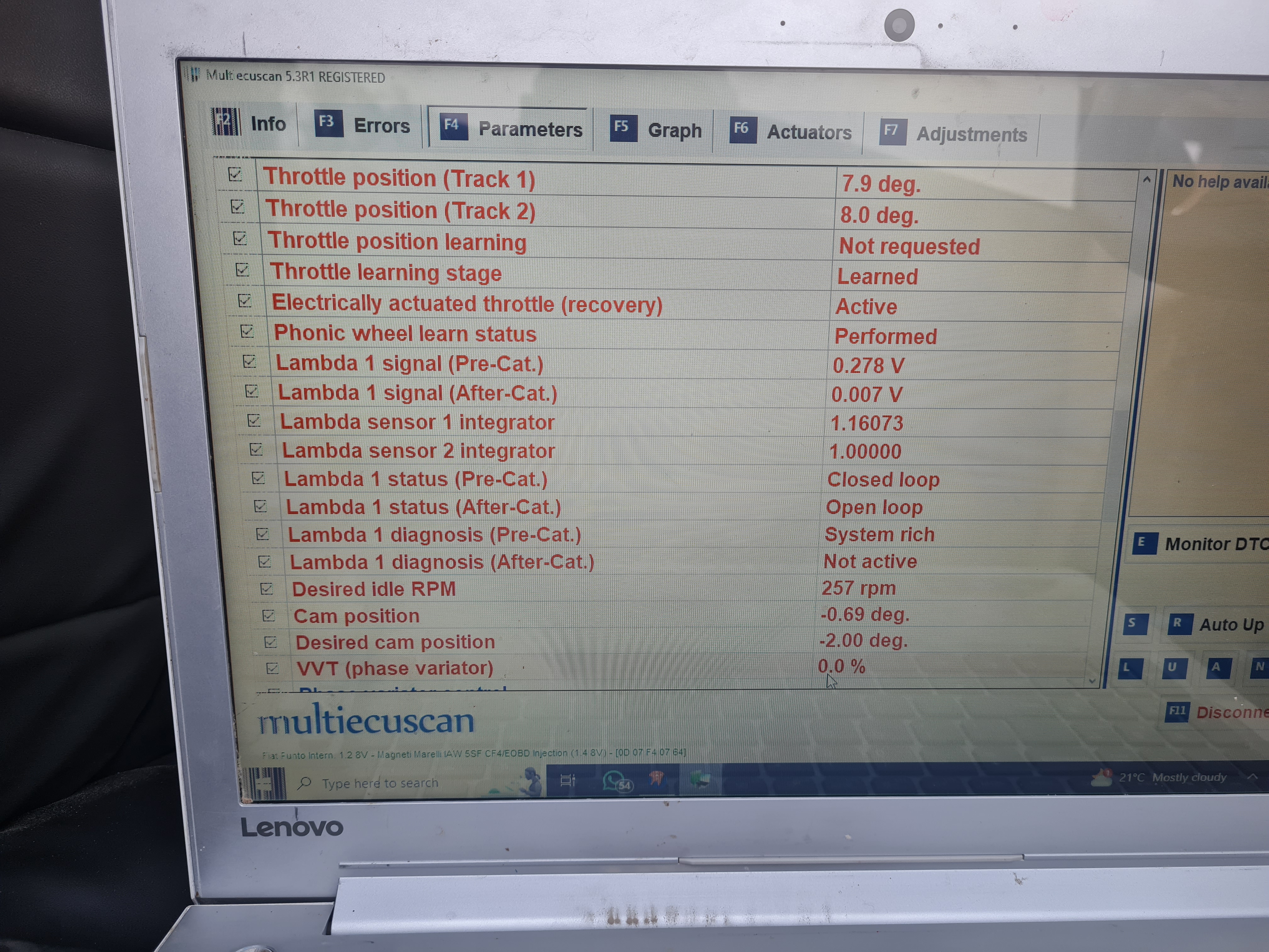

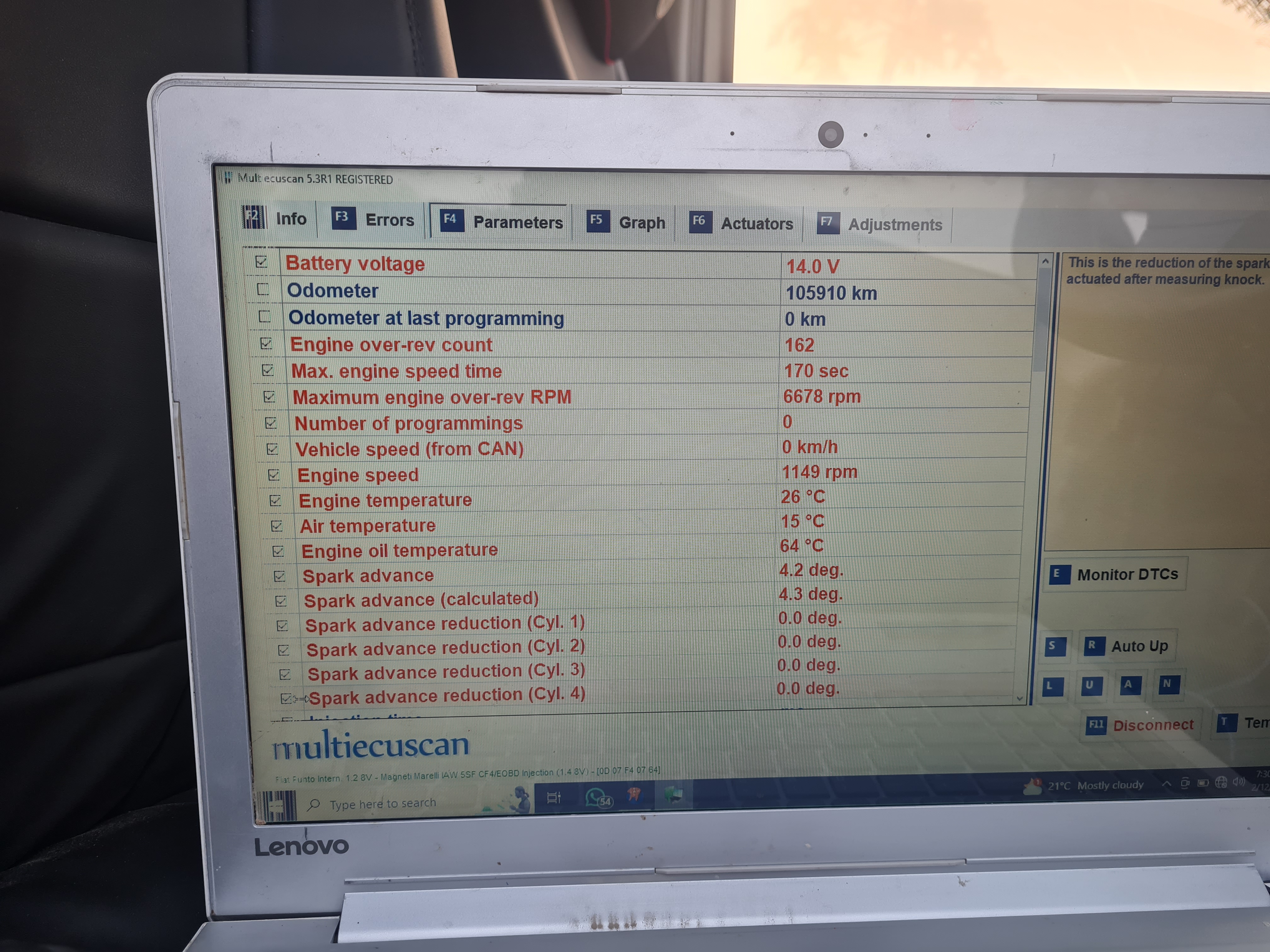

Show us all parameters from MES while engine is running.
Plus, OBD2 is for data logs, not just error codes and watching numbers jumping.
Here is all MES log sir

Unfortunately data above was taken while engine was still heating up. So some parameters will be off (not perfect).
You car is not for Europe, so strict emissions don't apply there. Engine tuning/setup may differ. Redo the test while engine is fully hot.
Some parameters are wrong (unless you are very high in the mountains). Where is the car now (altitude, how high above the sea level)?
0. Spark advance and injection time is a bit off (spark is like a hot engine, injection is high like in cold engine). Timing also affects those.
1. Calculated oil temperature is way different than air and coolant temperature. Coolant and oil temp. should be similar values. Check the coolant temperature sensor in the thermostat body.

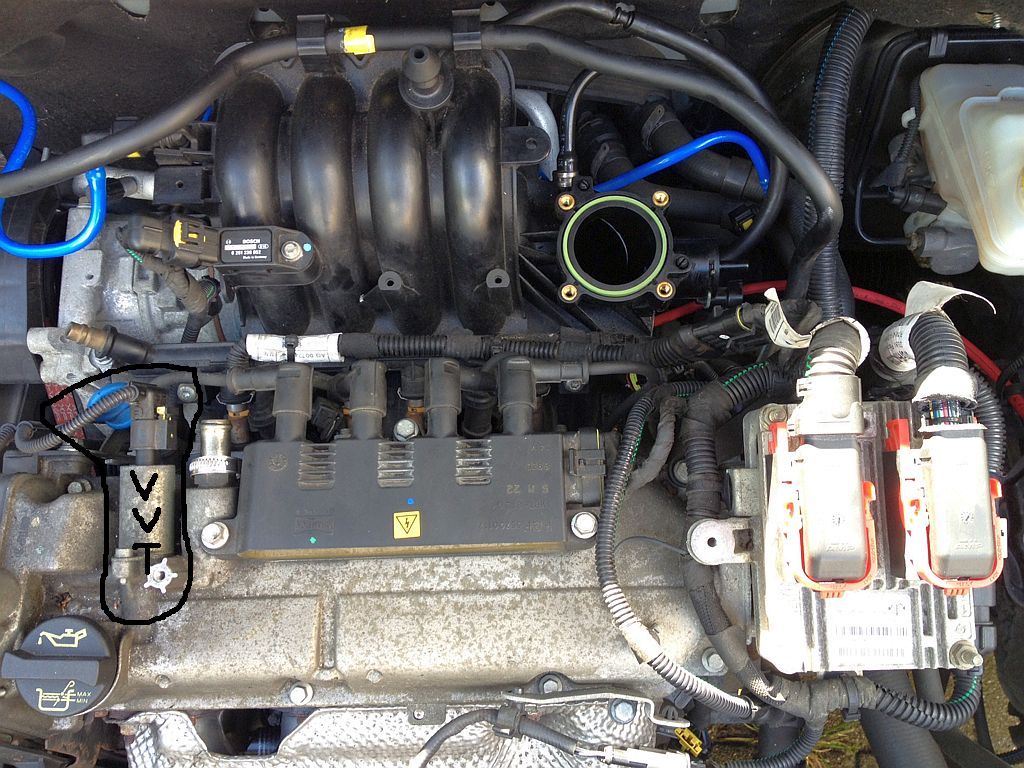

2. Intake pressure and Air pressure are "too low" (vacuum not strong enough). MAP sensor is to be checked again (and the wiring)!
There are two sensors (MAP is bigger and it's NOT visible on the picture below, it's an ambient air sensor). Which one you swapped?
3. Engine is not hot enough yet, but already lambda integrator is way above 1,0 (should be the opposite I guess, cold = too rich on purpose).
4. Do you have VVT in your unit? If it is present, VVT wheel and/or solenoid valve may be dirty (so you get small shift -0,69 VS -2,0 deg.).
5. Desired idle RPM (257 rpm) is a rubbish data (so I guess there is no VVT?). Absurd number. Nonsense. Or a software bug (MES is not perfect).
6. If you have VVT, the timing is a bit wrong (100,44 degrees VVT1 position - should be about 106,00 deg. - but again, for Euro exhaust standards). For "India", I don't know (different tuning?). Timing influences intake vacuum (so MAP sensor can be OK).

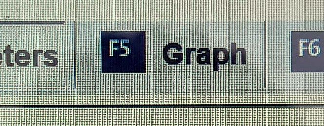

Real data logging is done here, "F5 Graph" tab. You grab data to the CSV file (then you can process it in the "Excel" for example).
Then you can make graphs, plots like this (for example VVT operation in European 1,4 8V Grande). Test drive, you record data for a few minutes.
