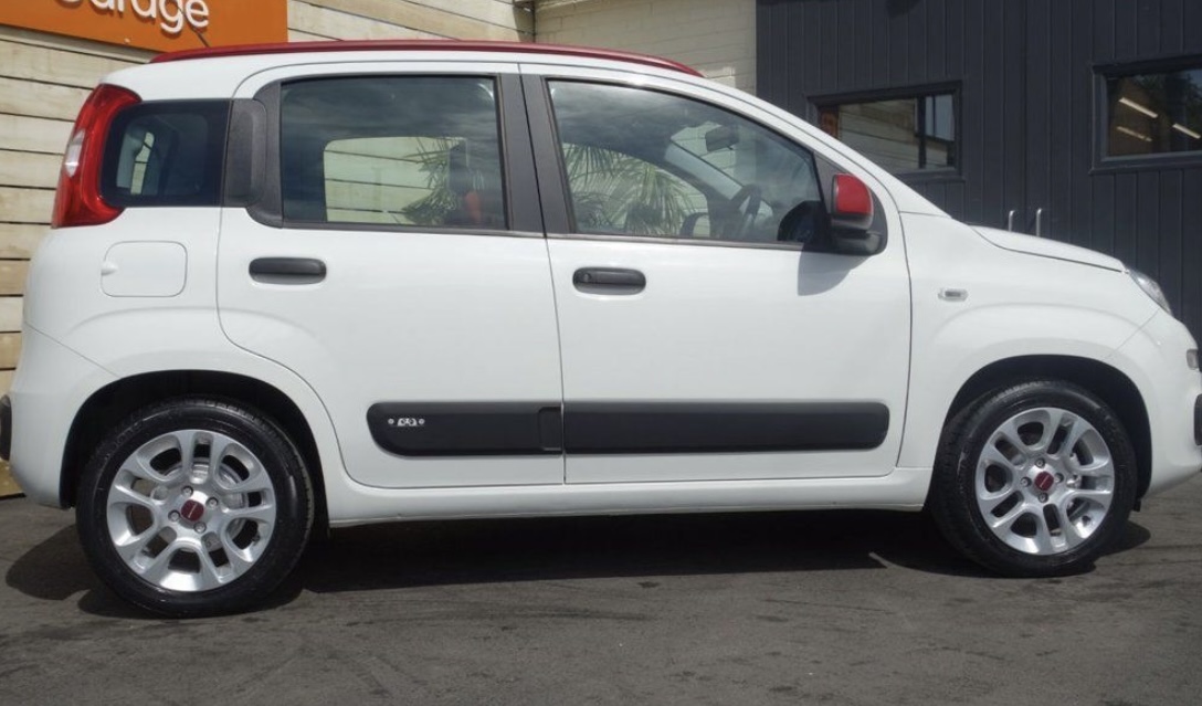

Good evening, I had the misfortune of taking my car to get some new tyres today, the garage (a national chain) have managed to dent the drivers side sill at both the front and back, quite an achievement I thought, still the silver lining I suppose is that that the passenger side seems to have escaped any damage. Needless to say they are denying it was caused by them, but it’s the first time it has been jacked up in my ownership and after examining the photos of when I bought it the sill is quite clearly damage free in these.
I will have to get something done because the paint has been damaged and I don’t want to leave bare metal exposed. Just wondered if anyone knew:
a) is a damaged sill an MOT failure?
b) can a sill dent be pulled out or would it need a new sill?
I’ve attached some photos, the bigger dent is the one at the front.

I don’t recall anything anything hitting it at any point but I suppose it’s possible, I’ve never noticed it before if so, just happened to see it when walking back to the car at the supermarket this afternoon and thought it too much of a coincidence given that it was at the garage this morning, it’s been wet here today and I’ve been down some mucky country lanes so could be why it looks dirty. I did see at the garage they used a thing with four arms to lift the car off the ground completely, presumably so they could do all tyres at once.
The sill was definitely not damaged when I bought the car in June as I still have the photos.

Looking at those photos again, it looks like they used a four wheel lift (the 'scissor type' that rise out of the floor), and didn't check that the rubber lifting blocks were correctly positioned on the far side of the car when they pressed the 'up' buttons... so the blocks have slipped out and run up the side of the sills. That is actually quite frightening, and the fitter would certainly have been very aware of what happened.
As to repair: it shouldn't rust as the whole body shell is fully galvanised. And I can't see that being an MoT failure (although sills are an area of extra rules as a key structural part).
Well I’ve got quotes from a three reputable body repair shops locally, all pretty similar prices (£240 - £300), the one I’ve gone for has good reviews and they’ll pull out the damage and do the paint local to the damage so not as bad as I thought. I won’t bother trying to complain, as others have said it’ll just be a load of hassle and no guarantee you’d get anywhere with it.
I have to say the small mark does not look like jacking damage, but the big one does. I would ask a mobile dent specialist as the most economic solution. These guys can work wonders on minor dents.
