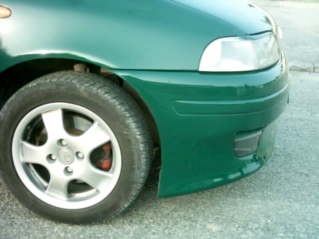

, when i take off mine i dont have much of a problem with the glue because i will paint over and take off the holes, in your case you have to do this, 1st you must have a heatgun, one of that little screw drivers a little sharp blade and a plier, use the heatgun to start melting that glue on the hp badges, use the screw driver and start lifting the badge nice and easy, when the badge takes off dont forget to turn off the heat gun hehehe and use some petrol or alchool to take that glue, do the same on the other badge, dont worry the glue will come off, just be careful. (y)

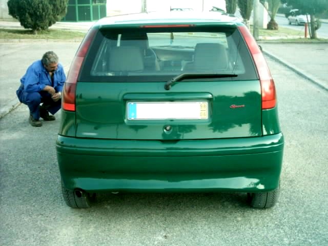

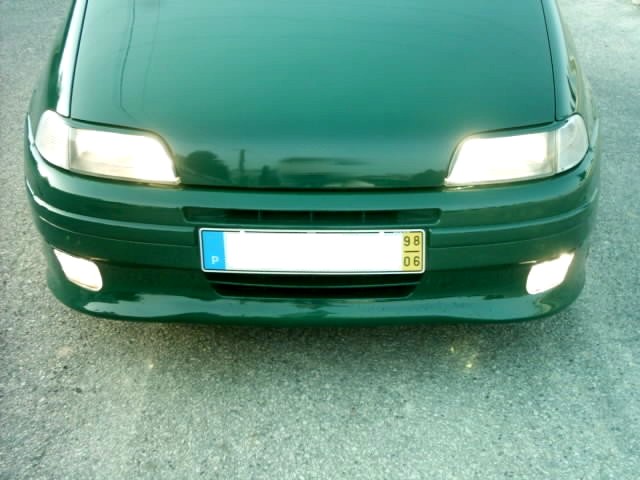

On the rear badges you dont neet the heatgun, just try to protect the sharp side of that little blade with something soft like a cloth or you can scratch your paintjob, with the help of the screwdriver start lifting the badge, when you can grab the badge with the plier just take it off carefully. Its normal you notice the paint under the badge is newer, because its not "burned" by the sun. the front fiat badge is the easier one, just use the plier and take off that two screws and he will come off. :slayer:
