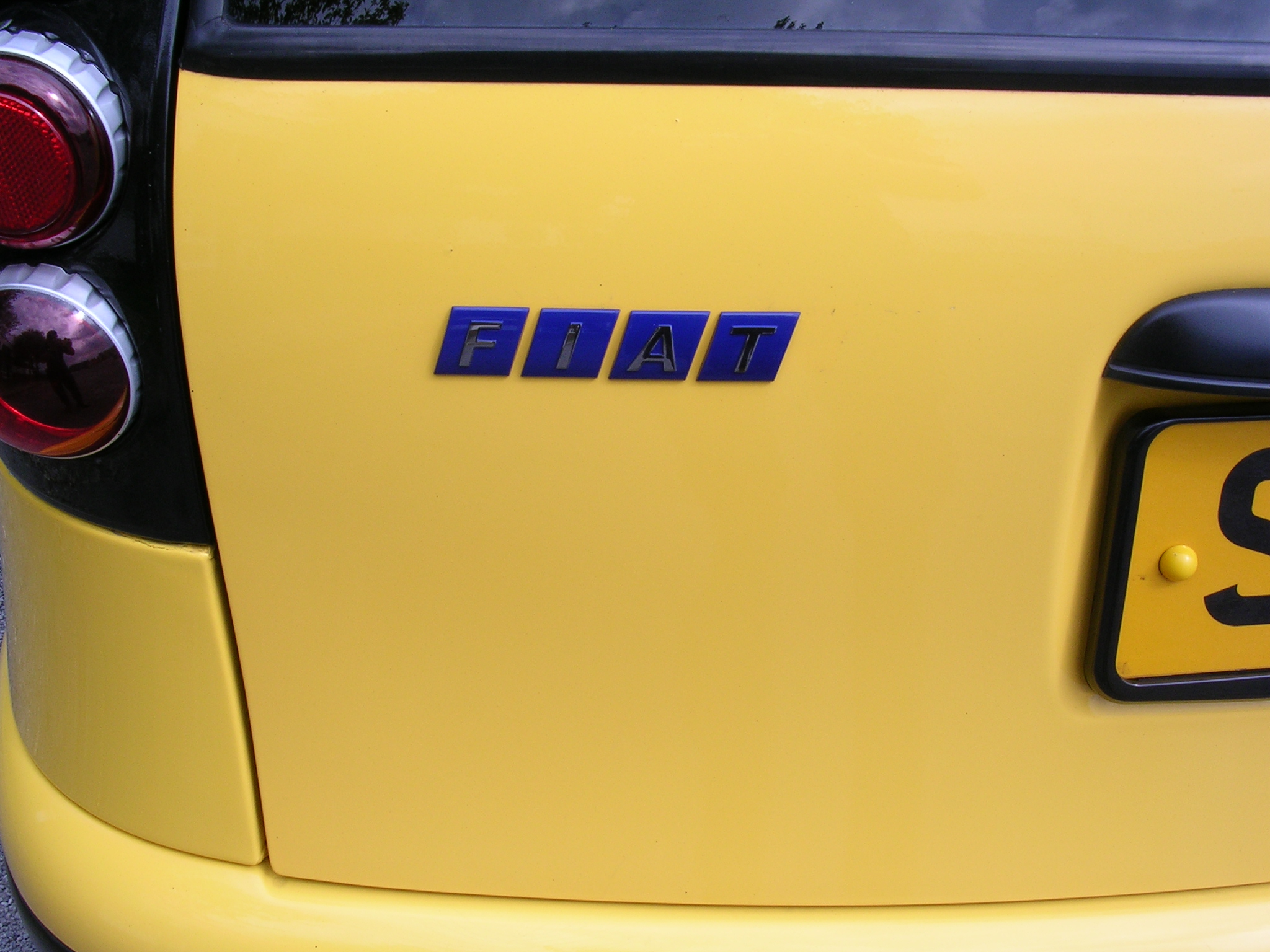

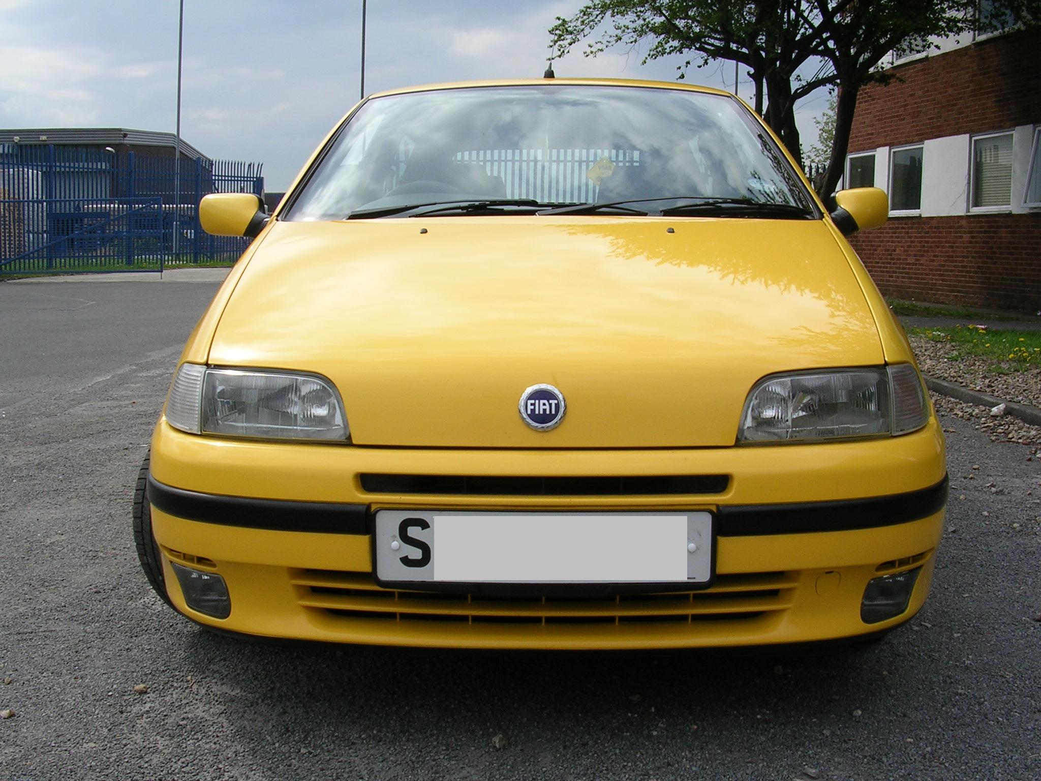

Dont bother de-badging!,
everyones at it!!!
what you wanna do is just upgrade to some new shiney mk2 ones!!!
like this!!
no filling,or welding,and i think its quite neat!
