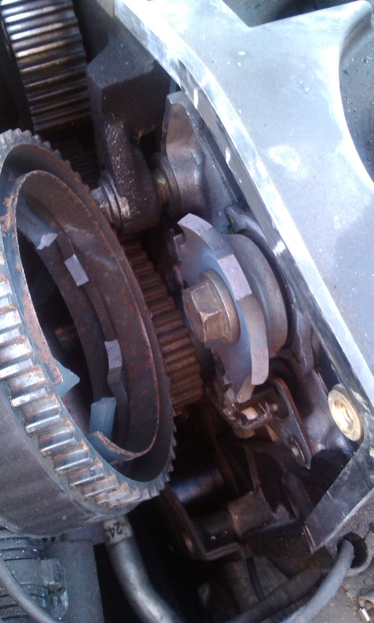

Well I'm afraid it's about about as bad as it could get. A pulley shattered, and basically the engine is completely shot. It's not financially viable for me to repair it, so I'm going to have to sell for spares or repair.

Not being technical, it was the one a the the top to the front. Found a pretty decent mechanic, came round, towed it to his garage, checked it out andtold told me everything dead straight, showed me the pulley etc. He's towing it back to mine tomorrow, and not charging me anything.... so I suppose I can't really complain, and I've no reason to think he isn't being straight with me.
Top front would be the camshaft pulley. Never heard of one of those going before.
Have you had the timing belt or camshaft sensor replaced recently? Perhaps someone left the retaining bolt loose.
That's the one. There was just the centre hub left with some broken spurs off it.
Nothing had been done to the engine recently, it had been running like a dream. The belt was changed when I bought it, two years and 45k ago.

That's crazy! I've never heard of one of these going before. I suspect something inside the engine has seized which caused the camshaft to jam - hence overstraining the pulley.
