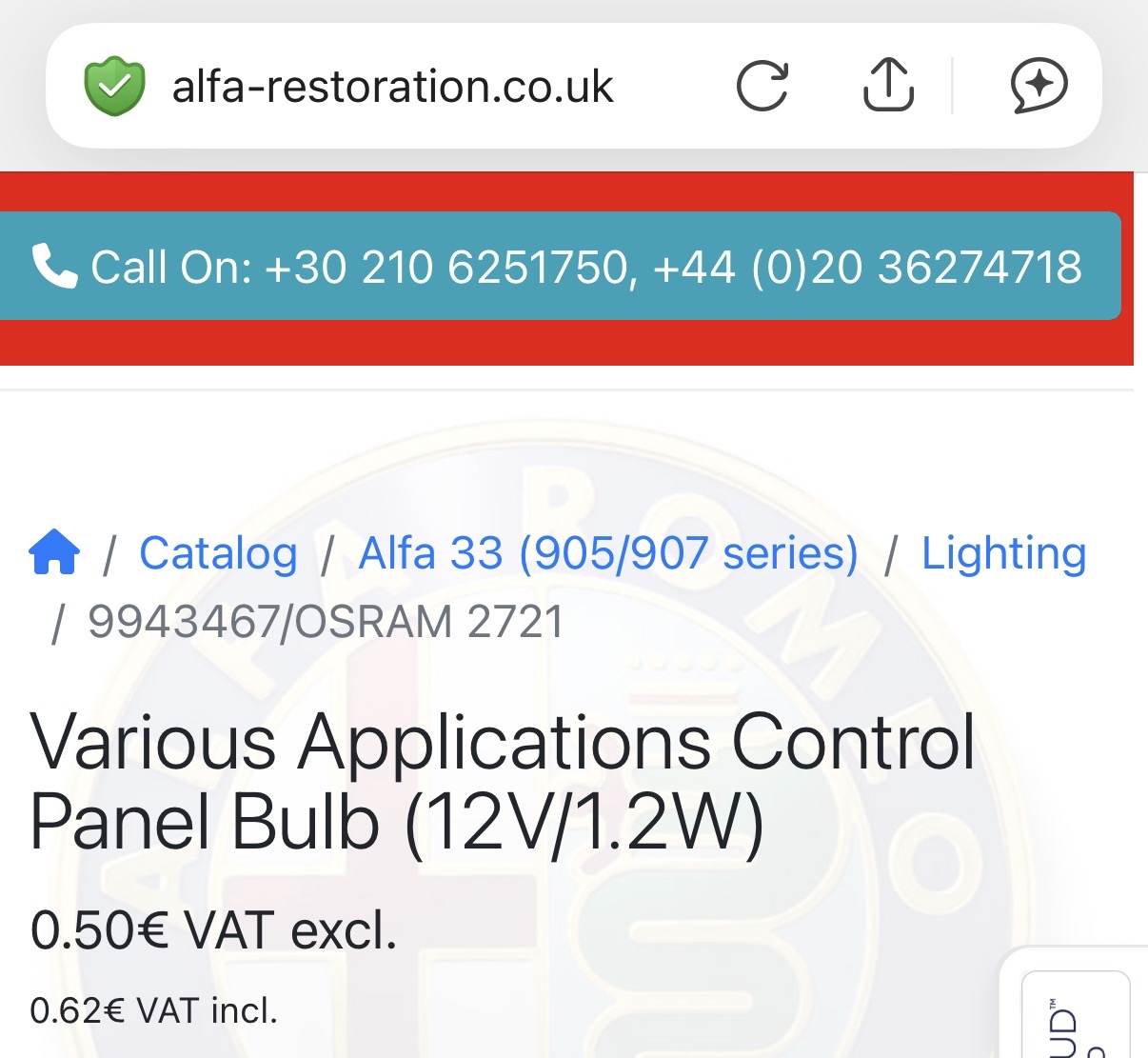

Hmm, €0.62 incl vat, plus postage, decisions decisions (it can probably be found on aliexpress as well).

Left Fiat, Right side Osram B8.5d 1.2W (which was mentioned on the forum and also alfa-restoration, but maybe they only used the bulb and not the holder..)
The bulb inside is 1.2W. Can't be 100% sure if the bulb it is the original one, but I suspect so.
