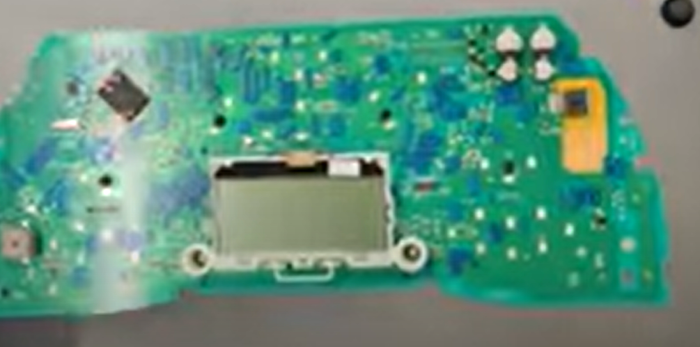

unfortunately the instrument panel has surface mount L.E.Ds so isnt an easy repair for most people
you can change for a secondhand dash and do a poxi alignment
you need the correct software (not cheap) or know somebody that had and the replacement dash has to have lower miles than the one your replacing
I would just replace the L.E.D but then SMD soldering is what I use to do
