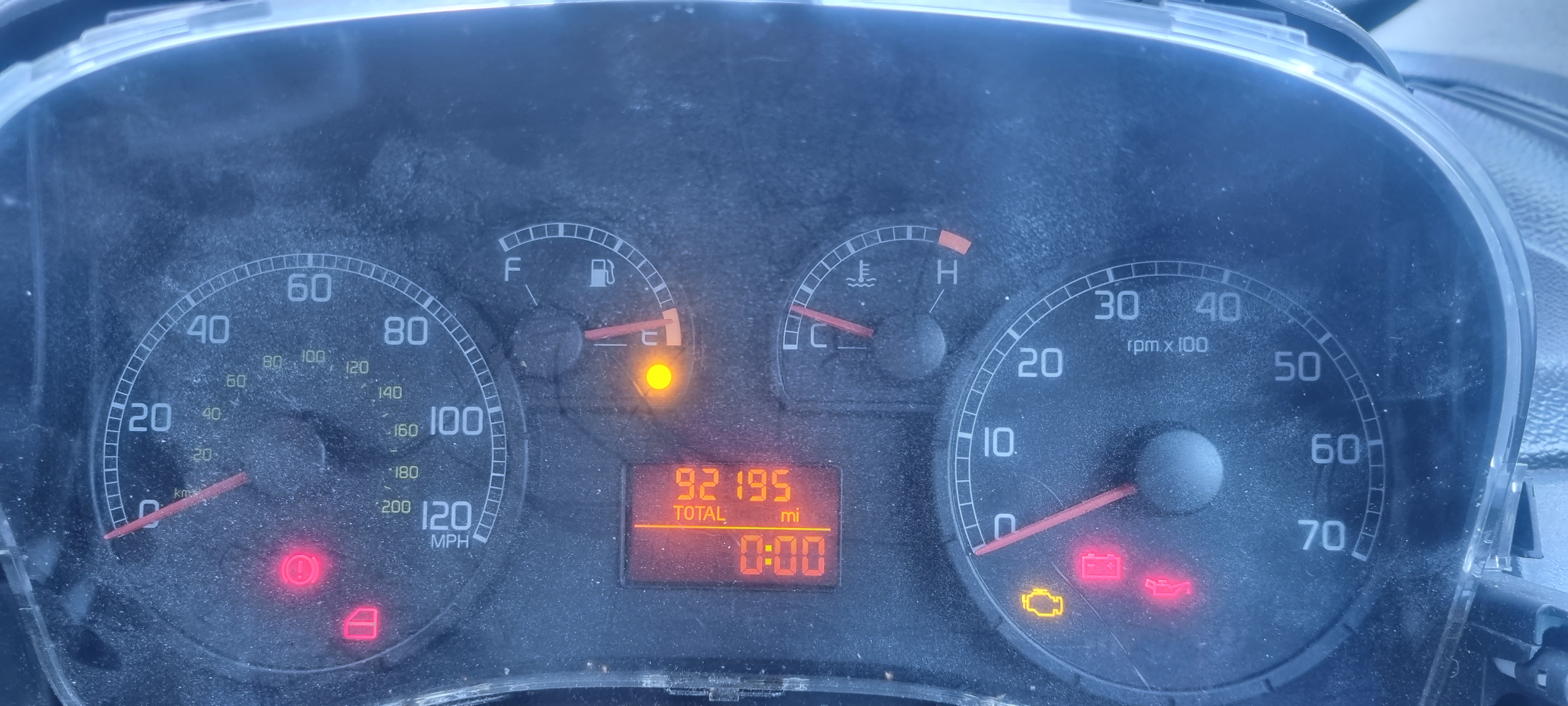

I've got a mk2b 3 door active sport , the speedo back light has stopped working..
All others lights( ps, City, eml,, headlights etc light up) I can see the mileage etc but it's like the polarity is reverses, as in dark box with slightly light numbering....
Any ideas?
Picture attached

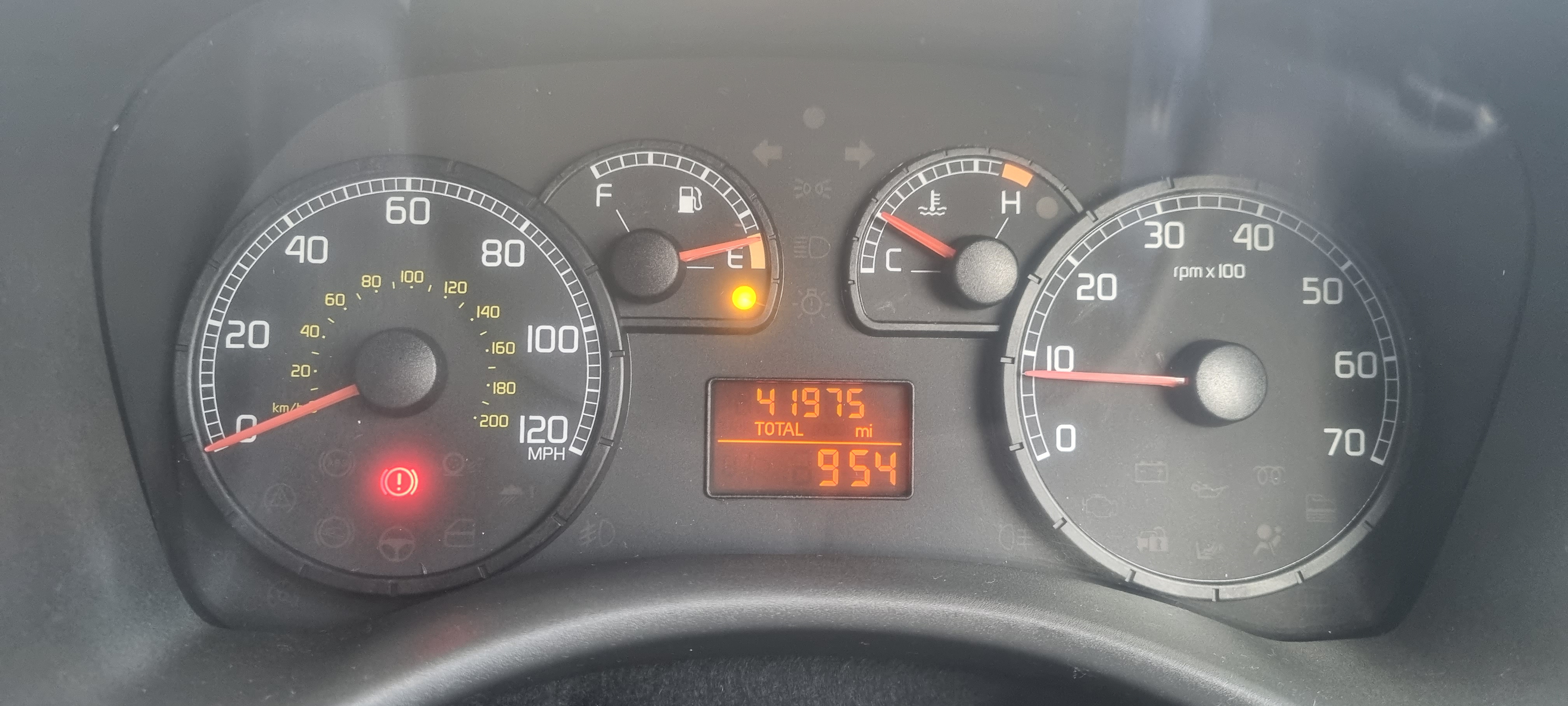

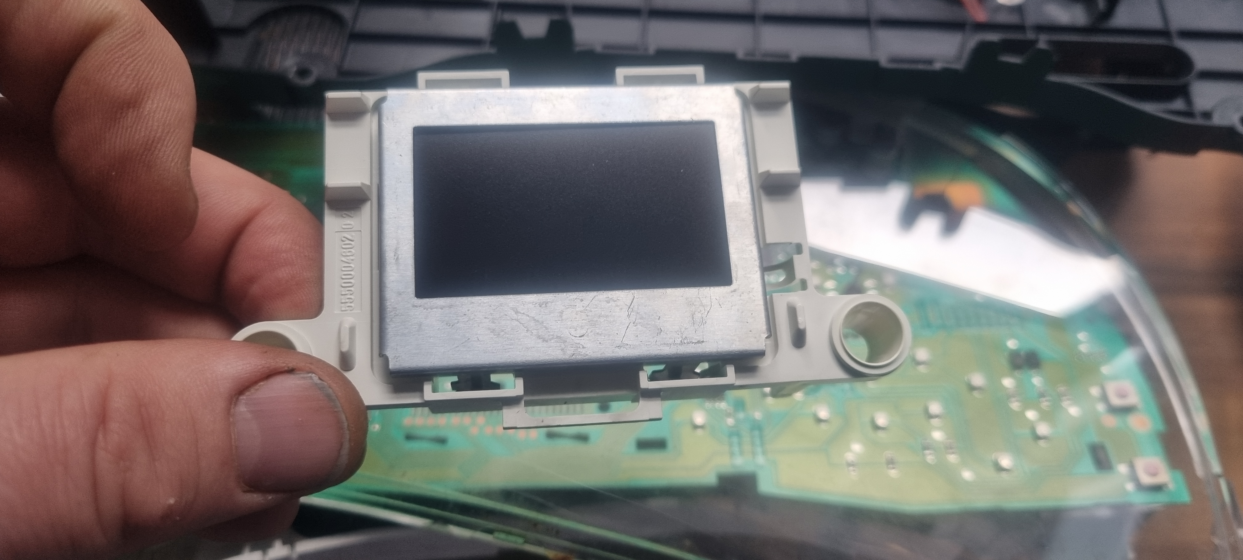

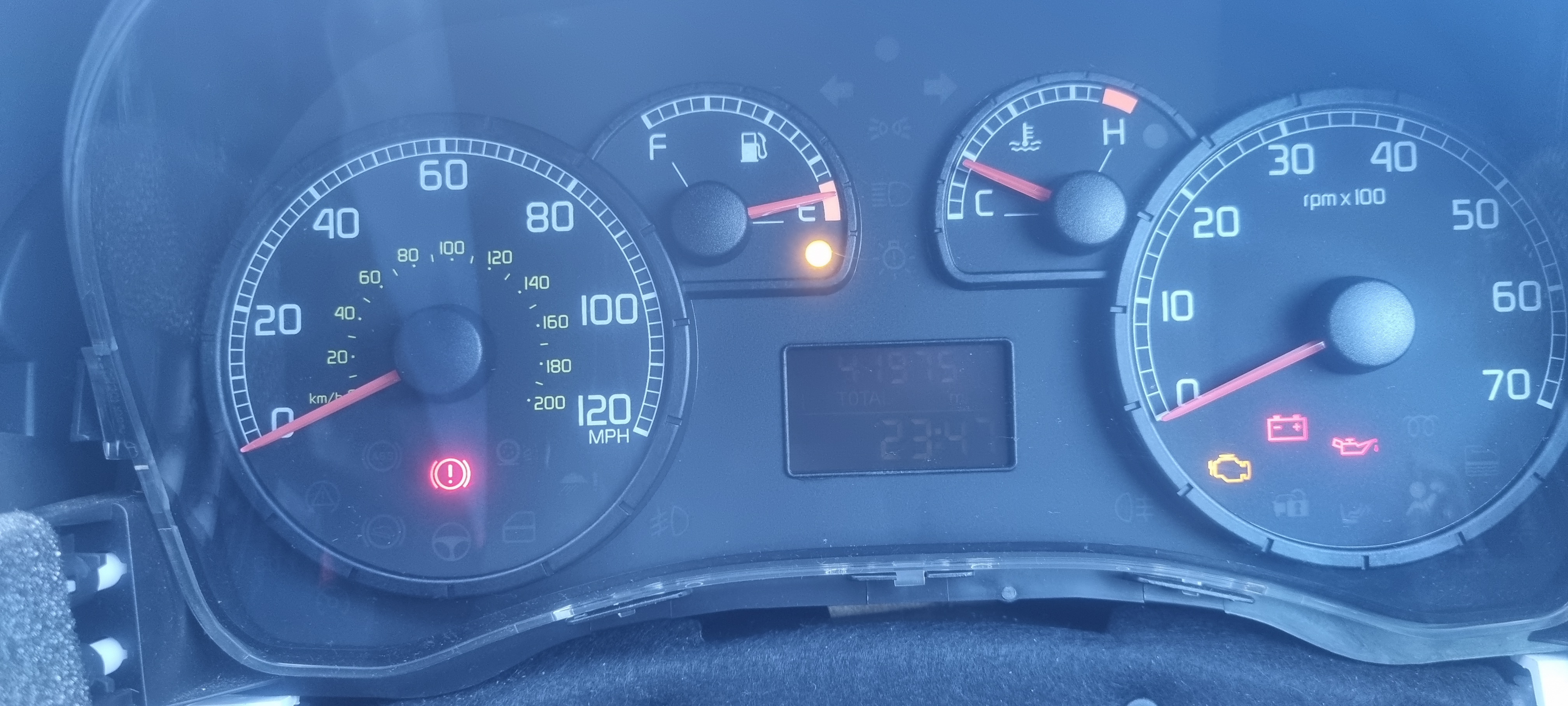

So went to the car this morning and it was working again for 2 mins then went blank again... so from my spare lcd, I swapped them over... 10 min job, now all working again... had car running for 30 mins and it stayed lit.
