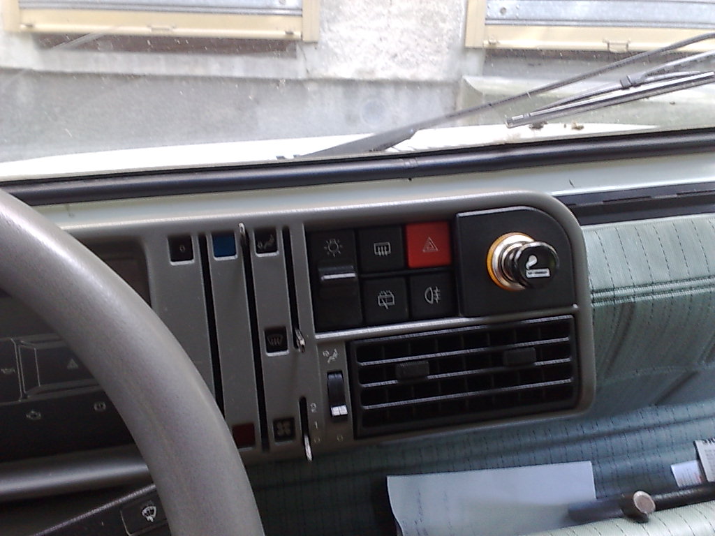

Nothing there (CityVan-2003). Gray dash-cover even is not translucent under heater ideograms????
See this:

Sounds like a loose connection on the bulb. Remove dash front and have a look, probably won't need replacing (y)
They're a bit poorly designed :p
Jon.
That's exactly what it was. Had it all apart this morning and where the bulb goes into the dash it was all very loose and the bulb had fallen out. All tightened up et voila a very cool lit up dash - it might be worth checking if you have a later Panda to see if you have lighting - the bulb goes into the back of the red heater indicator (where you push your button down for hot air).
That was a very worthwhile 15 minutes.
Glad to hear you've managed to sort it Martin. Did you see what I meant by poor design? Held in with only 2 arms :p
I did. Once those arms pop, they lose their grip on the bulb hence no light. To be fair, it's a simple design that works - it took 14 years to stop working so hopefully I am now good for another 14!!! :D
