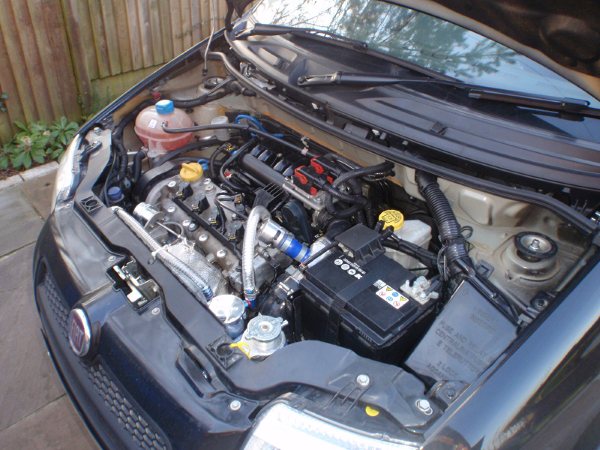

Panda Current car -Panda 100HP turbo
Again, hope you like:
Abarth manifold
Abarth IHI turbo
Custom downpipe
Stainless sports cat
supertrapp exhaust
PWR chargecooler
Bosch chargecooler pump
ViPec standalone ecu
Bosch 440cc injectors
NGK iridium plugs
Modified forge wastegate actuator
Bailey dumpvalve
alternate Bosch map sensor
cusco catch tank
etc..
-Andy

I have a 2013 that when bought fortunately only had 1760 miles on it. 10 months later im at 23k. Love the car and different features in sport mode etc. I have the 1.4 16 valve multiair engine. I cannot for the life of me find any info on a universal style turbo or how many pounds of boost the engine can handle without full rebuild on forged pistons etc. It would seem you have the same engine and basically turned it into the Arbarth or better. So have i been misinformed that these engines cant handle that much boost and a universal turbo isnt really necessary? I would really appreciate your input. New to the forum and came to seek this info specifically. Nice build to btw Modding for better performance is always fun.
Looking forwards to the OP's comments. He's done the job after all. :)
You could probably get quite good gains with traditional gas flowing and exhaust (full manifold and system) tuning techniques.
Turbo engines usually have lower mechanical compression as the turbo itself delivers part of the compression ratio. This allows more top end power at the loss of low speed power and economy. Unless it's very well managed with very clever ECU maps you will notice more turbo lag.
A turbo is a nice way to boost a normal engine but take it beyond a 25% to 30% power hike and you could be in for expensive repairs. All Pandas (pretty much) use the same gearbox, so that will be the weak link if you get too enthusiastic.

Been a while since posted, not sold my car yet so don't have funds available. Re-reading thread though the last think shakey said about this was struggling to get power down in 1st/2nd gear. Was anything done about this?
Tha Panda 100HP will spin its front wheels all too easily with standard engine. A limited slip diff would help.
The Punto Mk2 HGT (130bhp from the 1746cc engine) had traction control built into the ABS. Even that was a dead loss when both wheels lost grip as it did not compare the rear wheel speeds. It might be possible to use the Punto HGT body computer but I have no idea if it has ever been done.
A Panda 4x4 gearbox and final drive system will probably fit but you'd need to take a scrapped car apart to get all the necessary parts. That would solve all power delivery problems but who knows if the overall drive ratios are correct and who knows if there are any electronic systems that would need the 4x4 body computer.
