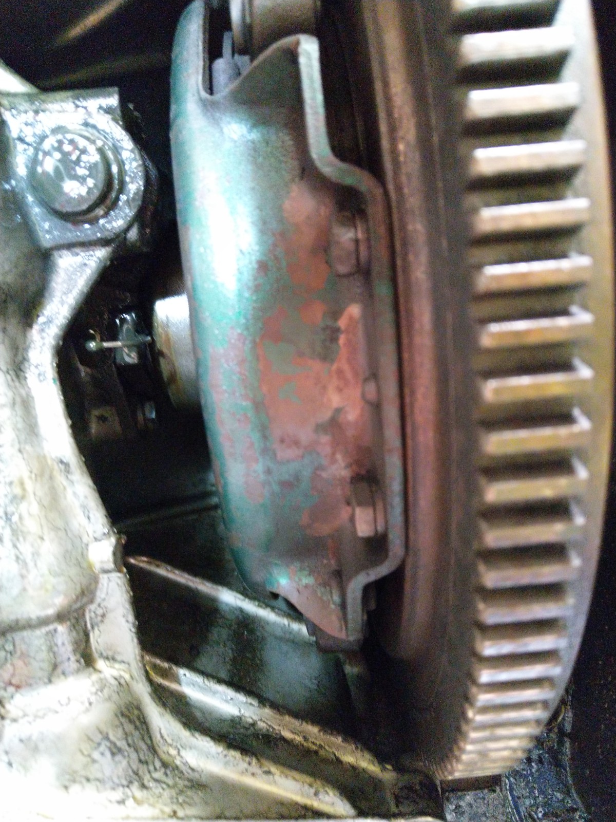

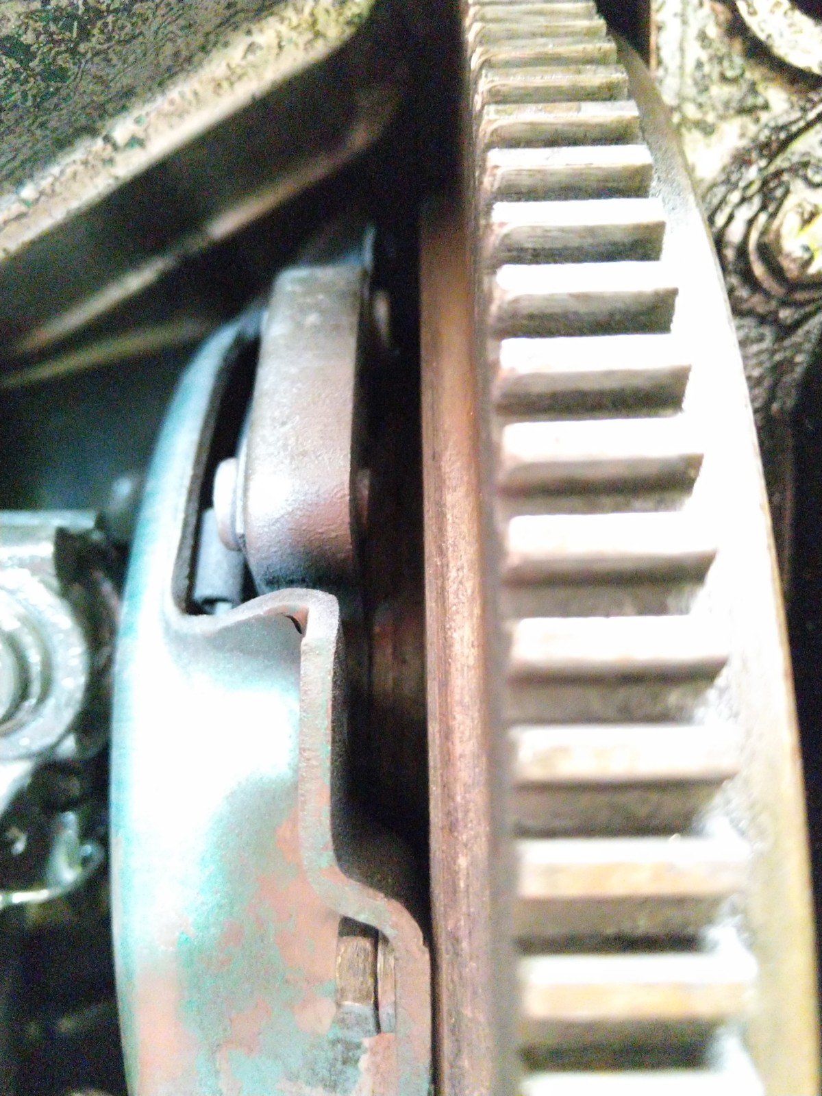

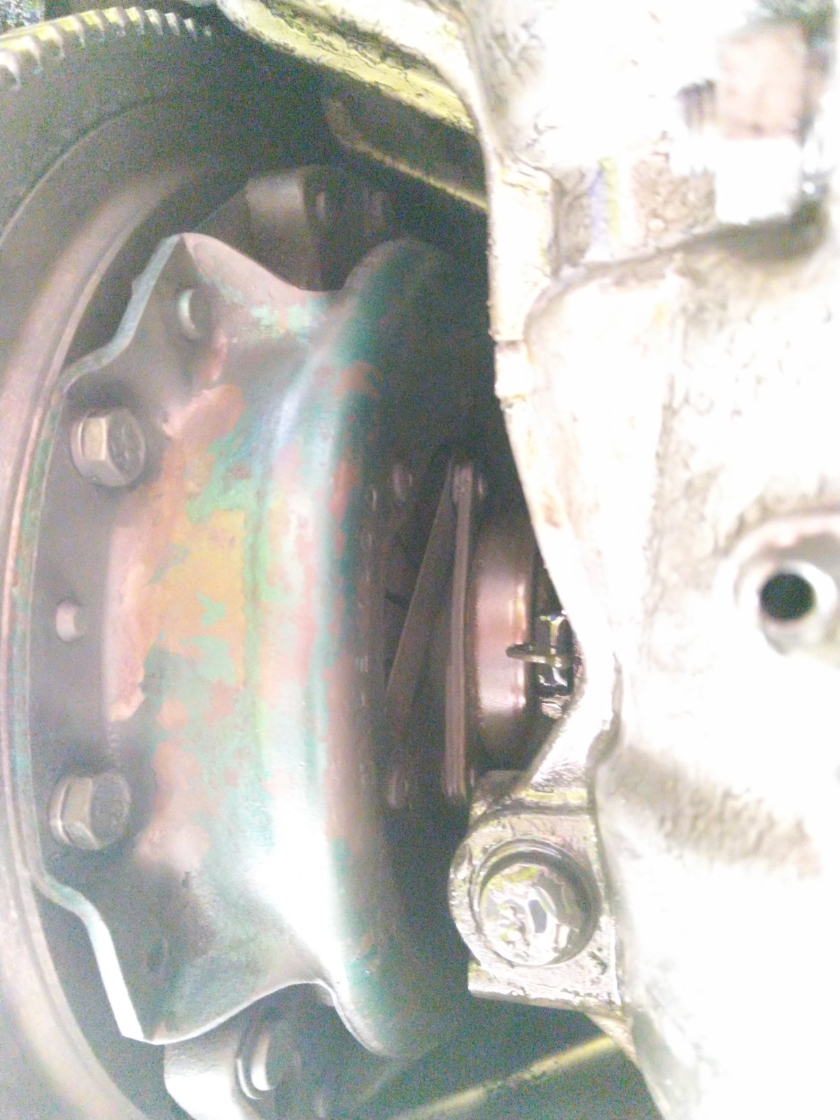

A useful feature of this car is the triangular cover-plate under the clutch housing which is secured with three screws. With it removed you can see a lot of what is going on. You will see if the linings are very thin which might explain why you have so much wasted pedal-travel. With the cable slackened and the spring removed you can also understand the principle of where the small amount of free-play at the pedal comes from; it's simply that the release-bearing mustn't be pressing on the pressure-plate all of the time. In practise this means that as long as the return-spring is holding it a few mm. off the plate, you will have maximum possible movement at the pedal and a reasonably high "bite"point.
A clear image with the plate removed would be helpful.
Here are some photos. I'm not really too sure what I'm looking at and when I got a lovely assistant to operate the pedal I couldn't detect any visual change when I adjusted the cable. I have left the car in the air with the cover off if more photos would help
It's very hard to make anything out from those. I'm trying to see how thick the two faces of friction material are. When your glamorous assistant pressed the pedal you should have seen the thrust bearing move forward and cause movement on the pressure plate. I'll look for some images if my own.

Peter, I tried to catch all the angles but the phone was so close to my face I couldn't tell if it was even in focus. My eyes sure weren't. Yes I could see the thrust bearing pushing against the pressure plate but couldn't see any separation with the pedal at rest, even if I slackened the cable right off and disconnected the spring. But I'm not sure if i should've.

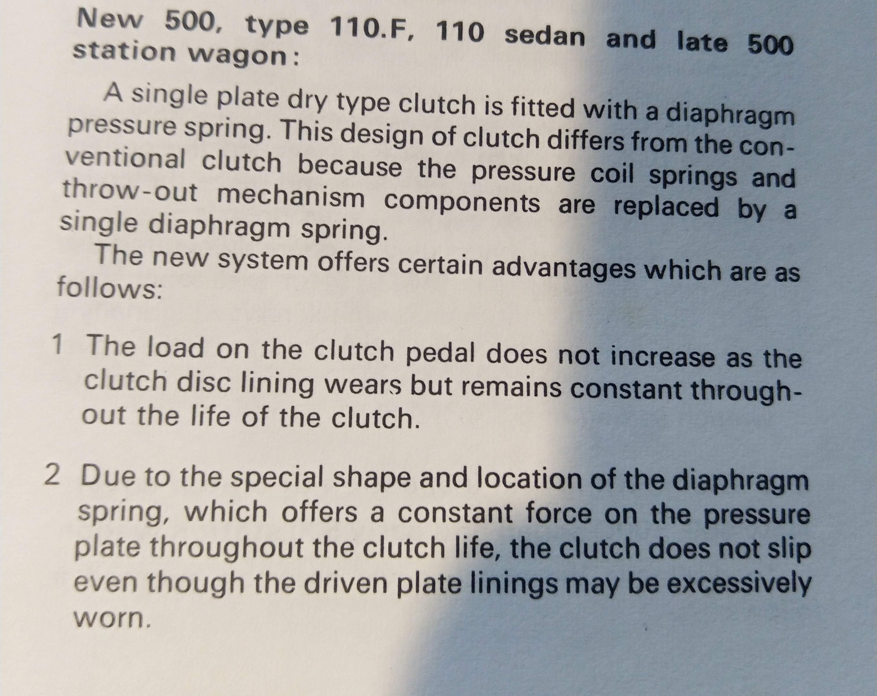

Was idly reading my Autopress manual and saw this (point 2) which suggests the friction material could be well worn down without causing slip. So if I understand this correctly (and I know that's a stretch) my clutch driven plate could be worn out causing the the cable adjustment to use up all its available thread (and then some). Is it possible then that this is causing some crunching if the clutch can't fully disengage?
"idly reading"!...I like your style Andrew!.:D
Yes..that's one of the surmises I am making. I can't easily find the data which gives the new lining material thickness of the clutch but I guess it would be anything up to about 4 to 5mm. So if it was down to 1 to 1.5mm it would be ready for changing in any case; someone must have the correct wear-limits.
You could get a measure of this if you have any plastic spacers handy that you could place against what you can see from underneath; I use these things when involved in DIY work and they come in all the basic mm sizes.
Ultimately a very worn friction-plate will slip, but the operation of the diaphragm-spring accommodates this for a long time.
