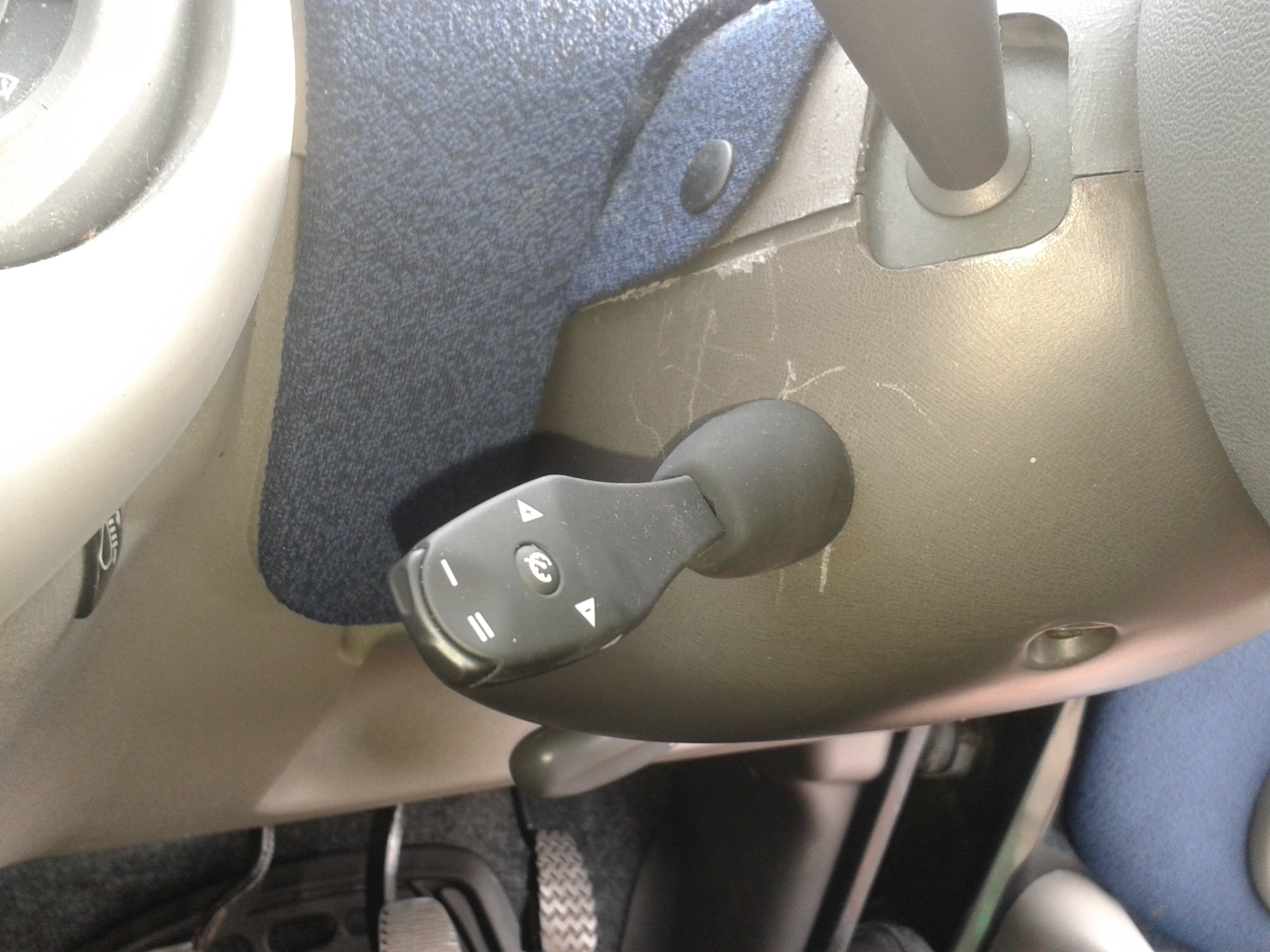

Sounds interesting - but complex! I'm interested in what physical controls are supplied. Where does the switch go and how is it set/ operated?
Nick
There are a choice of controls but by default a traditional stalk is provided.i will upload a photo to show. You need to e comfortable with electronics and a soldering iron to take on the job

I promised to upload a picture of the CC control stalk. Hopefully I have attached this image correctly

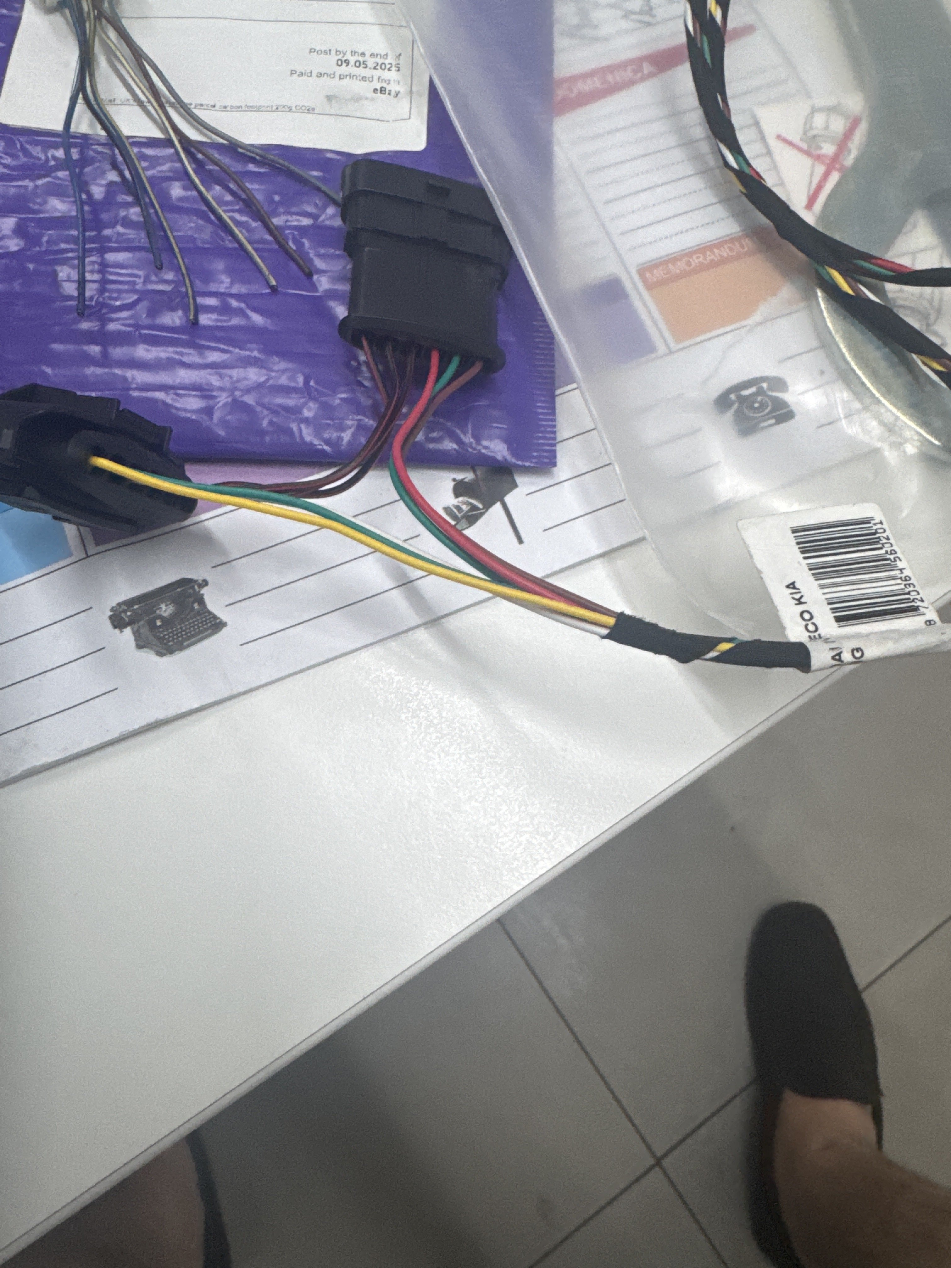

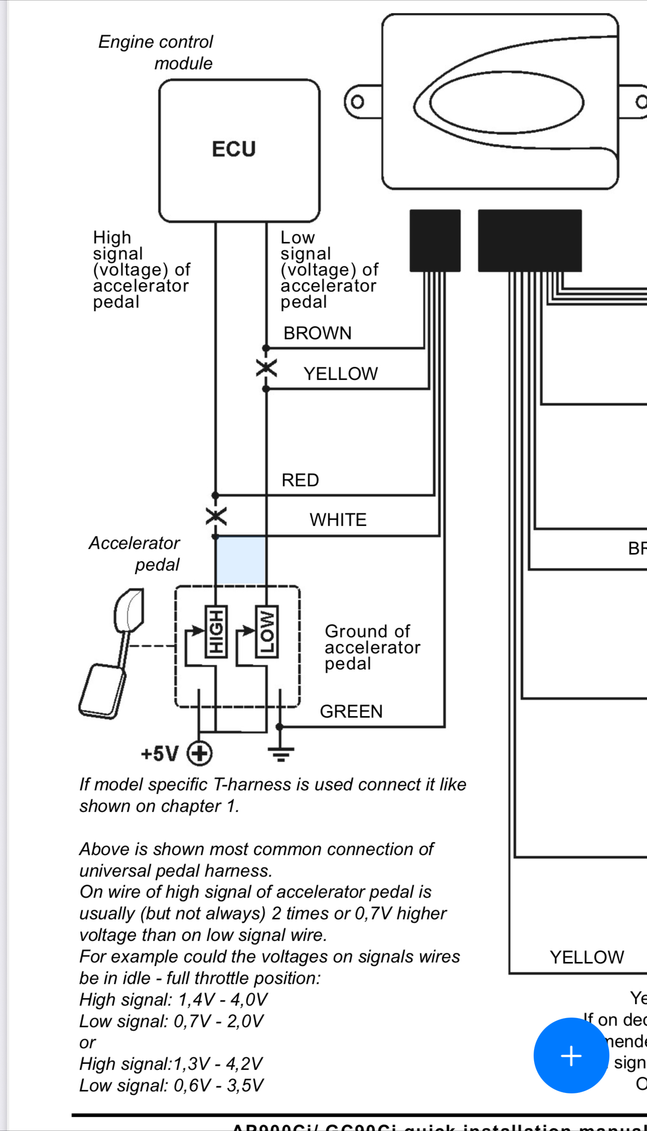

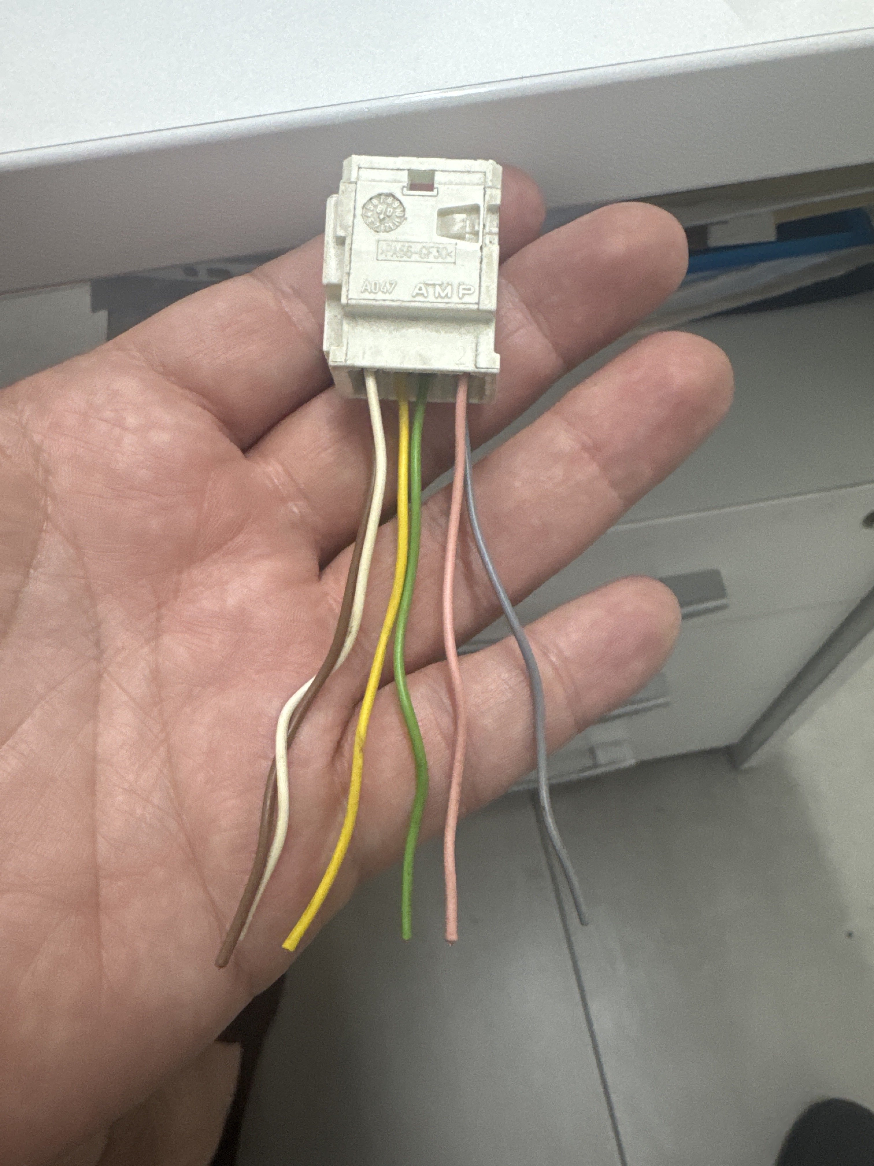

Hi, and thank you again for the great explanation.
I understand you've sold the car some time ago, but I’d appreciate your help if you’re able. I have a second series model, and unfortunately, being RHD, it still uses the same potentiometer as the first series. On LHD models, they updated the pedal, but not on ours.
When I purchased the cruise control kit, they provided the harness for the newer (LHD) pedal, so I had to source the older-style white connectors, just like you did, to adapt the harness.
Your description above is helpful, but I was wondering if you have a photo of how you wired the harness with the new connectors. Examining the harness I received, I can see that three of the wires appear to connect the two black connectors directly, creating a stable line without passing through the cruise control module. The other three spots on each connector connect to the module using the 5 wires coming out of the CC. On one side, you have red, brown and green, while on the other, white, yellow, and green, with the green appearing to be split into two, feeding into both connectors.
Based on the documentation from the manufacturer and examining the provided harness, I also understand that one of the two lines (Signal, VE+, and VE-) must be connected directly, for example, with 123 pinouts on each connector, to create a continuous loop that bypasses the cruise control module. This is how the signal is passed through natively.
That would leave the other 6 pinouts (3 on each connector) to allocate the remaining wires, Signal, VE+, and VE-, to interface with the cruise control. From the harness layout, it appears that the brown/yellow wires are intended for the low signal (which I assume corresponds to VE− on both connectors), while the red/white wires are designated for the high signal (VE+). That makes sense as a parallel tap into the pedal’s output.
However, the one point I’m stuck on is the Signal wire. From what I can see, it would logically connect to the two green wires in the harness. But the issue is that, according to the manufacturer’s documentation, the green wire appears to be a ground. And as it stands, there’s no wire available in the harness that seems to intercept or carry the actual Signal line from the pedal, which is confusing. Additionally, on the wiring diagram for the Cruise control, there are 5 wires, and I'm unsure why the green wire is split into two on the T harness.
If you have any clarity on this—or a photo showing how you arranged the connections—it would be massively helpful. Thanks again for your time and help!
I’m trying to figure out exactly how to connect everything to the new connectors and would appreciate any visual references or further clarification you might have. I've also attached a few pics for your reference. Thanks a lot for any input you would be able to provide.
