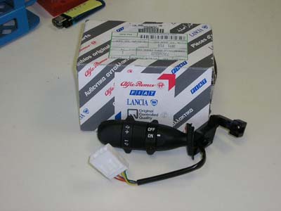

A Cruise Control Stick! These cannot be ordered separately from FIAT for the Stilo, so you’ll have to source one from a breakers yard for example. I got mine as part of a whole column stalk set off eBay so keep a lookout there too. You can get one for an Alfa Romeo 147; it shares the same fixings and connector, but you will have to adapt the steering shroud for it to fit properly. Part Number for this stalk is 735365522.
