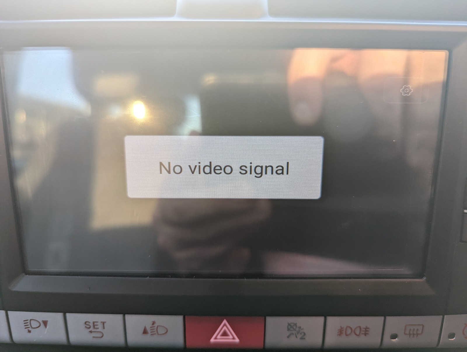

Reversing camera (Not being installed as this vehicle is so small, I feel it's extra work for something not needed) - It's to be noted - this unit comes with a camera which I believe could be used either as front or rear cam. The camera requires its own power source separate from the head unit - which made this a 'bridge too far' for me.

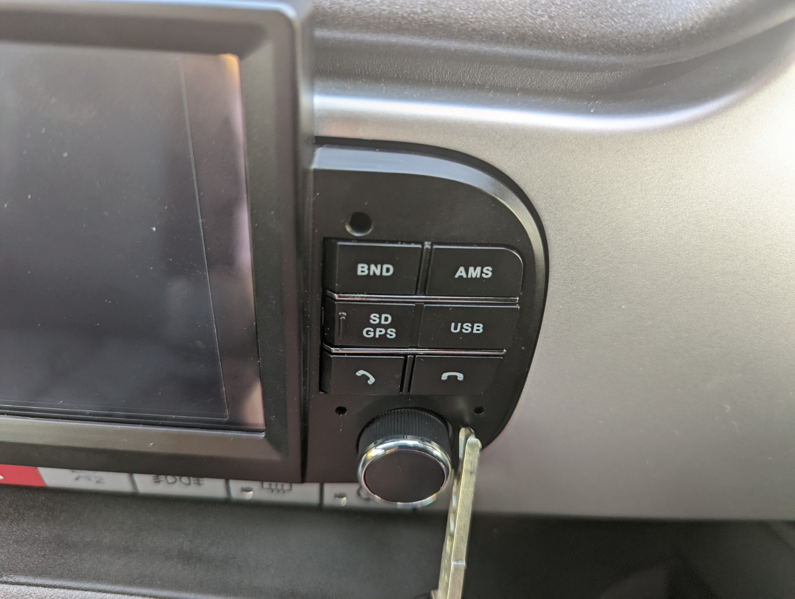

Removal of the fitted unit is by using two BBQ skewers (Mis-spent childhood) - inserting into the hole bypasses the locking security feature. A plastic wodgit is then used to gently pry the unit out. (Plastic wodgit set comes with this unit).

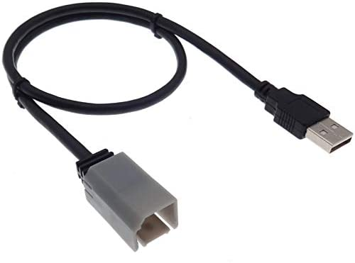

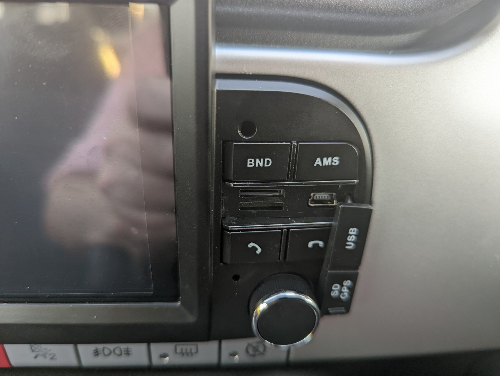

And the new loom connecting. The new unit has 2 USB inputs, one is intended for a DAB radio antenna, the other for USB / Phone. The input connections on this unit differ from the Fiat top dash USB (Grey cable connector on above picture). It could be adapted to fit the USB I think. This I may do at a later date.
It would be possible to use the unit with android / apple pair off - negating the need for the units GPS antenna, however, for standalone GPS, the unit needs it's antenna fitted. Disappointingly, the unit does not function with the built in handsfree microphone, so, the supplied microphone will have to be installed. Both of these are easily done by removing a bit of trim and chasing the cable to wherever you want the antenna / mic to be. The same would be required if installing the DAB antenna.

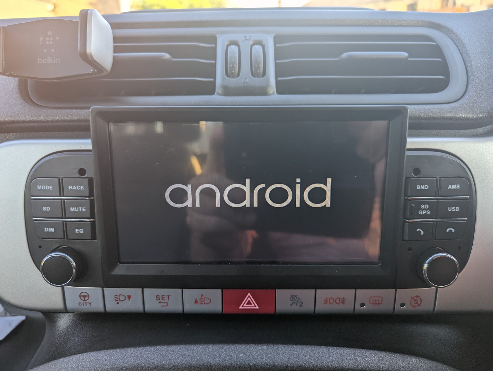

Once everything is installed, a test of the unit before seating it home is required. Everything seems to function, so it should be as easy as sliding it in. But of course, things have been too smooth so far, so, let's throw a spanner in the works.

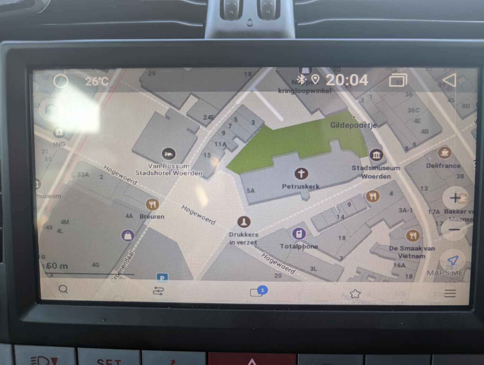

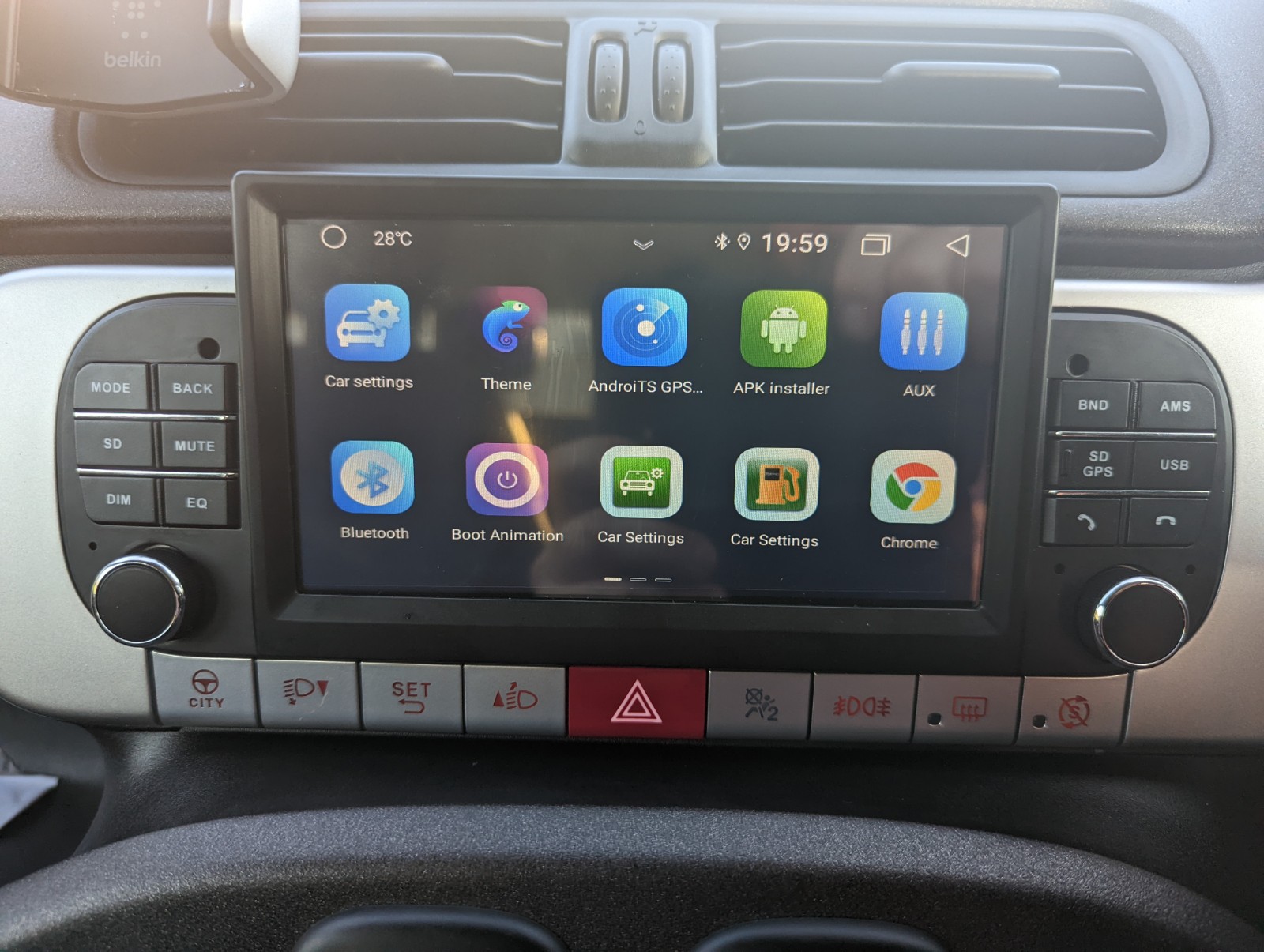

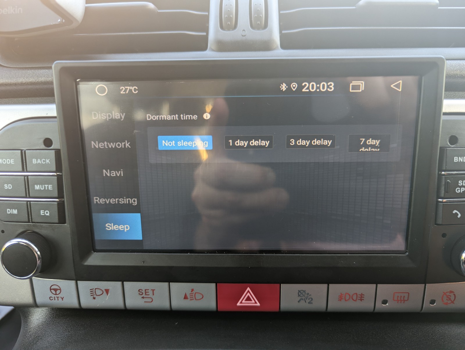

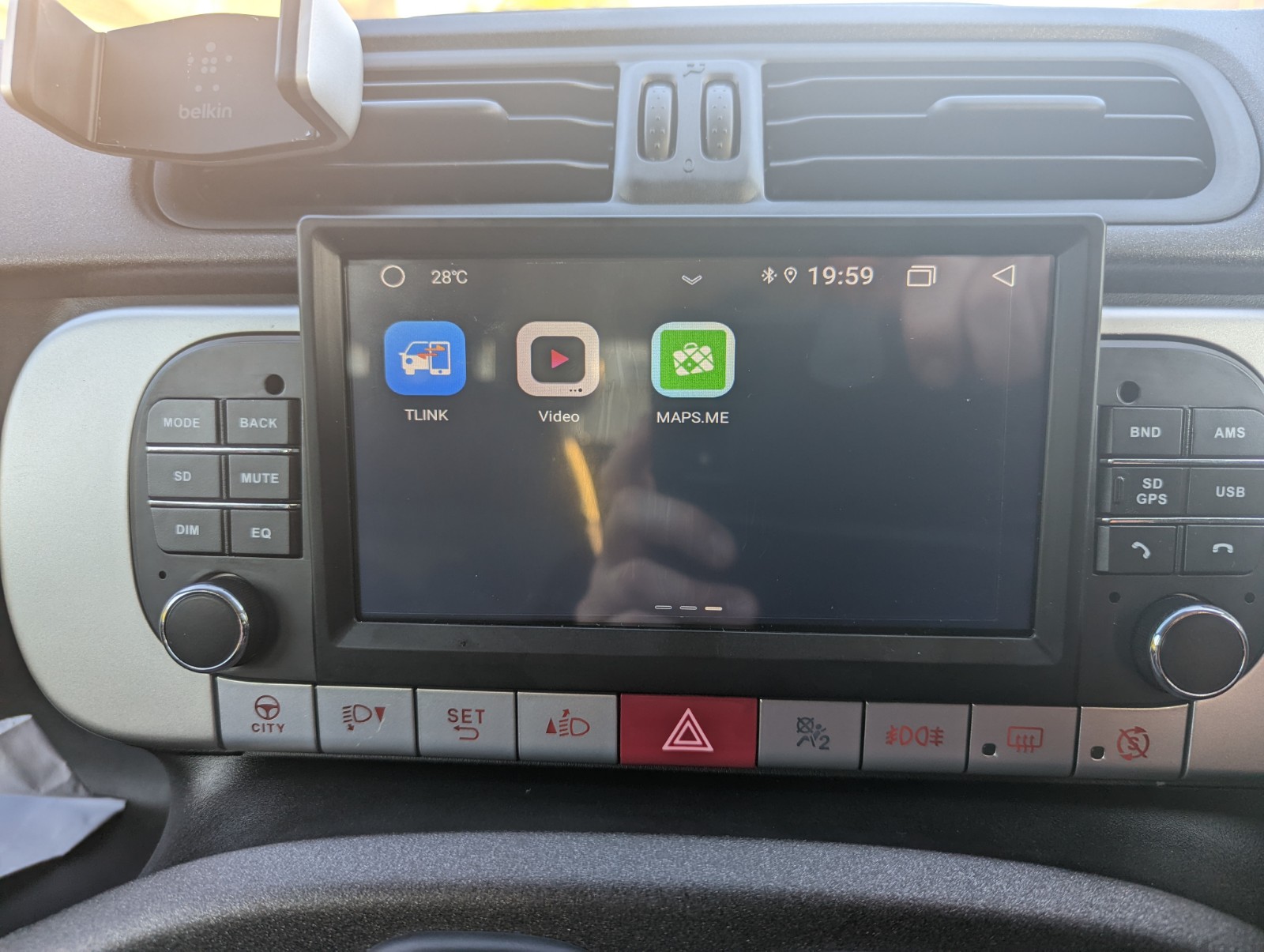

Powered up, it all works fine, however, it's not awesome out the box. A little computer know how is required to set it up, and it's best to think of this as a 'new phone' or 'new tablet', it requires personalisation and jiggery pokery.

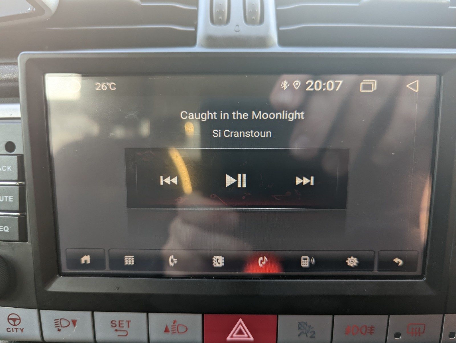

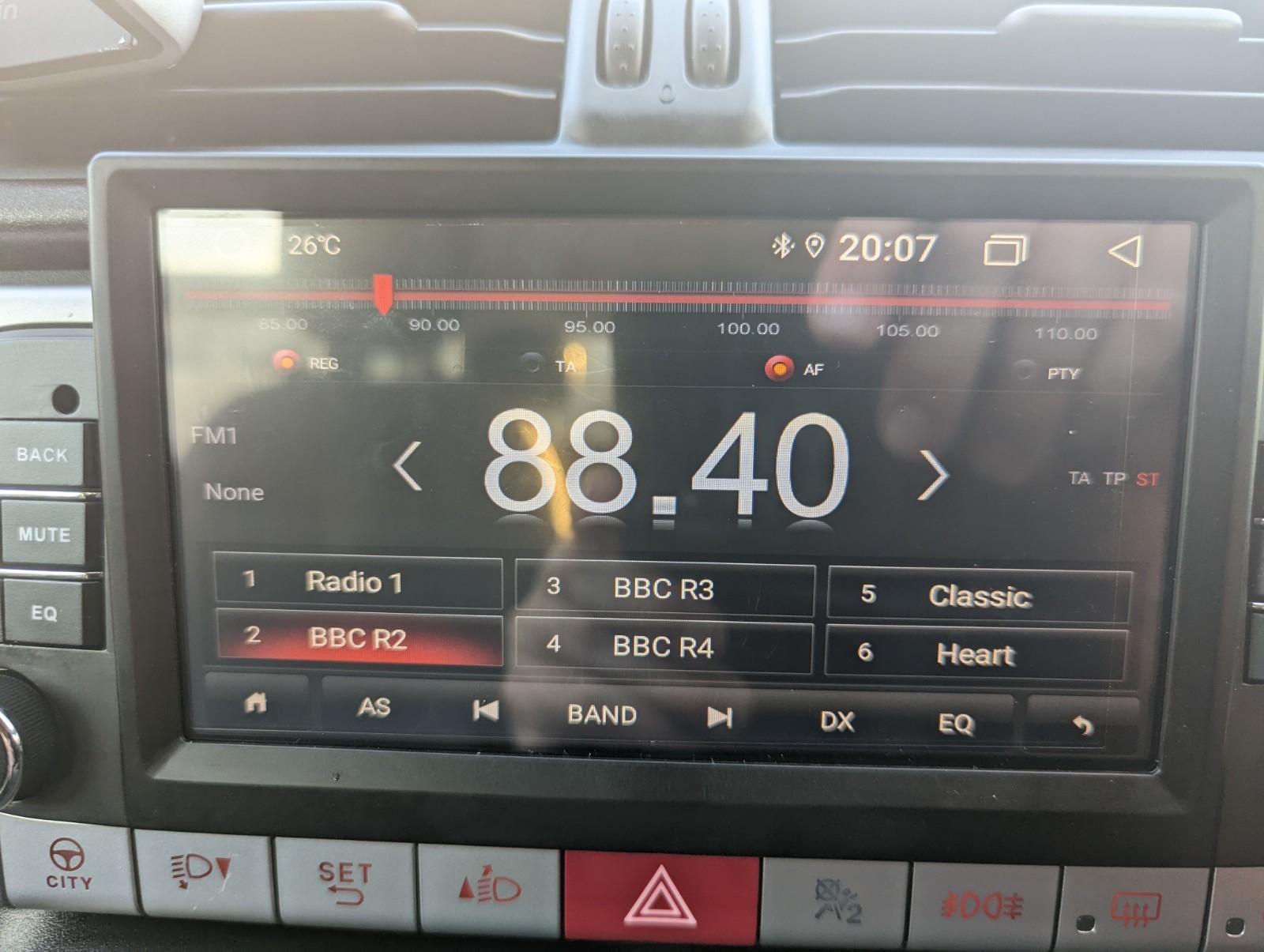

What I ABSOLUTELY love about this unit so far - the sound reproduction is AMAZING. I was considering changing speakers (I wrongly blamed these for poor sound). But, actually, the sound is superb from this unit. Much clearer, with a living tone. All parameters can be changed to taste, but central zero points are perfect. Bass and Treble work perfectly with exceptional variance in settings. Whatever audio chipset is being used in this - it's better than anything I've heard in a vehicle.
The radio - not idea what pulling power this has - but it's clearly receiving more stations than before, including overseas (French and Spanish) - and CLEARLY in FM stereo with RDS. Not sure if it's analogue skip due to the weather, and my slightly elevated position, but, one things for sure, no other car has had that radio power, especially with RDS and in Stereo.
Steering controls work seamlessly.
Handsfree is clearer sending and receiving voice signals.
The vehicle data is viewable on screen (Speed / Doors opened or closed etc), and it's possible to engage vehicle settings such as autolock, daylights etc.
This unit just works. I've not disconnected anything built in, not stripped wires, not had an electric shock (yet). Its processor handles working well, even with multiple apps open. I can well recommend this upgrade.

There's too much stuff available. This is a computer, not just a BT / Radio / GPS. In theory you could play angry birds on this thing. This could be an unnecessary distraction.
To get this right, the unit needs the settings played about with. Although, I'm kinda fine with this, a younger technically adaptive mind (not necessarily age, but mind) is needed.
