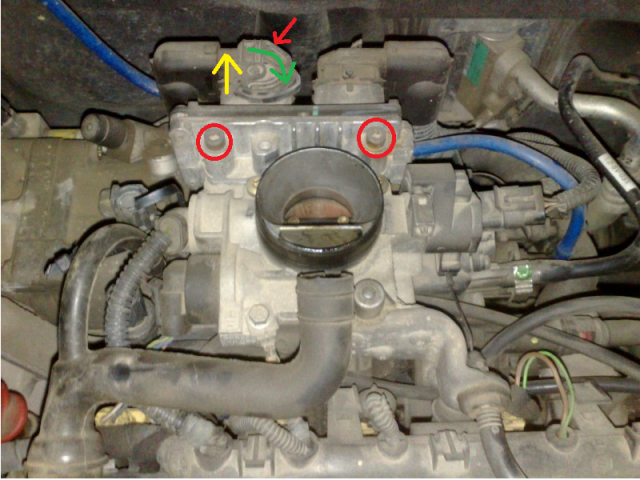

You mean measuring the two wires as close to the ECU as possible (as close as possible to the yellow arrow in the attached picture)?
Re: Crank, no start, no spark, no DTCs - Crank sensor?
I mean:
1 You test the old sensor and new sensor and determine you are able to demonstrate at least one of them is able to produce a signal
2. ***Then*** You remove the ECU plugs and trace which tiny connectors on the plugs has the signal that you have demonstrated the crankshaft sensor is able to produce.
You need a system here. A method.
