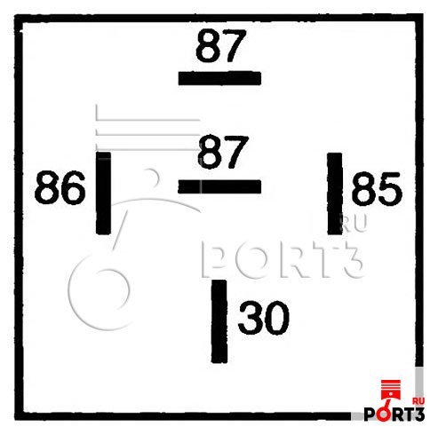

However I have traced the wires going to the fans back to a relay holder, with no relay in it. This is clearly the problem as to why the fans will not come on. But because there is no Relay there I dont know what sort of relay to buy to replace it and fix the problem. If anybody could help with this it would be greatly appreciated.

If its the same as the 90 model then itshould be like this:
