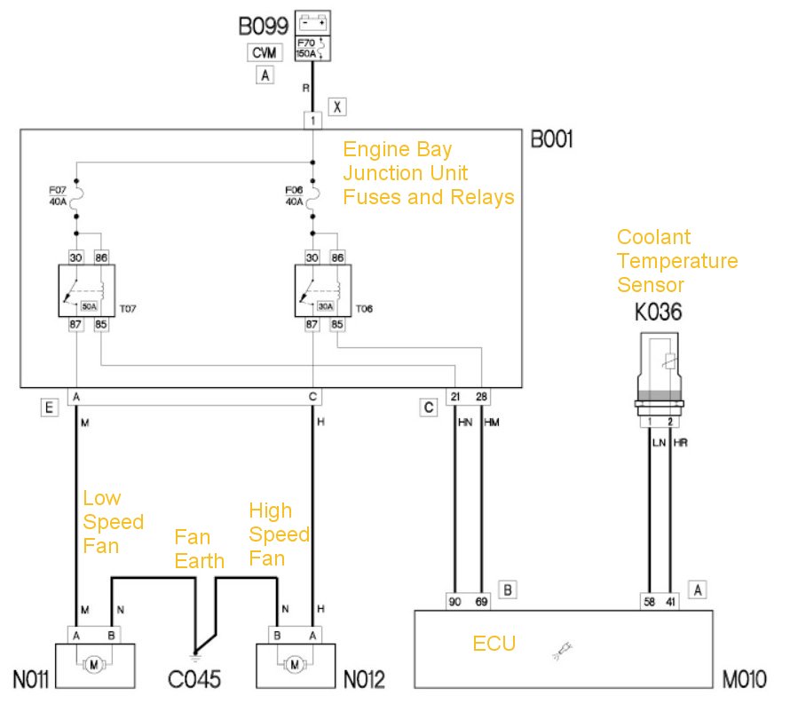

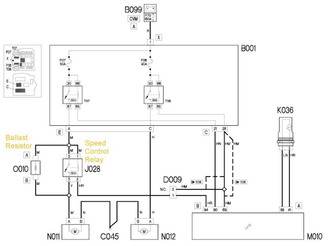

If you were stuck in a long traffic jam or slowly climbing a very long hill (i.e. not enough airflow from forward speed) the radiator cooling fan should switch on, so if the fan or its drive is faulty it could be the problem. The fan operation can be checked by a plug-in diagnostic tester. Normally the ECU will control the fans (via high current relays), depending on what it reads from the coolant temperature sensor. I attach schematics for the fans, these are slighly different if aircon is fitted.

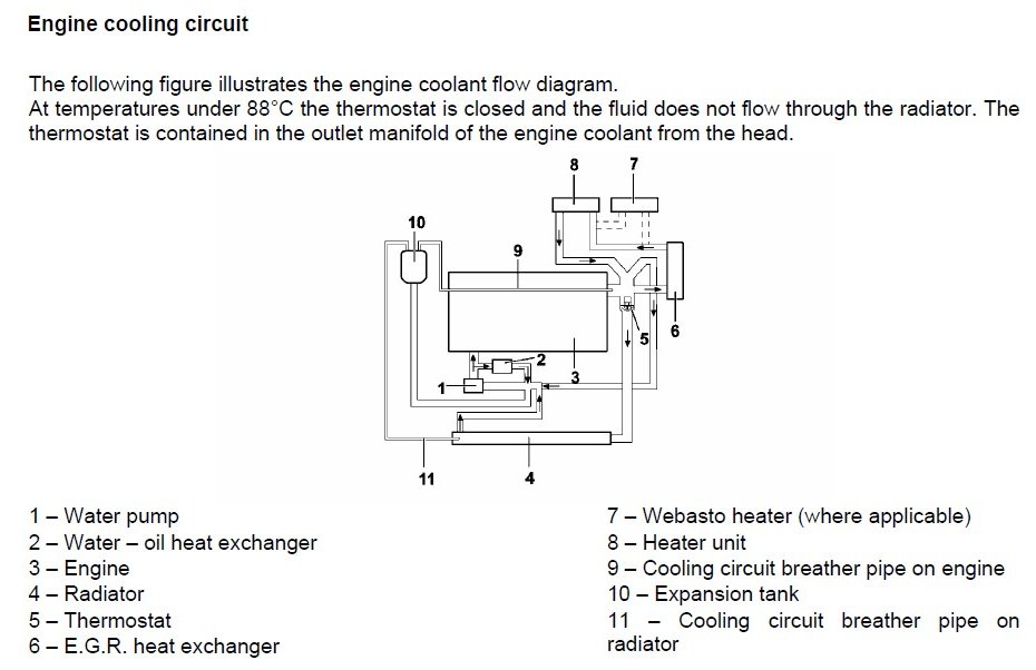

The diagrams are extracted from eLearn, which can be downloaded from the forum if you do a bit of digging. Sometimes I annotate them for extra clarity. There is another smaller document called the Training Academy, which was used to brief technicians before the new shape vans arrived in 2006. This has a diagram of the cooling circuit for the 2.2 engine (the older one, not the current ones) which I reproduce below. It should give you an idea. Be careful with this document as it was produced while the vans were still being designed, so has some anomalies.
