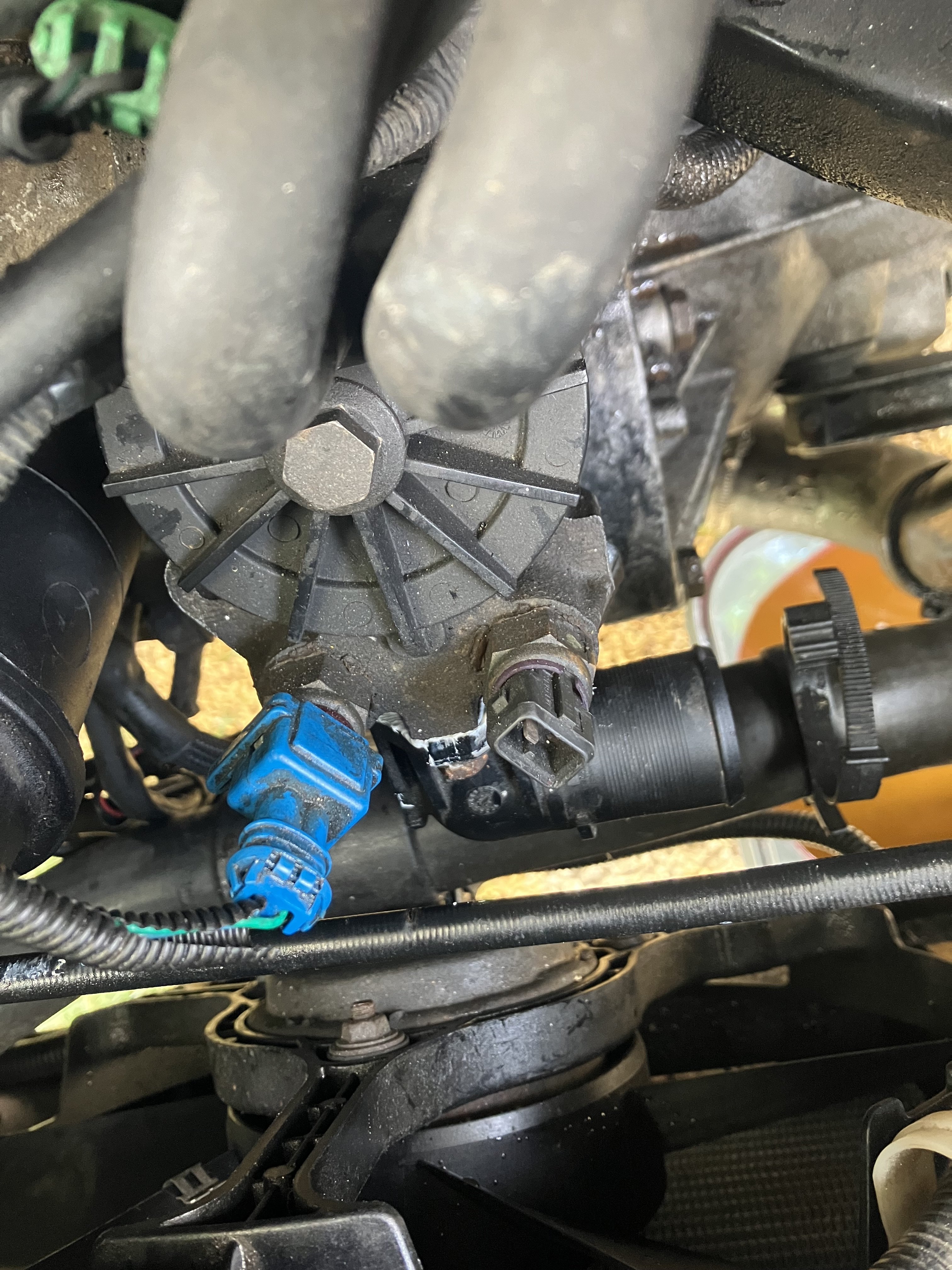

On a side note and anyone tell me what this terminal without a connection on it is for in attached photo I have seen a photo on the internet of one with a blanking cap on it so maybe not needed.
Any advise would be appreciated

As you must have a collection of thermostats by now, could you post a photo of one, so that we are clear as to what we are discussing? I am thinking about a three terminal device, fitted into the radiator header tank, which will be on the side with a crossflow radiator. As you suggest that fan has never worked correctly, is there any possibility of an incorrect connection at the connector? You still be able to apply a short to the connector and operate the fans, but in one scenario you would need to be over second fan cut in temp before any thing would happen via thermostat. This would require crossed wiring at the connector. I do not see how this could happen.

I begining to think that ther is some confusion here. We have wax thermostat for engine coolant system, as shown in photo post #20. and electrical thermostatic switch to control the fans. I expected that this latter device that was to be tested in hot water.
