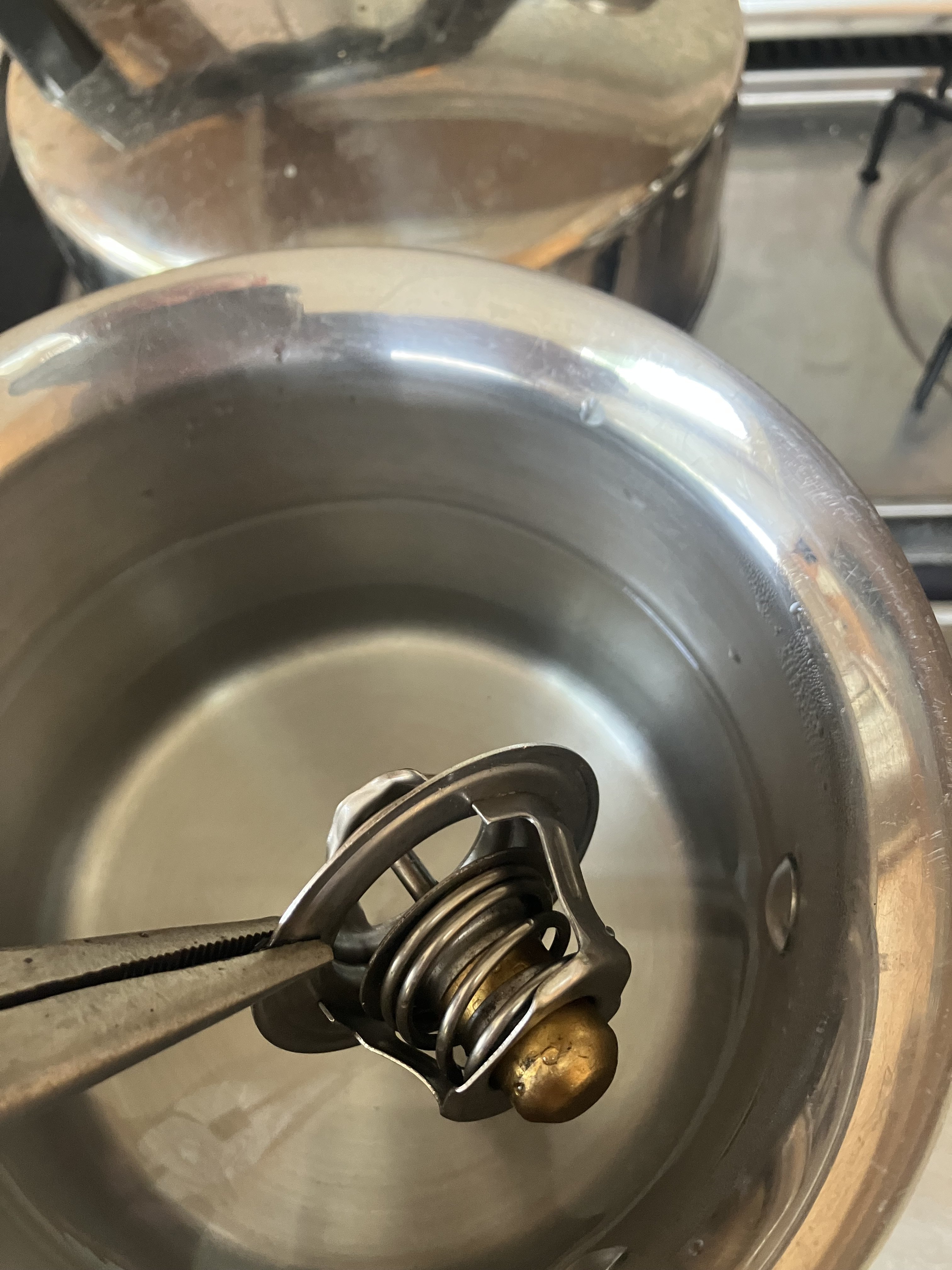

It was the new switch. So I will try with old tonight and check continuity firstdid you try that with old or new switch?
If it was new switch in boiling water whilst connected to vehicle wiring, with ignition on, would say the new switch is duff, as when you bridge contacts in vehicle connector the fans run.
It is a puzzle.
Heating in water while connected to vehicle wiring in situe could be the key here.
