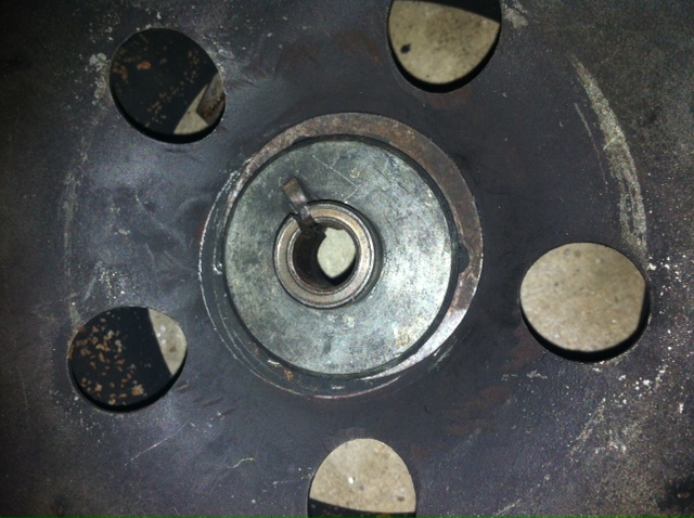

I've bought a new aluminium cooling fan which is next on the list to be installed. It seems that I need to re-use some of the central parts of the old fan that attach to the back of the generator.
What's the drill for getting these off the old fan? Looks like it's not just a simple tap with a hammer.

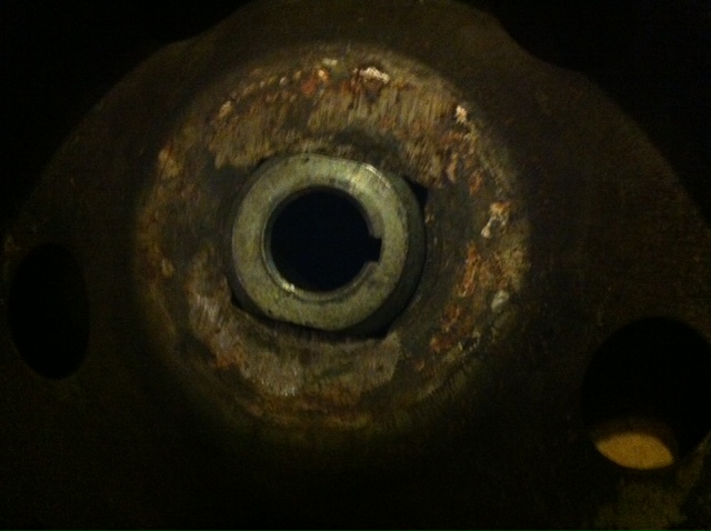

There seems to be a tab or notch on the central part of the fan that fits over the end of the generator. This acts as a lock, locking the parts in place that fit around the generator end. Photos attached. There's gotta be a technique or tool or force that is used to open this up.

I think I figured it out.
The tab doesn't lock the central part on as tightly as I expected. A bit of fiddly with a screwdriver and pliers and they came apart.

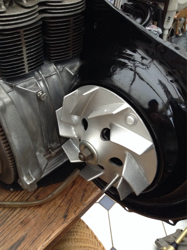

Fan upgrade in process. :slayer:

Main thing Tim, check that the new fan doesn't catch on the cowling when re-assembled. You don't want to fit and then have to remove the engine again. Apparently the idea is to use shim washers either side of the impeller where needed to provide clearance.

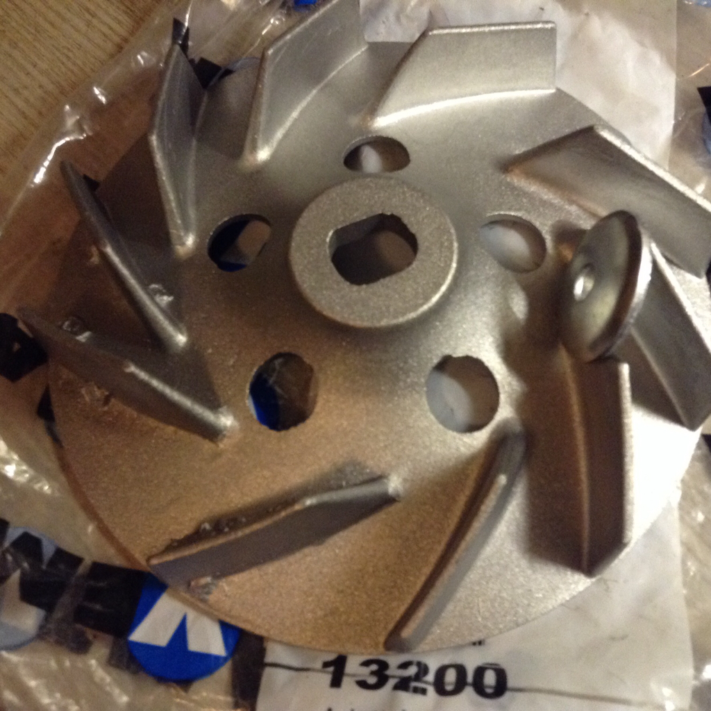

What is more of a problem is that the new aluminium fan is made of thicker material than the original. Once the central parts are in place and the fan is on, it doesn't leave enough on the shaft to get the nut on.

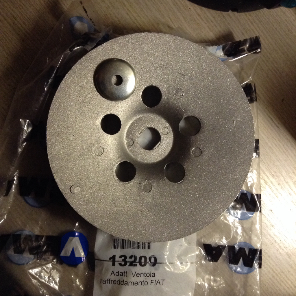

I fitted the alloy fan and it came with a large dished washer that compressed against the fan.ImageUploadedByFIAT Forum1419957274.346446.jpg
You have got me digging out bits now but no problem as I had another fan in my cupboard. Out of interest I weighed the alloy fan and an original steel one and the alloy fan is just 15 grams lighter. However when I first ventured into tuning I was unaware of the limitations of the original fan and I had one let go at about 6,500 rpm which meant with the standard fan belt drive the fan would have been close to 10,000 rpm. Parts of the fan actually pierced the steel cooling housing panels. The steel washer is actually dished like a core plug then flattens when tightened against the driving boss flange. For balancing purposes I did a little fettling as the castings are not perfect but I am running one at the moment and they seem to perform ok. There is another type of fan around but they seem quite rare. They have a steel core with a high density plastic fan cast on.ImageUploadedByFIAT Forum1419967375.870677.jpgImageUploadedByFIAT Forum1419967399.135678.jpg

That's helpful, thanks for the pictures.
What I was doing wrong was trying to use the old domed centre spacer. I forgot there was a new one that's not so domed, that came with the fan. :bang:
Seems to fit ok now.
