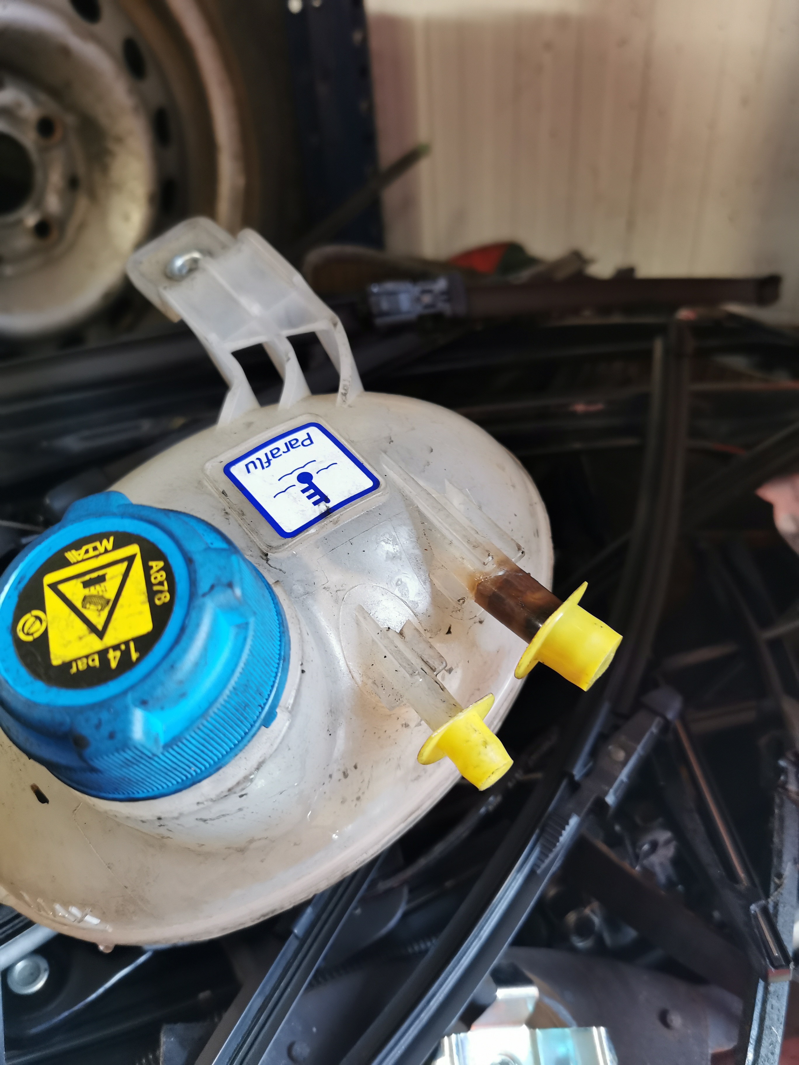

Persistent coolant leak. Took it to a great local mechanic. Coolant pump leaking and was replaced. This then led to an issue with the coolant tank leaking (see image). New coolant reservoir. Now it appears that there is coolant leaking by the oil cooler. Hopefully third time the charm. The reservoir was an interesting one. One of the plastic inlets was cracked, possibly someone leant on it and it cracked.
