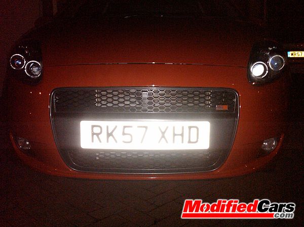

Alright ppl,
Just a random question I am strongly considering lowering my Punto by around 40mm both front and rear for a lower ride height and also for appearance purposes. If any of you have had your Puntos lowered is there any inside vibrations or rattling for example like the rear parcel shelf rattles or side plastic rattles? I was wondering because I f***ing hate it when that happens and with the car being lowered surely it would make it more responsive to un-even road etc making the inside compartment rattle? Does this happen?
