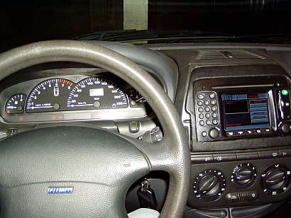

The lybra has two versions of the radio, the one above wich has radio and trip computer , and the top one wich features GPS a some other goodies:
pic :
The internals of this radio are very alike with the sat navs featured on the Alfa 147 and Stilo.
Thing is, for the 1.6 litre versions(Marea,Lybra,147,Stilo), the ecu is suposed to be the same so the connection to get the information should be the same. There is probably some cables on the lybra/Stilo/147 that doesn't exist on the marea, but they should be "portable" from one to the other :p

I think tough that pluging a stilo / Punto trip computer to the ECU would be quite simple if someone could take a peek at a similar engine Stilo/Lybra. If the ECU is the same, then the plug must be there :p

Can you see what type of plug is used on the lybra in order for the radio to work? Also, is the GPS antenna on the lybra on the radio itselft or located in the car?
