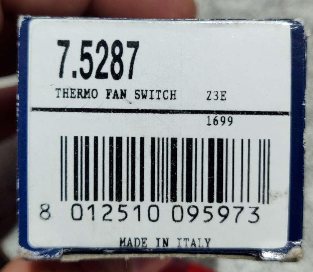

The Cinque radiator switch makes me very uncomfortable because it's mounted on the cold outlet of the radiator (where the water get's back into the engine after cooling down) and still the switch only fires the Fan at 97ºC and shut off at 92ºC.
Changing this usually means to use a universal type switch.
But after some catalogue browsing i've found IVECO OEM 98435734 valve, that uses the correct oval connection and starts the fan at 85ºC down to 76ºC (remember this is the colder side of the radiator, has nothing to do with 87ºC thermostat opening).
I've used a Facet 7.5287 and I'm very happy now as the temperature in traffic only dials 1/2 millimeters above the 90ºC mark.
Also checked the ECU maps and anything above 70ºC doesn't bring any fuel or ignition correction so no fuel economy issues with running a bit colder.
I've always been convinced these (and most modern cars) run very hot just for emissions sake.
