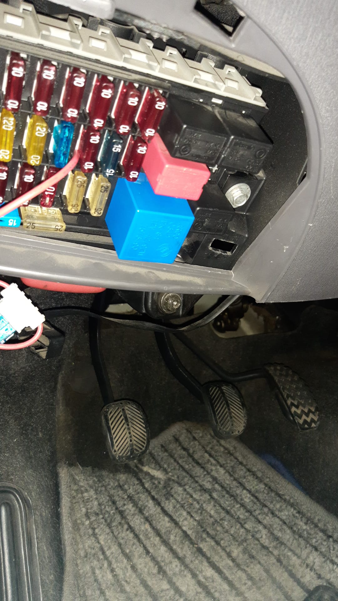

Thanks for the advice, checked the fan fuse inside. all ok The weird thing is that when you turn on the lights, it turns on the air conditioning. Fan speeds nothing. It happened yesterday, in the morning it worked perfectly, I park the car and when I use it again the fault has already come. I say this because nothing has been touched. I've tried another battery but no. Button panels I have tried others that I have, nothing. Checked connections. I would need to look at the fan motor, but what about the problem of other accessories at the same time?

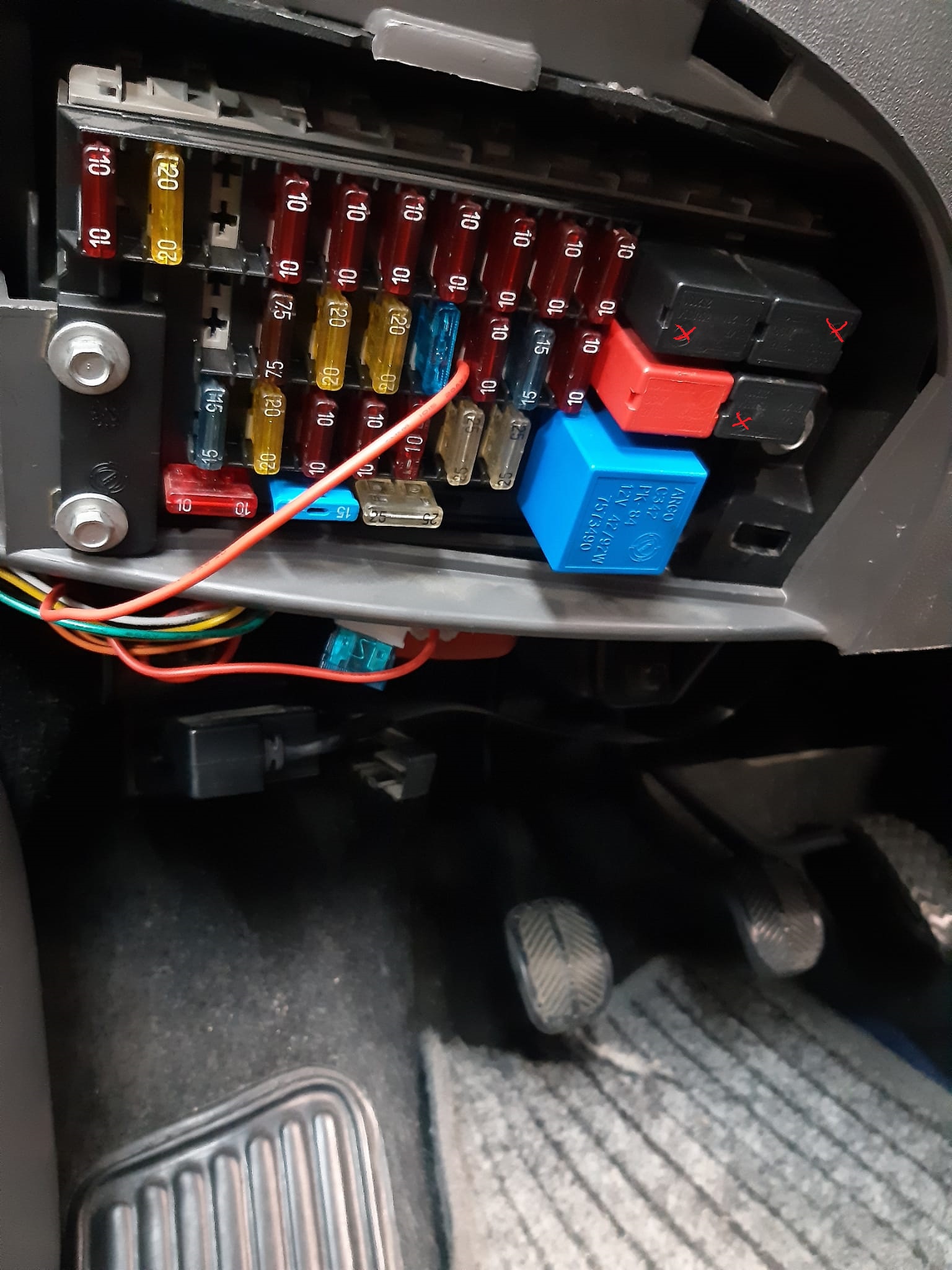

Have you 100% checked all the fuses uner the interior dashboard?
Is there water in the car somehow? Strange things are happening?
Have you 100% checked all the fuses uner the interior dashboard? Fuse number 24 (25 AMP)

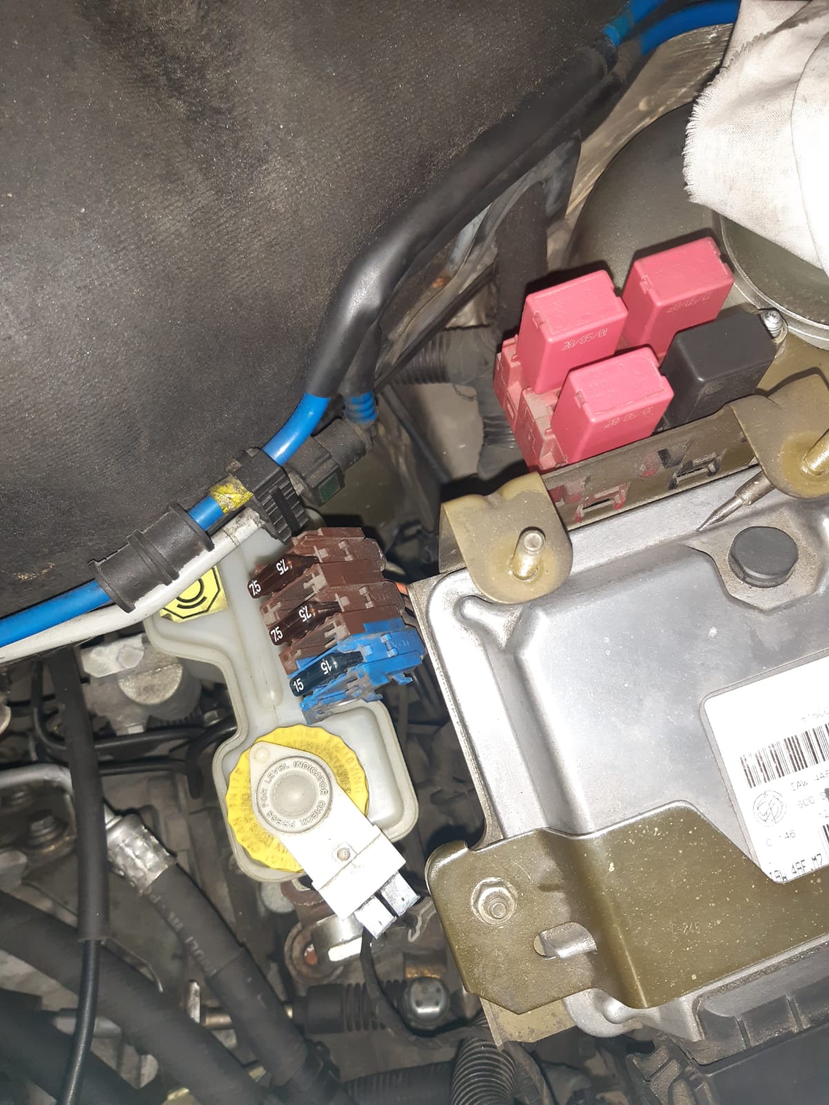

The three in the photo above are imobiliser and fuel injection. The fuse box behind the battery has climate control (air con) and this has been known to get water in it.

The relays should click when activated. Try removeing them and plugging them back in to check the contacts are good.

Also there is a relay for the windows R5:
ok, thanks for the link, we will review the relay n5!
I will comment if I have solved it.
Looking at the photo and diagram, I think I have already seen the fault. I have put the nR5 relay where the R 4 goes (Fog lights that I don't have). When I see the car, I change it.
fixed up. The R5 was placed in the place of the R4. When I checked for the indoor fan, I put it wrong. Thanks for the help.
