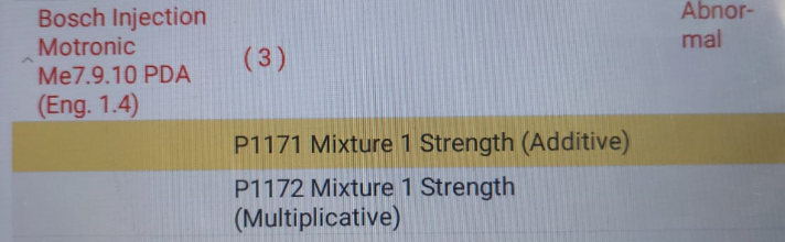

Hi,
I had replaced thermostat for coolant leak with coolant sensor. No change in starting issue. During scanning found Mixture related stored DTC's P1171, P1172. These are stored DTC's not a permanent one. There is a possibility for a defective lambda sensor. However it is not clear why only during starting the issue is faced if at all the lambda sensor is faulty. Need to find another car for swapping the suspected parts to establish the root cause.
