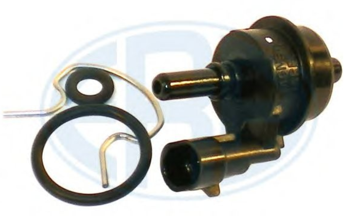

:worship:Finaly i solve it
I change the fuel ramp,with al injectors and now she start ok.
That because the former owner dont drive this car, and car stay much time
not started.
