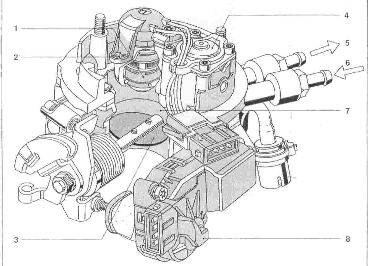

Air temperature sensor - item 2.
Bosch Mono Jetronic does not have an airflow sensor.
Do you have full shematics on mono-jetronic sistem on my Tipo? I would realy like to know, how it works. Is that Air temp sensor removable and how much does it cost ?
