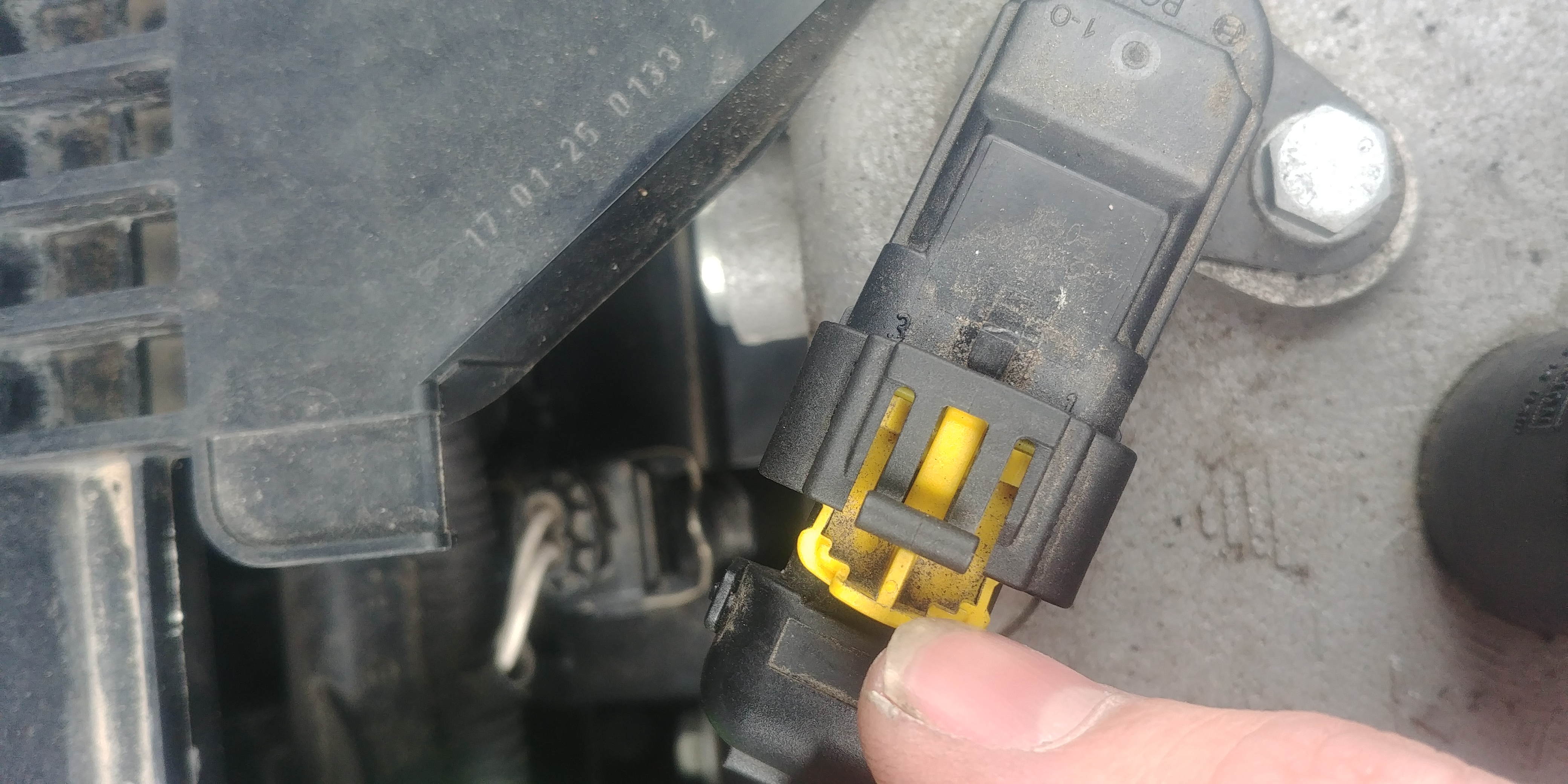

1.4 16v?
If so there's is one at least on some versions on top of the rocker cover in the centre maybe not be on the older engine's however
https://www.fiatforum.com/attachment.php?attachmentid=200753&stc=1&d=1559742369
