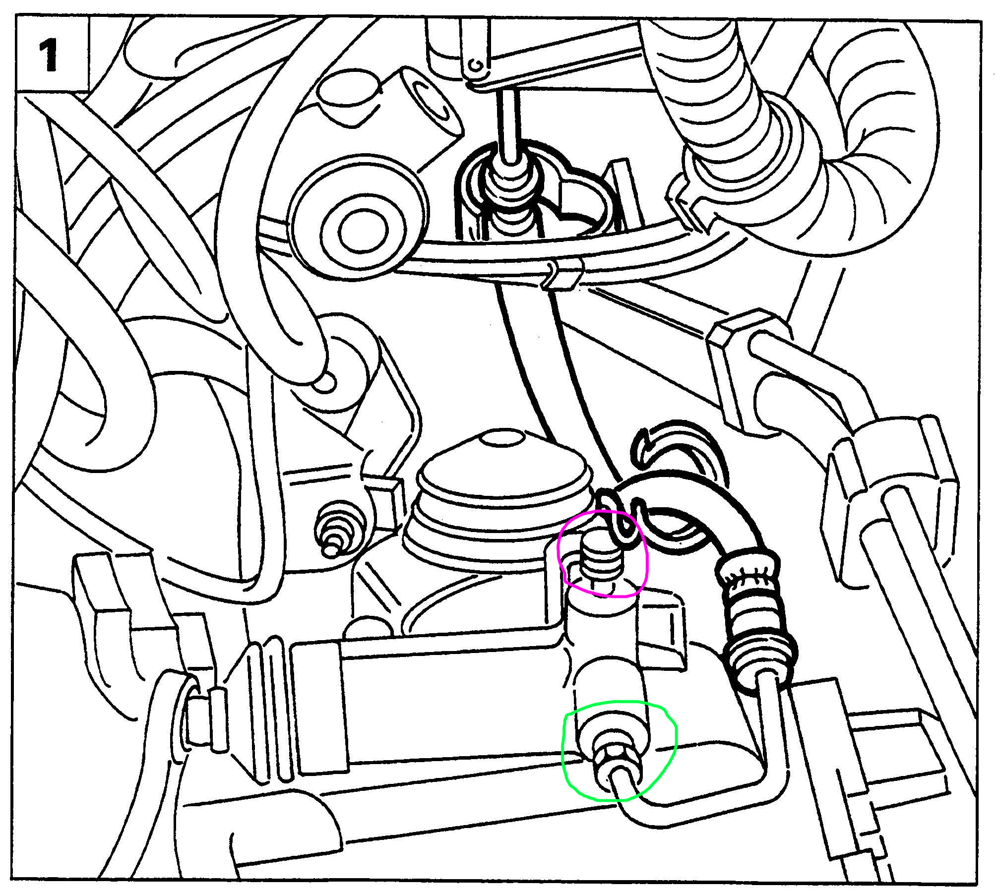

Hi! i'm replacing the slave cylinder.. the old one has a metal pipe connected with a nut on one side and a black hose on other side with a rubber wheelie thingy on it which connects to another metal pipe . Im asking how i can separate the rubber hose in order to bleed the brake fluid.... (hope this makes sense)... :bang:
I think he means the flexi hose into the cylinder.
You should be able to disconnect it at the join with the solid brake hose, then the cylinder comes out with the hose. You can then get the hose off easier or replace it.
Thanks Hellcat.. i've tried pulling flexihose but can't separate it from flexipipe unless im doing it wrong.. can i get a replacement flexihose and just cut this one off if last resort..
There is a bleed nipple under a small rubber cap. I think it is an 8mm nut.
Hi! sorry as im a complete novice at this.... this is what im talking about..

Pink is the bleed nipple If you pop the rubber cover off you can attach a bleed pipe.
Green is the clutch pipe you can undo this to remove the cylinder.
thanks for that phew.... u saved me sabotaging the flexihose pipe.. where can i get a decent cheap bleeding kit or hose...

finally sorted my clutch today.. thank very much guys for the help and advice after numerous one man band attempts!!! i had been driving for a couple month ignores the (!) sign on dash whilst my brake fluid was low and never checked it until a few days ago when it wont go into gear.. i didn't have to change a new slave cylinder in the end.. if anyone is trying to bleed the clutch get someone to help u pump clutch pedal several times not just once!! whilst you open bleed nipple (half a turn should do) then once the excess air is out.. they should keep pedal pressed down flat whilst you tighten back the bleed nipple then they can release the pedal once you are done tightened.. hope some1 will find this helpful (y):D:p
