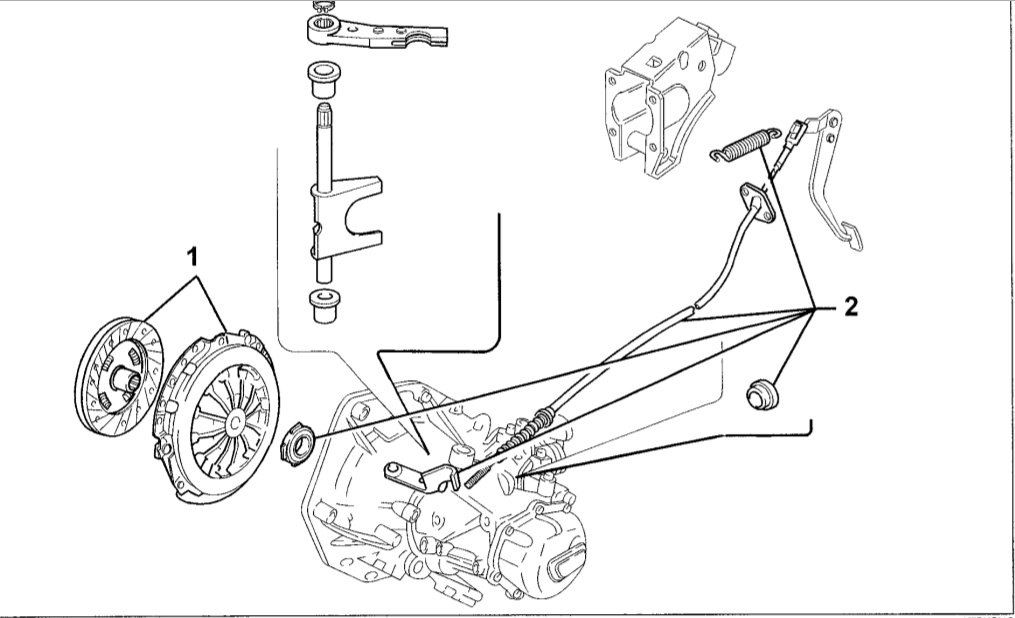

could anyone tell me which way round my new clutch plate needs to go in my fiat seicento, ? raised side to the flywheel , or flush side to flywheel ,i never looked when i removed the old one ,,,, what a wally ,,,,
cheers dave , no flywheel side marked on clutch plate , ps nice rabbit !!!!!!!!
Thread revival time. I think I've found out what I've done wrong with my clutch. Looking at the manual the sporting clutch plate fits with the raised side towards the flywheel, and the 899 fits the other way round. Is that right?
The pic is the sporting assembly.
