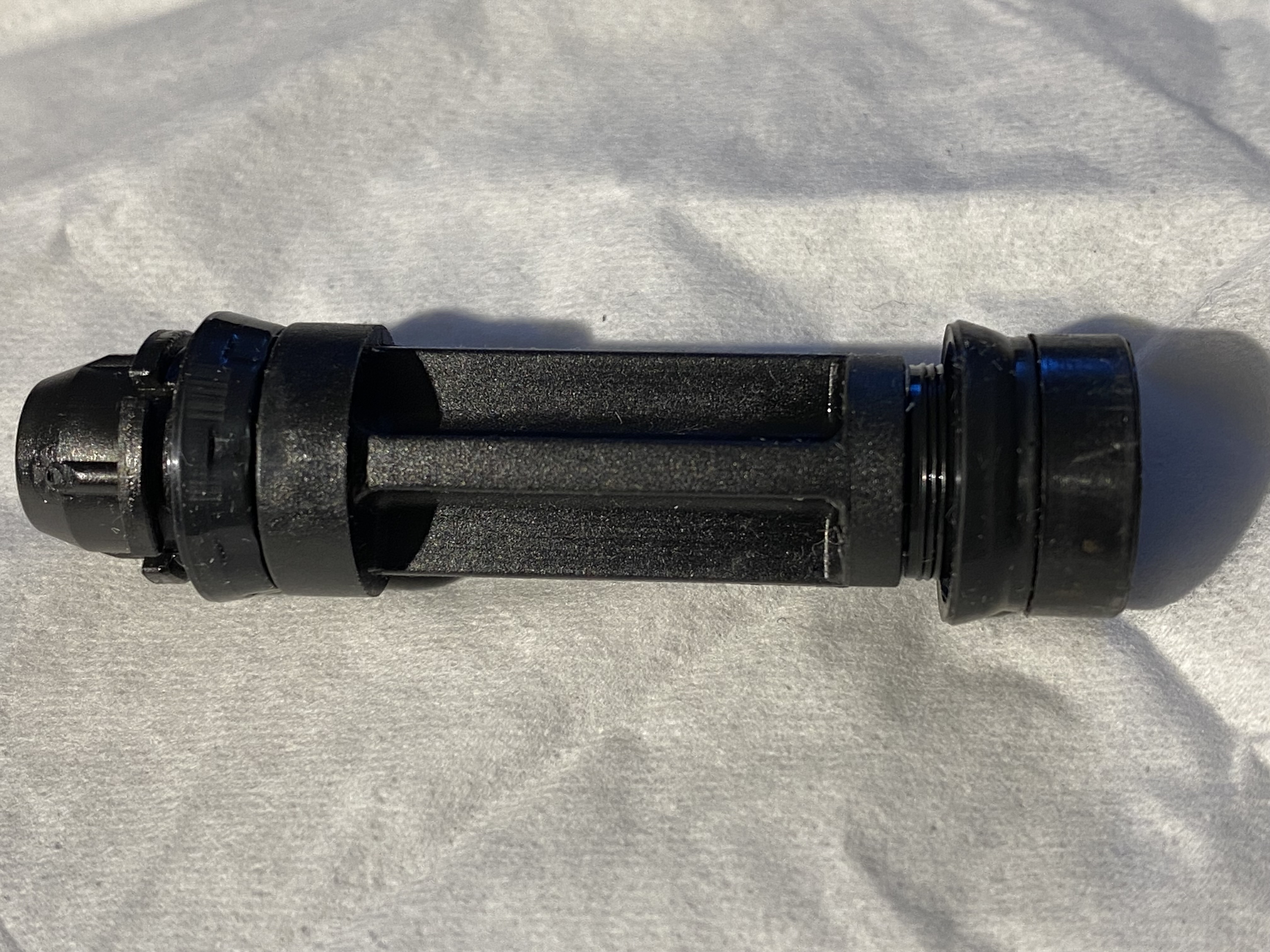

Mine has graunched into first and reverse since I've had it and wonder whether it's the master cylinder? I had always assumed the springs on the clutch had gone unspringy, especially as the pedal is quite hard.
How easy is it to replace the seals on the master?
Easy job if you can get the seals. Best thing to do is buy a complete master cylinder and swap over the internals, 5 minute job!!
I found the air was sitting in the top of the master cylinder, so as a stop gap and test, remove the piston from the master cylinder and top it up from there with brake fluid. I used a syringe from a kids paracetamol suspension to get the oil in the small opening, you can also measure how much your putting in that way. If this temporarily cures it then more likely the air is getting in from the master cylinder
DOT4 Dispener 😄
Piston that needs changing or two seals on piston need changing
