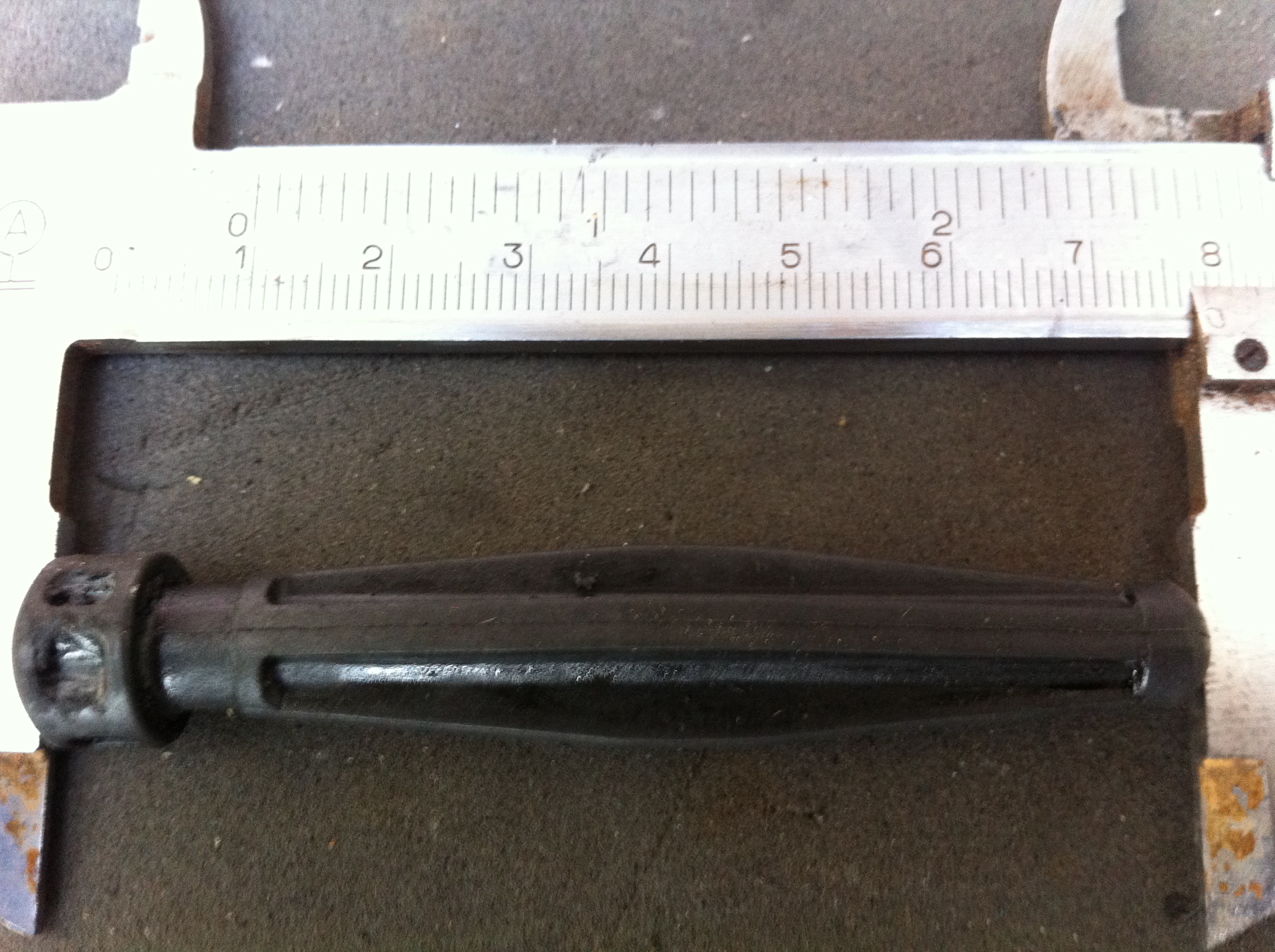

Hi,
I just pulled the push rod out of the 'plastic' slave cylinder and
  • 1. it's plastic as well
  • 2. appears to be bent
  • 3. appears to be compressed
  • 4. appears to have a missing cap (possibly rubber)
  • 5. measures 77.8mm (using very-nears)
So, I made a new on from 8mm fiberglass rod about 79mm long and I can change gears with motor running now.
Can someone measure a new/old metal pushrod for me? please...
john

Hi,
john
