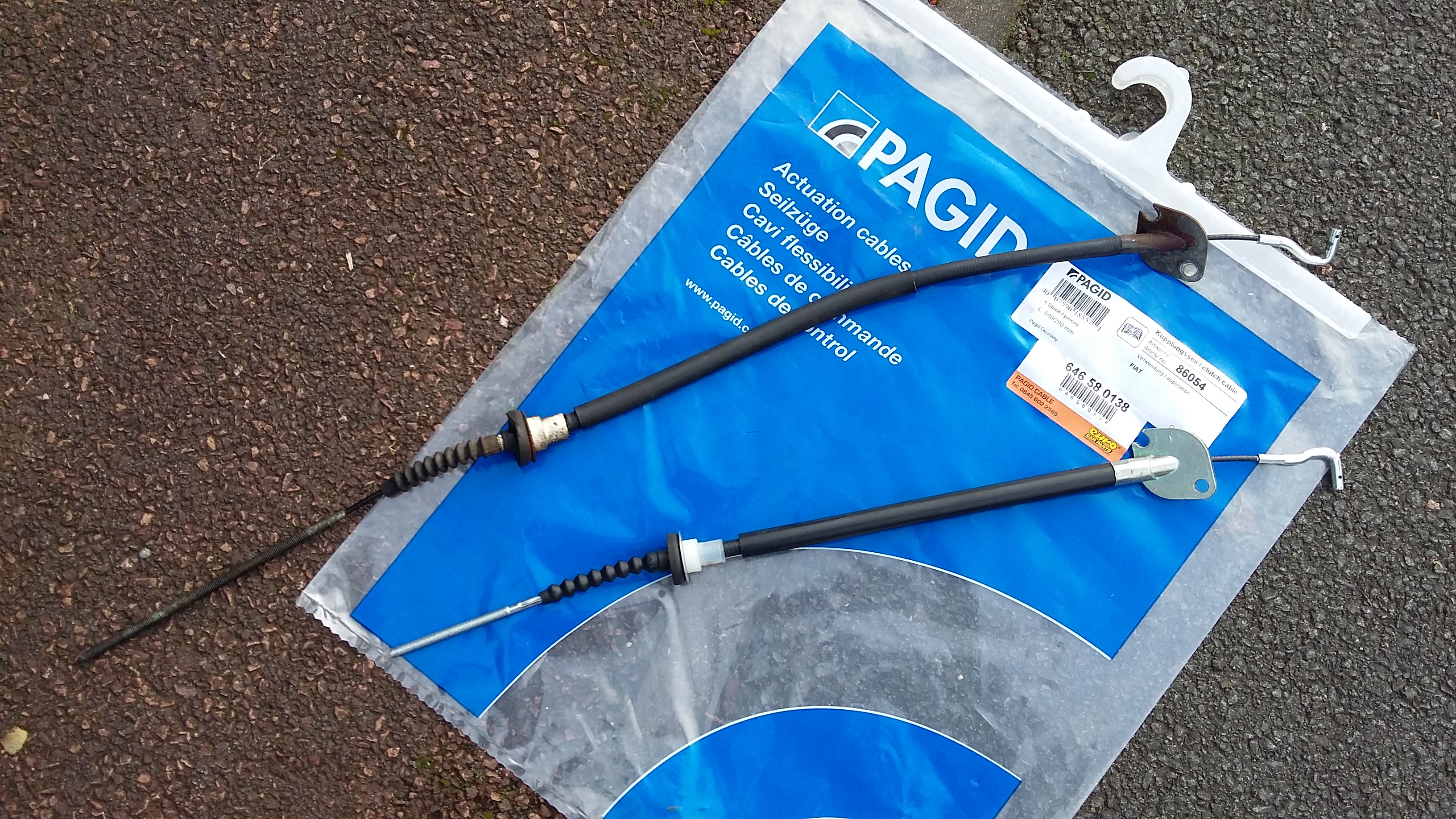

So i ordered up a new cable and it arrived the next day, champion.
Took the old one off and ready to fit the new one.
Bugger.
:bang: Luckily i have a Euro parts in the town and i guess they will exchange it for the correct one.
Fitted new cable. I had forgotten just how fiddly it was to locate the L shaped end into the plastic pivot.
Good points.. Nice light clutch again,
Bad points.. Ridiculous location, and you need to be a Russian gymnast to fit it
Easiness of job 5/10
