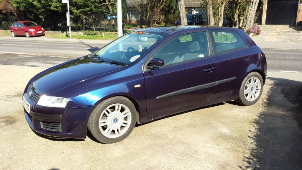

Hey all i have a weird clunking noise that sounds like its from my suspension when i go over small bumps and it really bugs me i was curious to wether anyone has any ideas as to what it could be my car is lowered on springs but still stock shocks cheers also i dunno if i should spray my wheels black or white what do people think ?

as for painting the wheels it really depends on your cars colour but I would probably pick a decent black colour scheme, perhaps a very dark gun metal grey.
