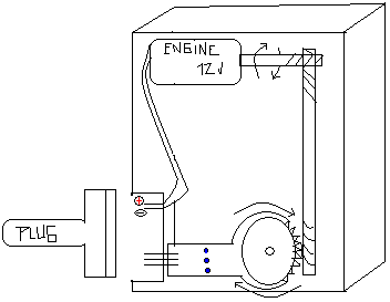

Now, if you have time and you are curious or good about electrical stuff, you can open your module.
I'll sketch what's inside.
https://www.fiatforum.com/gallery/data/2631/bosch_engine.PNG
Sorry for the bad draw, made it fast on mspaint :p
If you put 12v on the two pins (pos/neg) the engine will go clockwise or anti clockwise, depending of course on the polarity you're juicing the engine.
If the engine its ok it will go from top to top without problems.
The problem of my box is, I think, on the 3 wires lefts. The car keeps feeding the engine even if it was totaly closed or open.
That made the gears start stressing and making some grinding noise.
I think that those 3 pins below are sending the car the signal off the engine position, like if you select 22ºCelsius, when the engine rotates the gears inside and make that position, those 3 pins send the signal to shut off the juice. Mine must be broken, so it is always juicing.
Correct me if I'm wrong someone.
Ok guys, my text is getting boring :p If you need some help please let me know. ;)
Regards
Fantastic drawing. One of the great things with Windows is Paint. :D

Hey Morty, yes, if you have dual zone, then you will have two of these things :D
If you do the procedure you will end up with your side (the one with the problem) blowing ambient temperature air, with this I mean, direct air from the exterior. If you're in summer, the air will be hot anyway, you have to turn AC on of course, but on winter, the vent will blow ONLY cold air from outside, this is because you are closing the hot air entrance. The passenger side will continue to do the proper function, cold and hot, you are not going to do anything on the passenger side, only on your. The only disadvantage I can find is on winter, you got to close your side vents when trying to warm the car interior :p
