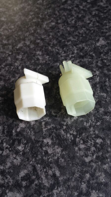

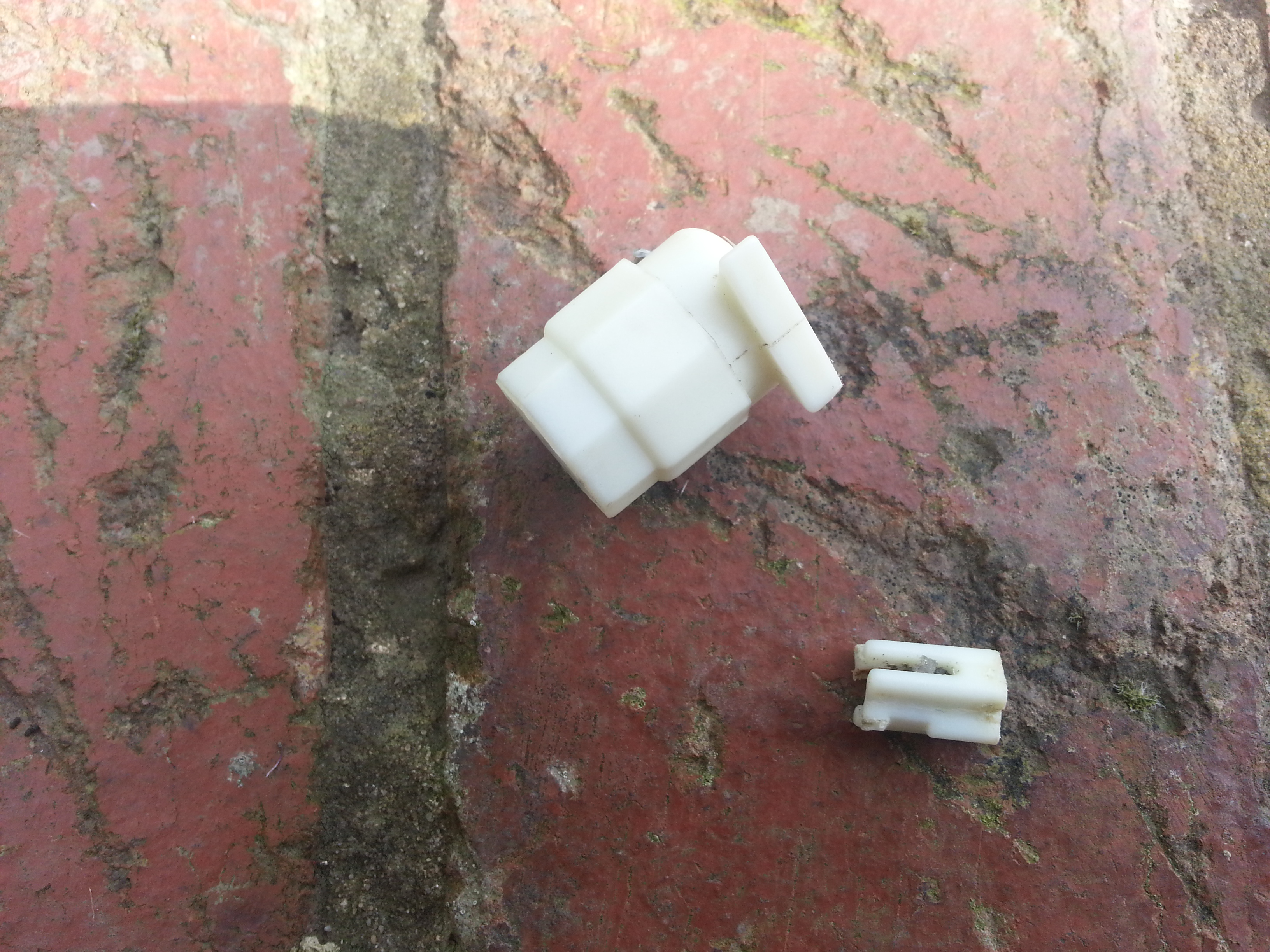

I am new here and I want to share a 'ghetto hack' I did today. The actuator on my climatronic got broken, so I've tried to fix it. I didn't have much time to test, but in the first run it worked. I'm not an expert in mechanics so I don't know how long this fix holds. Judge for yourself:
And the final result
Regards
zefo
i wouldnt do this hack the whole point of the clips is to break off in case there is a malfunction. it would be alot worse if this clip didnt break and the brute of the force goes to the flap inside breaking it, thus you would have to open the whole a/c unit to repair it. the clips arent expensive better to change them than do this.
Stilatos, you are definitely right. I have already ordered two new actuators (46723329), they will hopefully arrive in few days so I can replace them. But after getting a cold yesterday because the heating didn't worked, I had to fix the issue really fast, therefor I did the hack.

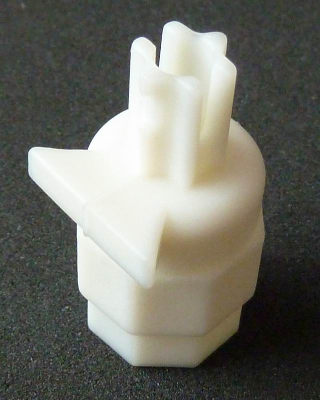

Hello everyone, yesterday I hooked up my car to FIAT ECUscan because on the driver seat the climate control is blowing only cold air and can't be adjusted no matter how high I set the temperature. The errors that came up were for the left side mixer actuator and for the feet vent actuator, oh and a sensor I guess it's the air pollution sensor, correct me if I'm wrong. I went through the whole topic atleast twice, but I didn't quite clearly understood which which number is the correct for the air mixer and which is for the feet vent flap. So if I'm right for the feet vent I have to order (46723329 - distribution) and for air mixture actuator (46723328 - misc.) Would you reccomend ordering the white adaptor levers too, the ones they connect actuators to cog wheels and are they one per order or a set per order?

Just buy the part from Fiat for less than £9, much easier. The old broken piece does come out although you may have to split it to make it easier to come out.

That is not a good idea at all. What if the motor/actuator is malfunctioning somehow (which can be the reason the gear snapped at the first place) and just going on without stopping where it should. This might cause a fuse to blow constantly, or break the flap itself inside the airducts. That will be a dash removal job.
