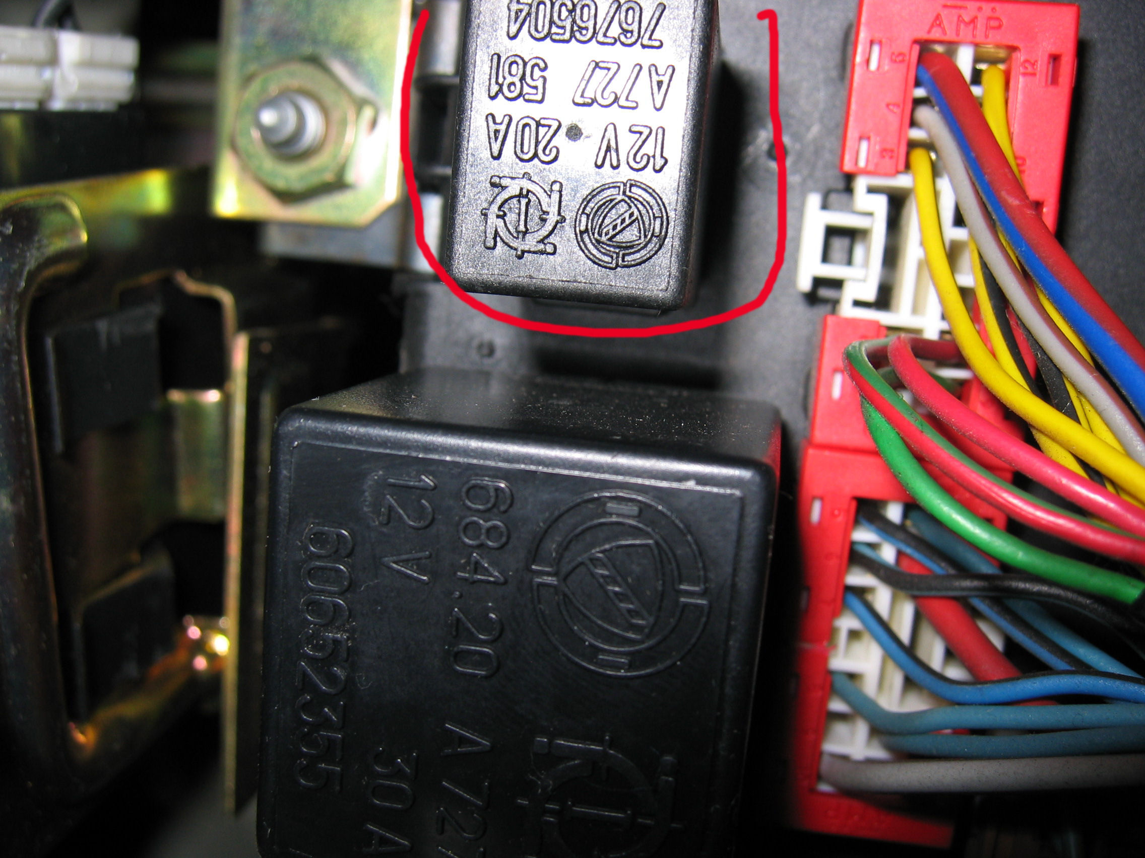

A friend just got a 00 fiat bravo, Theres a good few problems with it
Horn not working, Rear wipers/rear water not working and the annoying one is the constant clicking when driving.
If you lean on the wheel at all it just ticks very fast, also when you press in the horn it ticks and the horn doesnt work.
So i checked the fuses to the right side under the steering wheel and all is good but when i opened the panel the ticking was louder so i stuck my head under where the pedals are and followed the noise and found the ****er. You can even feel the thing ticking like mad!
I attached photos of it and found someone else on the forum saying it was the compressor relay for the A/C but the A/C is working fine the number on the ticking box thing is 12V 20A A727 581 7676504
So what the hell is this thing, how do i remove it? does it just pull out and anyone know why it would be clicking and do you think it will fix the horn at the same time?
Thanks to anyone for any information you can give, im a complete beginner when it comes to fixing cars so sorry if this is a simple question.
Paul
oh yea this is located at the back of the fuse box to the right hand bottom corner of the steering wheel. (fuse box A on the manual)

sounds like the stalk assembly needs changing. you can safely pull the relay out but a clicking relay is rarely faulty, when they break they stop clicking, if they click constantly is its usually a switch or wiring issue, like a short in the stalks. do either of the stalks get hot? that would be a good clue that they have an internal wiring problem.
Im not sure what a stalk is :) sorry .... but that black relay gets ROASTING hot when its clicking... and yea even when the car is off if you tap the steering wheel in any direction or even tap the horn (which doesnt work) it will click at about 4-5 clicks a second .... so like if you vibrate the wheel a little or if your in stoped at a light the ticking over of the car will make the thing just tick at about 4-5 clicks a second ... it goes through your head after a while :p
oh and what connections would i check on the fuse box, the ones it goes into or do you mean theres a fuse for the relay i should check... when i get my hands on it later ill take out the black thing and open it if i can without breaking it and check for rust/corrosion or anything out of the ordinary.
i would go with jug on the stalks(the arms that you push for indicators etc) but would remove the relay anyway and check the connections.
the relay will get hot as inside theres a little switch moving back and forward.

Well changed the relay and the ticking is gone, the horn is working and the alarm is working ... then read another thread and took jug's advice and found the relief valve beside the fuse box and took it apart and it was full of crap put it back together and the rear wiper water is working perfect... And now checking scrap yards for rear wiper motors ... there charging 50euro over here in the scrap yards for a rear motor ... thats about 36-38 sterlin... i think thats a ****ing rip off!
