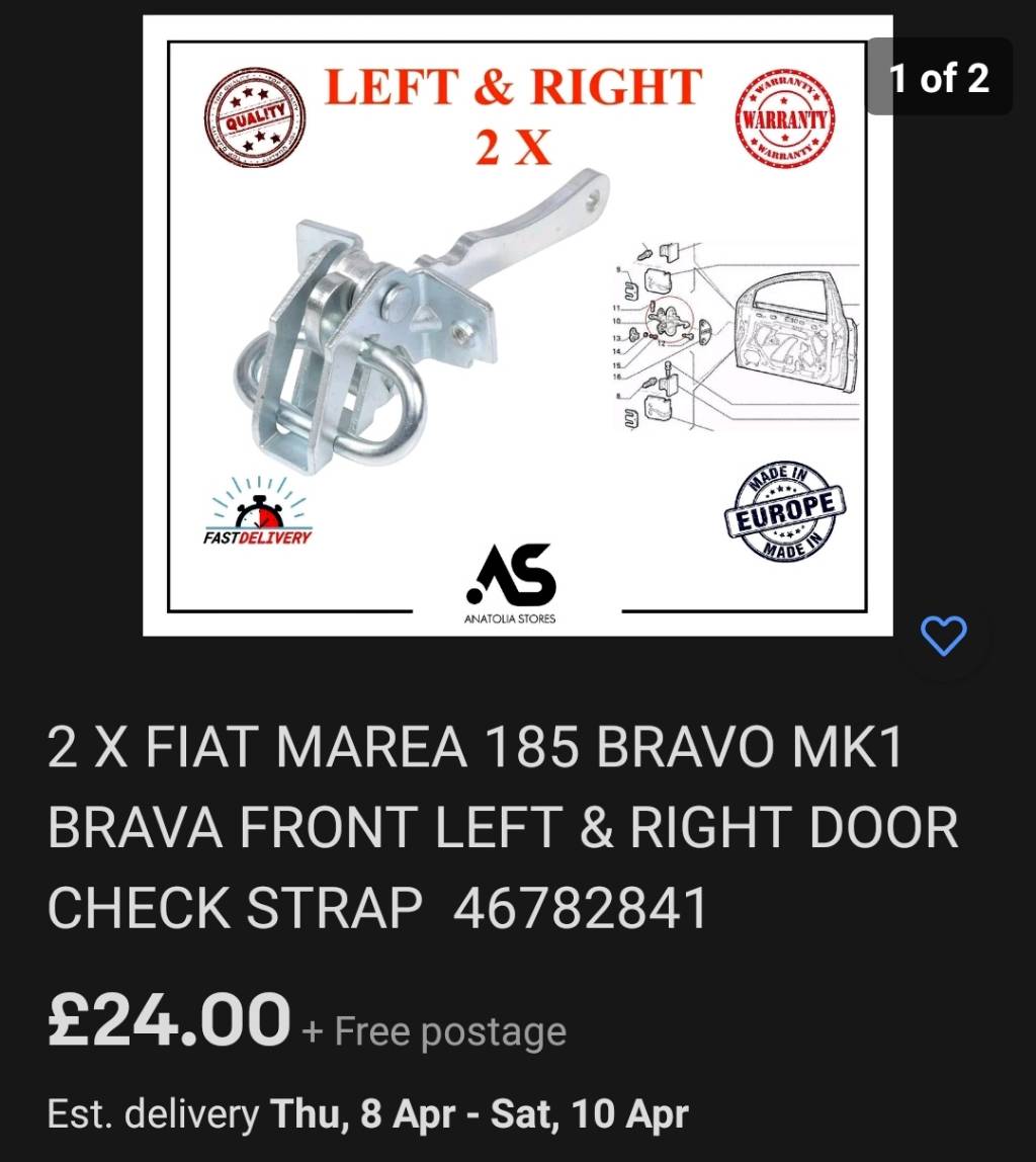

Why dont you simply replace the checkstraps ????
They are readily avaliable and very cheap Screenshot_20210401-105555_eBay.jpeg
Yes as said above, check straps, are available around, and easy enough to replace, you will just need to take off your door card, to get inside your door to remove the 2 bolts holding your door check-strap
The only tools you should need are a trim removal tool, Philips screwdrivers, Allen or hex keys, and ten or eight sockets and a small ratchet depends on the model car.
Just be careful pulling off the door card, that you don't break all the plastic clips
